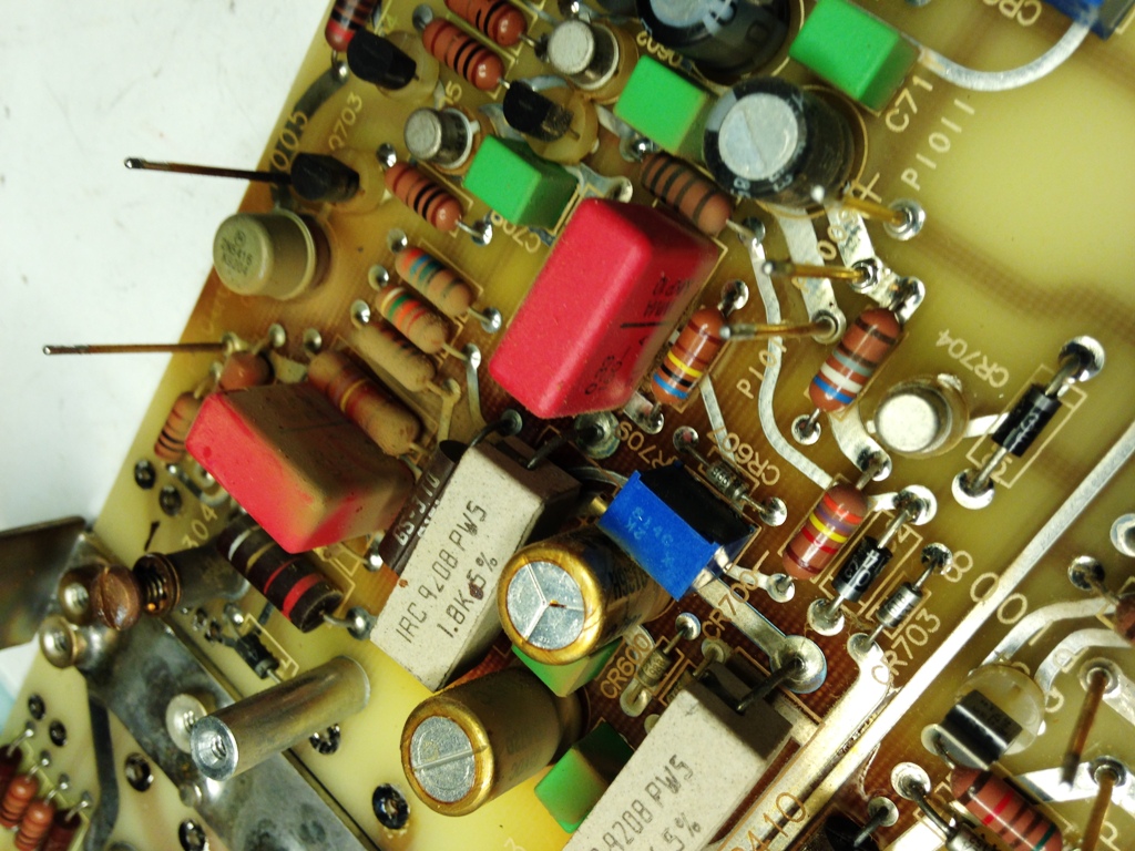

Simon, here are pictures of the famous hi-end amplifier. 5W resistors are in series with Zeners, can you imagine better place for Al caps (Zener shunts)?Never saw this before. A resistor used in a power supply feeding a zener diode.

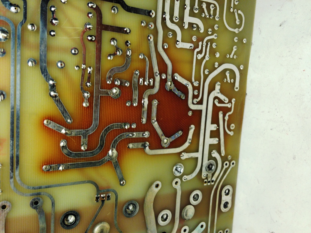

Such design practice is (was) common on a huge range of commercial gear such as TV's of the 80's and 90's.
Sony used to have an issue with a chassis that used a couple of high wattage metal oxide resistors in the power supply. They ran that hot they used to physically unsolder themselves. Special high melting point solder was issued for 'repair' 😀
Maybe unfair to single that (Sony) as an example but what you show in the picture is pretty mild in the scheme of poor design and components generating excess heat.
