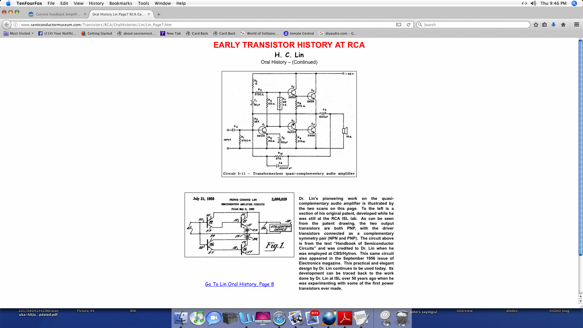

For historical reference, here is one of the first examples of effective solid state design. You might call it the Great-great grandfather of solid state amps. Kudos to Dr. Lin. I will follow his work further, (for myself). He was a true pioneer.

That reminds me of the first amp I ever built from a kit. AD149 outputs and 2N3702/4 for the others. Also remember it having 1 ohm emitter resistors.
I still remember the excitement of finally getting it to work, first on one channel and then the other. There were some mishaps on the way and a lot of learning in a short space of time. It sounded fantastic too.

It is similar to the first power amp that I built when was a kid in 5'Th grade. I copied the schematic from Soviet record player Accord. I organized a rock group in my school then, and we needed an amplifier. :)
The main problem was, to find a NPN transistor!

NPN Germaniums were quite rare in the mid 1950's. You probably had to work as a semi company to have access. Notice the output was quasi complimentary since high power Germaniums may not have existed then.
There are some really premium amplifiers using quasi-complimentary circuits today. They have pretty symmetrical behavior on the outputs which is not guaranteed on complimentary transistors (unless the NPN is degraded).
Dr. Lin mentions this in his oral commentary. However, there is a part # on the 1956 schematic. In 1952, however, he had to be an 'insider' to get such a part, I suspect.
I don't have any real problem with complementary bipolar devices, especially if they are voltage driven. However, power mosfets are a real problem and the N channel probably should be degenerated somewhat to more closely match the P channel complement. This is not much of a problem with Toshiba complementary jfets and their replacements, because they change the die area to match the Gm almost perfectly. Of course, then you have Cin differences, but in complementary differential service the C non-linearities tend to partially cancel between the N and the P devices.

The output is a 2N158 17 Watts! 2A/60V. I can't find mine. Copper case with a 1/4-20 tap in the top, only a bit bigger than a TO-5 mostly taller.
Demian you are showing your youth! But surely you remember the 2N170 NPN germanium RF transistor?
