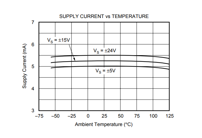

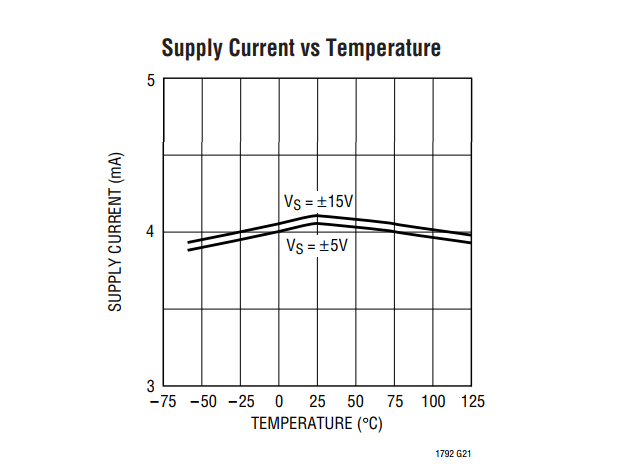

This is what I found in datasheets on idle current stability (LT1792 & OPA604 respectively).
Patrick

It is called Analysing obvious things like all over the map idle current of output transistors and all technological dirty currents from opamp to bases of transistors in addition to currents through output transistors. It is obvious, John!

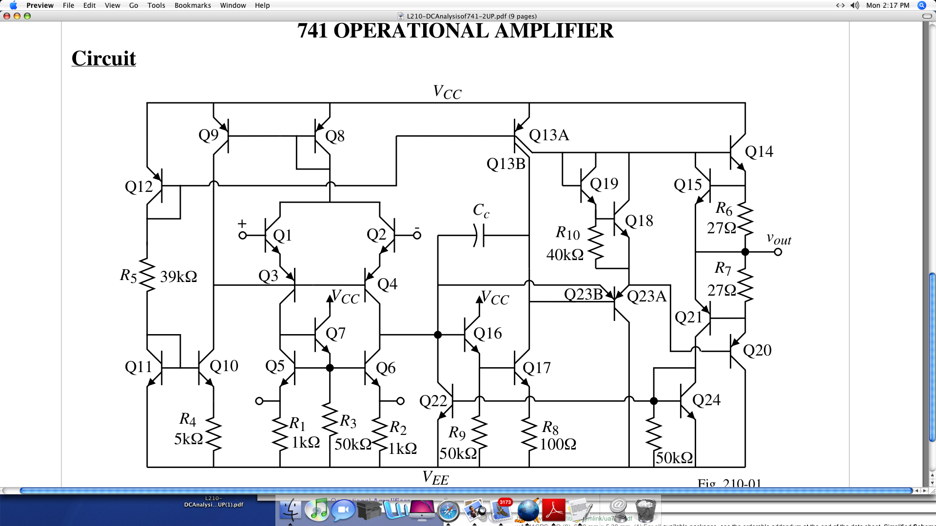

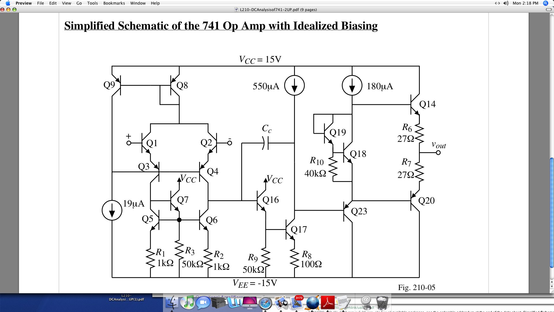

Everyone, let us presume that Wavebourn has found something important about IC's. Let's then look at a schematic of a typical IC op amp, in fact the very IC that my amp design was first used in. I have put up both the exact (hopefully) and the simplified schematic of the uA741, one of the most successful amp topologies in history, and the most studied IC op amp topology (in general) at university. Certainly it was when I attended class. Now let us look for 'technological dirty currents' from the op amp. Can you find any? All that I see is current sources or average summed loads, except for the output stage. What about the rest of you. See anything that I missed?
Yes, not much in 741, still common mode currents in LTP and differential in VAS. In the opamp they are there to make transfer function from input to output cleaner by contaminating rails. Not vice verse.

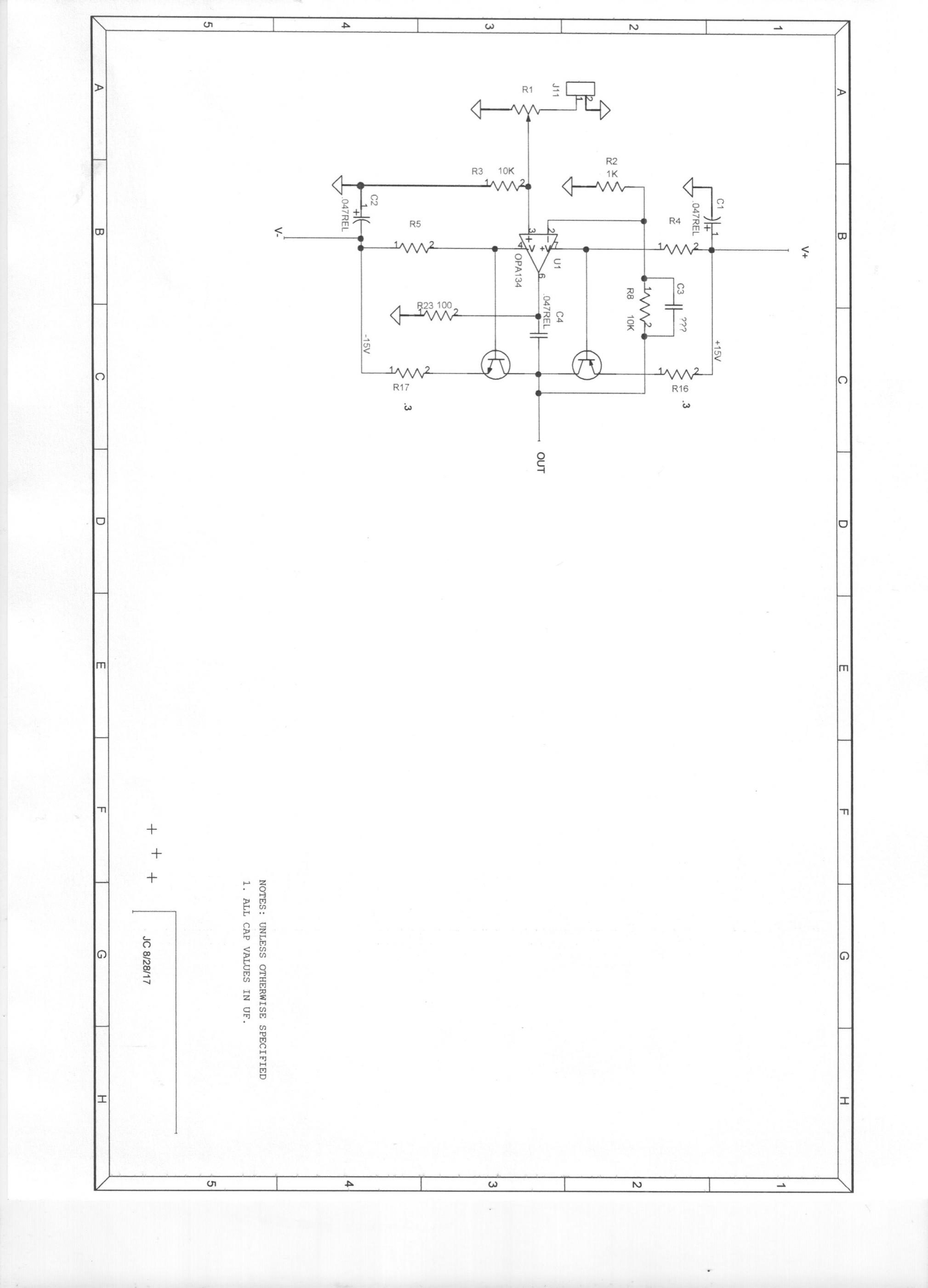

No, I did not design the uA741, but I came close. When you were still a kid, (1966) I was in charge of analyzing the uA709, and when you were a little older (1969) I was designing uA741's into video servos at Ampex Research. Within a year later, I had made this simple little circuit using the uA741 and a couple of plastic T0-220 power transistors for a road trip, driving a PA monitor composed of a JBL D130F woofer and an 075 tweeter (as I recall) driven by a Nagra recorder and protection mastering tape recordings that my company (Alembic) had made recently. I ran it off the bus (we were camped out in) battery, and it worked pretty darn well. Later, I took the same amp, and added a +/- 15V supply and drove a K-horn in my home system. I guess I must be deaf, because while not perfect, it sounded OK.
This is not a perfect design, just a simple, fairly elegant one, instead. It will not work at very high voltage easily, partially because it has no thermal compensation, but IF you can stand to operate with an Iq of 200-500ma, it works great, and is much faster than the IC's slew limit, and smooth sounding.
The earlier circuit (cheap power amp) that I originally put up adds bias setting resistors that can lower the Iq to anything you want, but I never could get it to sound nearly as good as it was in the Class A mode. Too much Xover distortion, probably.

As I suggested before, it can be thermal compensated by using current mirrors instead of loading on naked bases. You can run them in class A then, but now under control. Current mirror ratios also would define currents when output is shorted, if opamps have output current limiting.
Such inputs were common in PA amplifiers before class D took over. And for higher swing opamps were connected through Zeners in series.

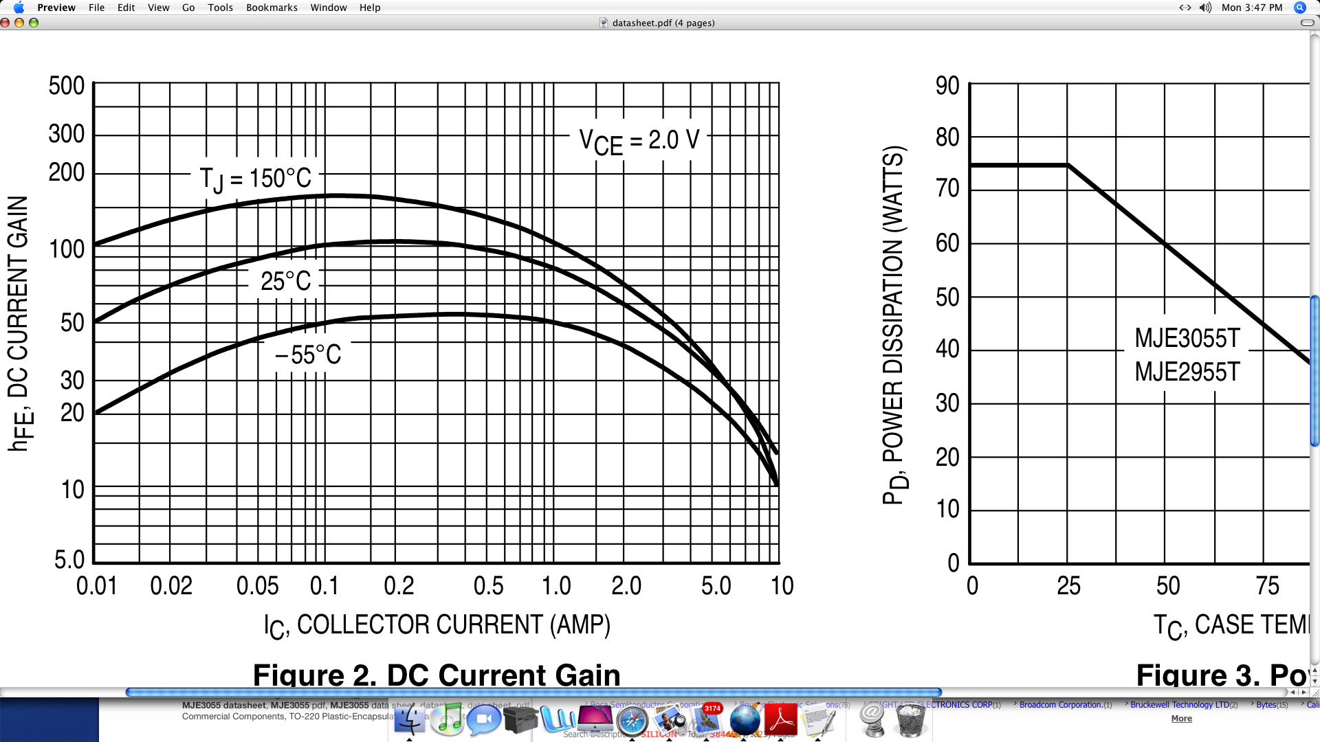

Another factor that keeps the current driven output devices from getting out of hand is the way the beta changes with temperature. Above a certain current (Iq) higher temperature tends to push the beta change closer to the 25 degree C rating. For example:
