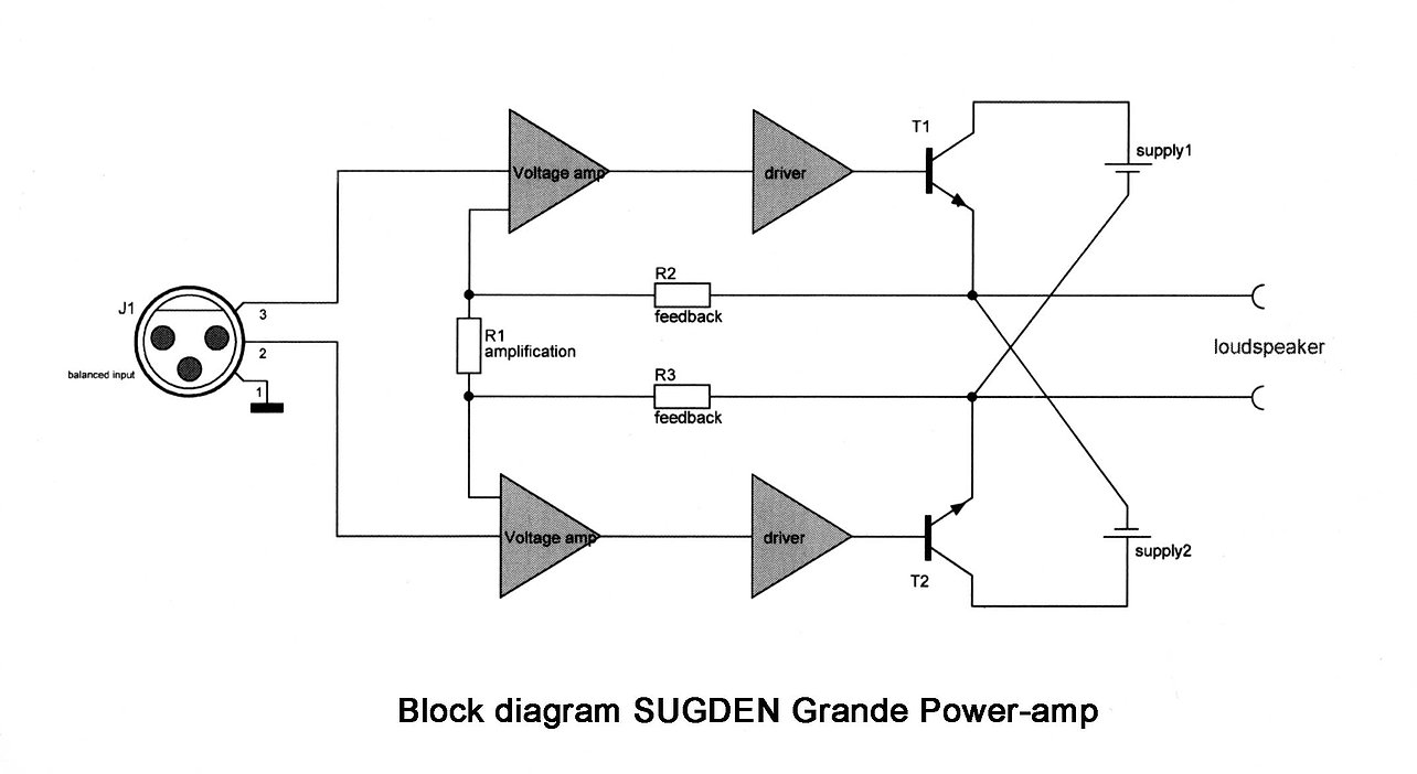

Sudgen balanced bridge power amps (2017)

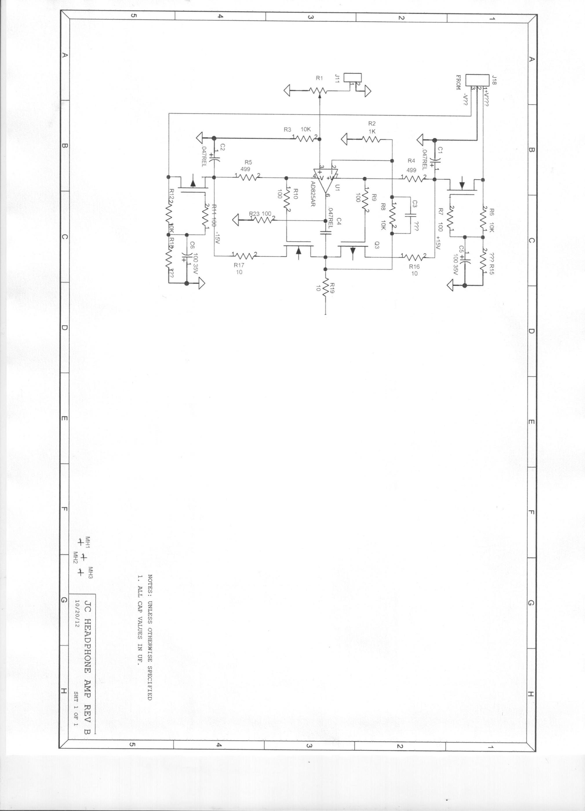

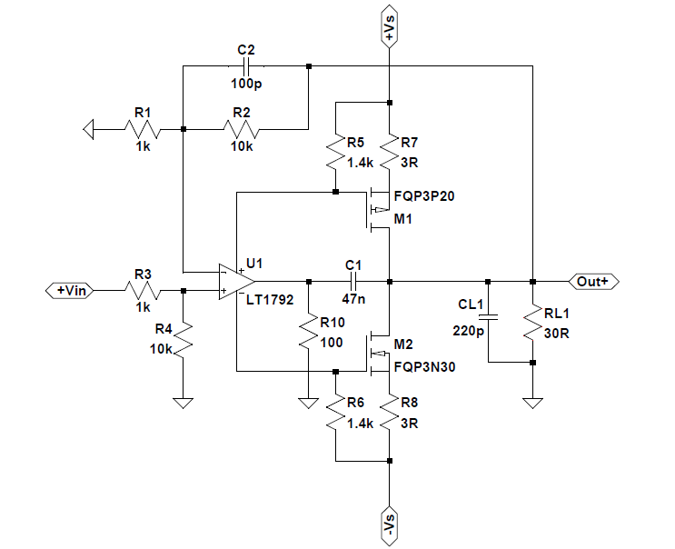

How about an even simpler power amp that is self current limiting, fast, and can sound really good?
John,
Opamps are usually 4~8mA bias, and hfe of audio power BJTs 100~150.
So the output stage would have ~700mA bias.
And difficult to change (e.g. to 100mA for a headphone amp.)
But why not use MOSFETs and a resistor to bias ?
That way you can choose the bias as you want, instead of what you can get.
Attached schematics is meant for headphone.
Patrick

Of course, with that simple topology of a single IC and 2 complementary power output devices, you can use power fets instead. It is slightly more complex and not as obviously current limiting, but it could be a good design. You can also increase the voltage swing by adding a couple of Zener diodes between the IC and the output devices.
However, the simplest form of this design actually sounds pretty darn good, so long as you let it run Class A, 250-500ma typically. That is how I ran it for years.
It would be interesting to SIM this design, and also Wavebourn's design, looking for higher order distortion, etc.
