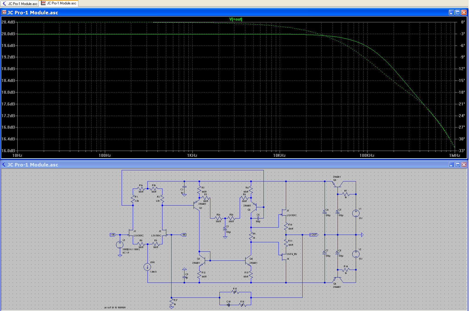

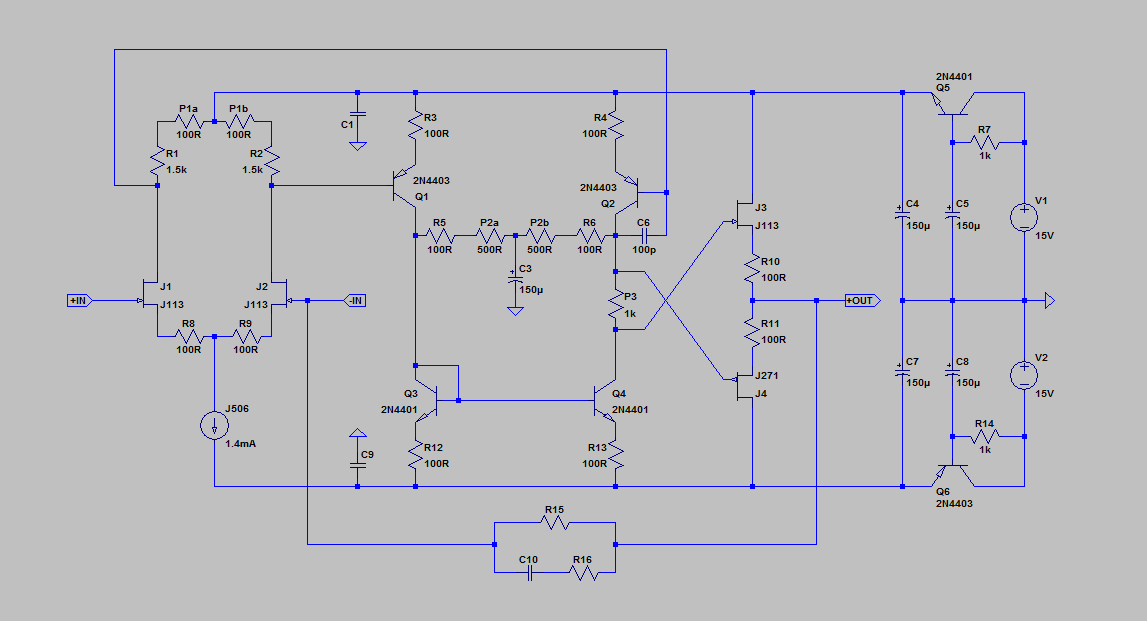

Sorry folks for the look of the schematic. It was first drawn up almost 40 years ago by my Swiss Technician, and the clean copies were destroyed in a firestorm about 25 years ago.
I took the liberty to redraw in LT Spice.
Hope I did not make any mistakes. Please let me know if you spot any,
Not certain about a few components :
J1, J3 J113 ?
Q1, Q2 2N4403 ?
Q3, Q4 2N4401 ?
C1, C9 100n ?
R15 ?
R16 ?
C10 ?
Patrick
  • JC Pro-1 Module.asc
    JC Pro-1 Module.asc

JCX, I was just talking to Walt Jung today by phone. We have few if any intellectual differences between us about op amps. Who do you think first recommended the AD825 to me, Scott? NO! It was Walt. He recommended it to me because it has a 20KHz open loop bandwidth, and it sounds good. Scott just supplied me with samples of the AD825. Who turned me on to Barrie Gilbert's article on PIM? Walt, once again. And so it goes!
PIM is going to be more and more important when we finally get better, and easier to use test equipment to measure it. It might not be the only answer to audio electronics fidelity, but it is certainly worth minimizing. As time goes on, we will probably find other things, but I will stick with what sounds good, and appears to be circuits with high open loop bandwidth, good slew rate, and open loop 'stable', as well as low distortion. For the record, the circuit that I put up is 40 years old! It can be bettered, but only if the fundamental properties of the design are kept. High feedback is not the right direction to go, in my experience.

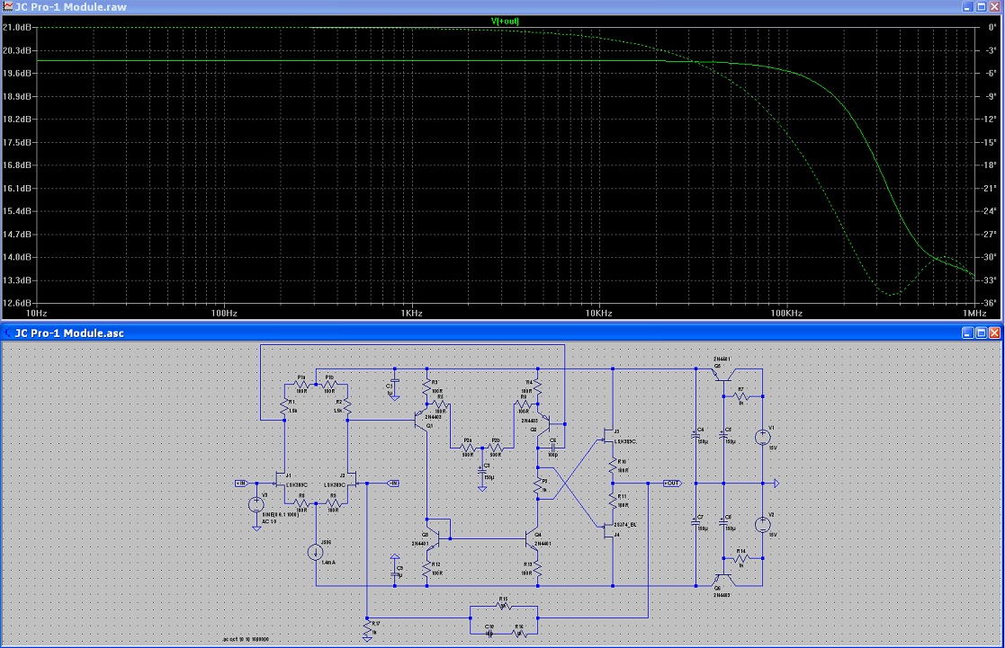

Here slightly modified, self-contained Spice files for FFT and for Frequency response.
I changed P3 to 500R so that bias is at ~8mA with no degradation on THD.
And R16 to 100R to reduce the small local peak at ~ 15MHz.
Using Toshiba JFETs (2SK170/2SJ74).
As you said, not optimised.
And probably would be equally good with only 2SK209s (with all NJFET at the output instead of complementary)
Hope John would not mind us messing with his brain child.
Patrick
