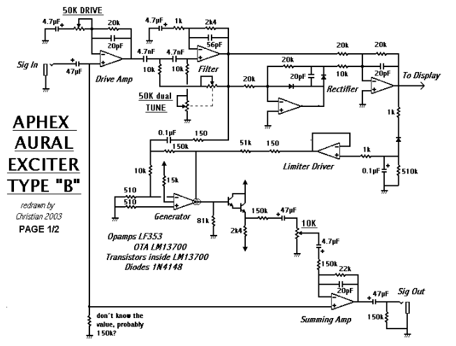

One thing I know about Fremer is that he is partial to Aural Exciter.
Cool, I wonder how you could get all this into an 8-legs.
used to enhance a signal by dynamic equalization, phase manipulation, harmonic synthesis of (usually) high frequency signals, and through the addition of subtle harmonic distortion. Dynamic equalization involves variation of the equalizer characteristics in the time domain as a function of the input. Due to the varying nature, noise is reduced compared to static equalizers. Harmonic synthesis involves the creation of higher order harmonics from the fundamental frequency signals present in the recording. As noise is usually more prevalent at higher frequencies, the harmonics are derived from a purer frequency band resulting in clearer highs. Exciters are also used to synthesize harmonics of low frequency signals to simulate deep bass in smaller speakers.
Should be a snap !
