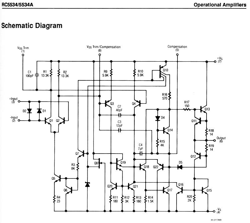

OK, what makes an exceptional audio circuit? In my experience, making circuits as OPEN LOOP linear as possible is a first step. This means Class A operation from input to output, balanced push-pull operation where practical, and even using j-fets instead of bipolar devices to reduce the higher order distortion of the gain cell. In my opinion, it is not the total distortion that is very important, but the amount of higher order distortion, both AM and FM that might be generated, especially with an added feedback loop.
Higher open loop bandwidth is also important, and this limits the DC gain of the op amp, and usually disqualifies active loads on the input stage. Of course, gain-bandwidth has to be as high as practical, in order to increase the open loop bandwidth to its maximum, and still have some extra gain to use as feedback.
If you look carefully, you will find that compared to the 5534, for example, (the contender at the time to replace this discrete circuit board), you will find what I would call, one and 1/2 LESS stages in the discrete op amp. The output doesn't need a Darlington or its equivalent to be linear enough, which eliminates 1/2 stage (by my count) and the single ended driver is also omitted, and what do you know, the overall discrete circuit has a higher slew-rate than the 5534 and probably most of the competing op amps today, 40 years later.
The built in cap multipliers isolate each gain block from any others, both L and R and from any power supply transients. I add this or its fet equivalent to virtually all of my designs, even those that are IC based.
This design needs updating to be practical today, perhaps an all fet version.
Here are two schematics to compare to:

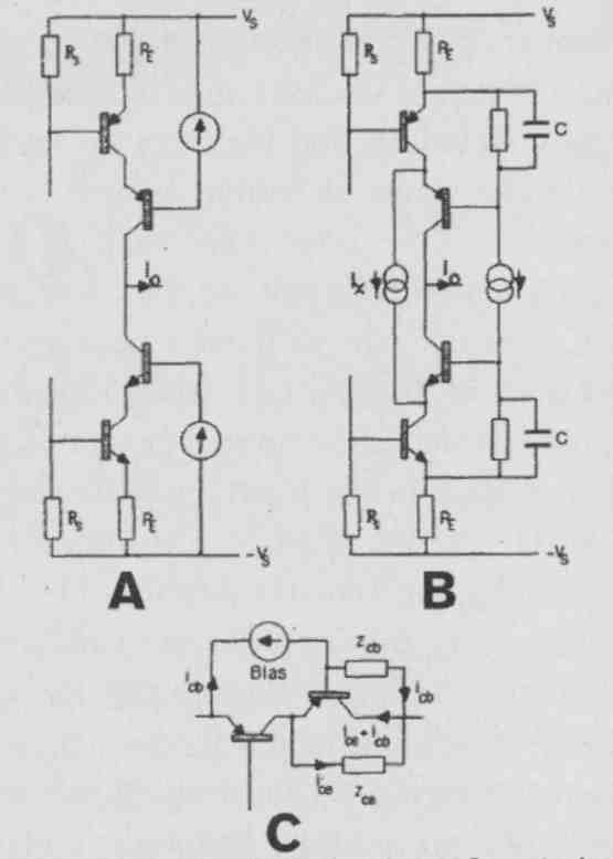

If the second stage was cascoded and the cascode base current returned to the emitter of the lower device then it would be 1988 and and Malcolm Hawksford all over again, can anyone say ground hog day?

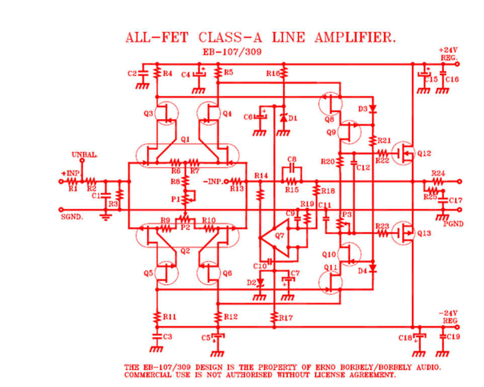

Here is an all jfet version by Borbely, ouput devices can be jfets, 216/79 mosfets, or 162/1058 depending on whether you want a small class A power amp, preamp, or buffer.
Chris, I live just south of Georgetown, and am using all Borbely jfet gain stages for phono, line stage, dac, and power amp.
