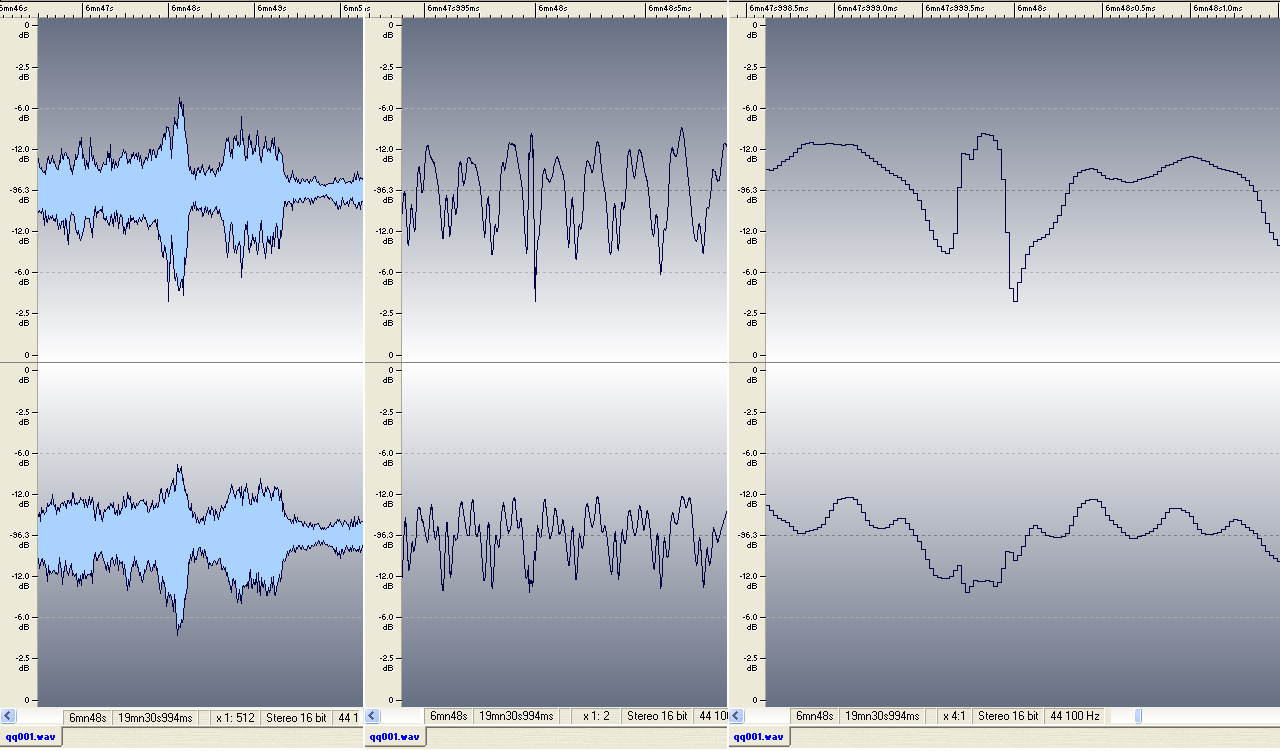

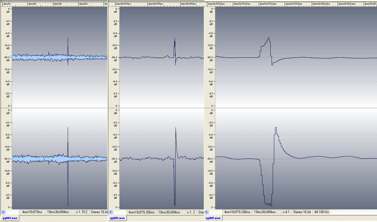

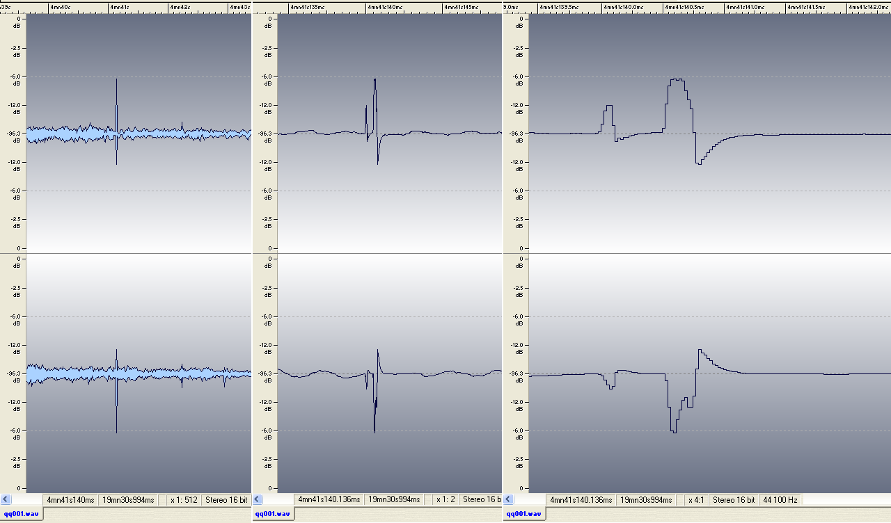

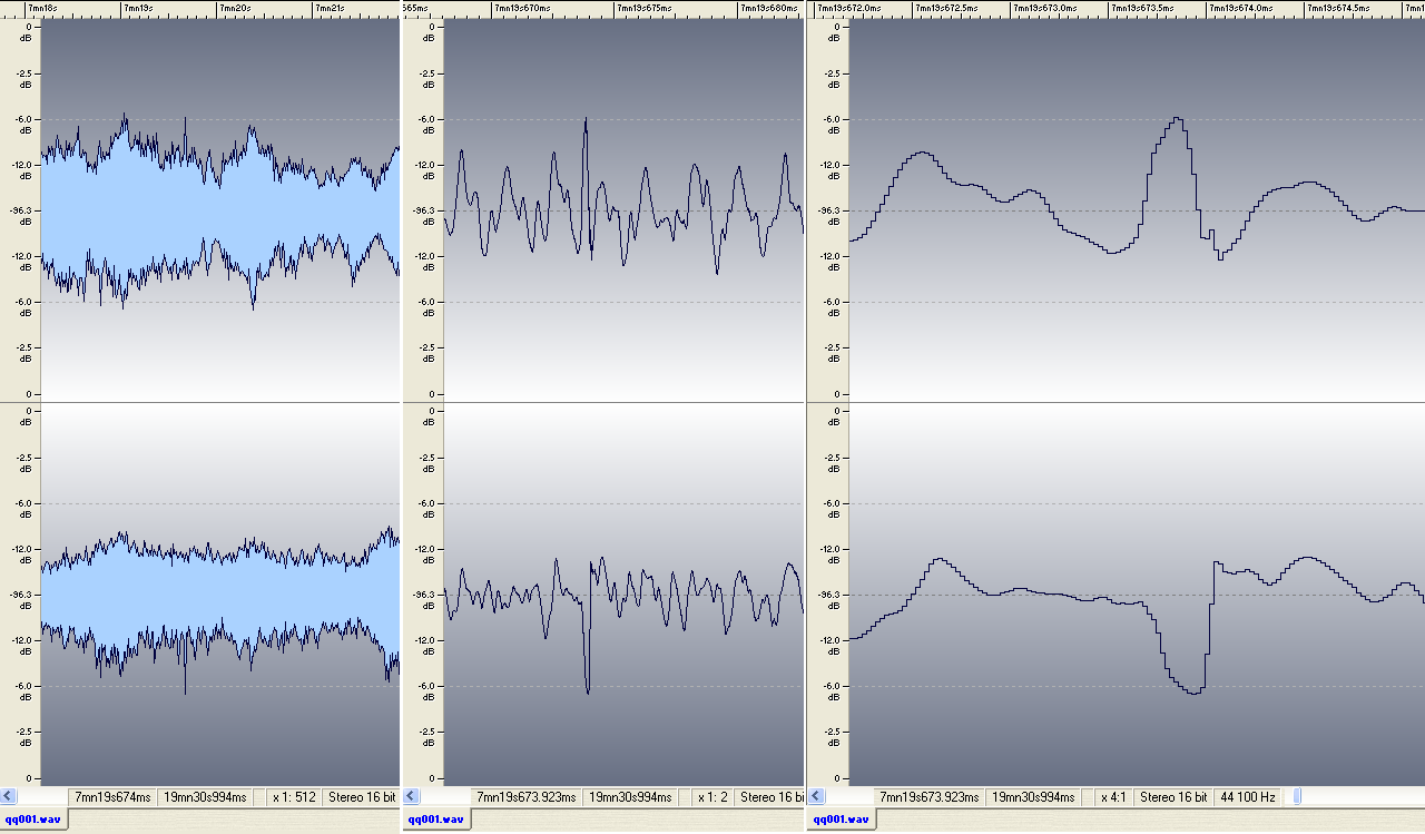

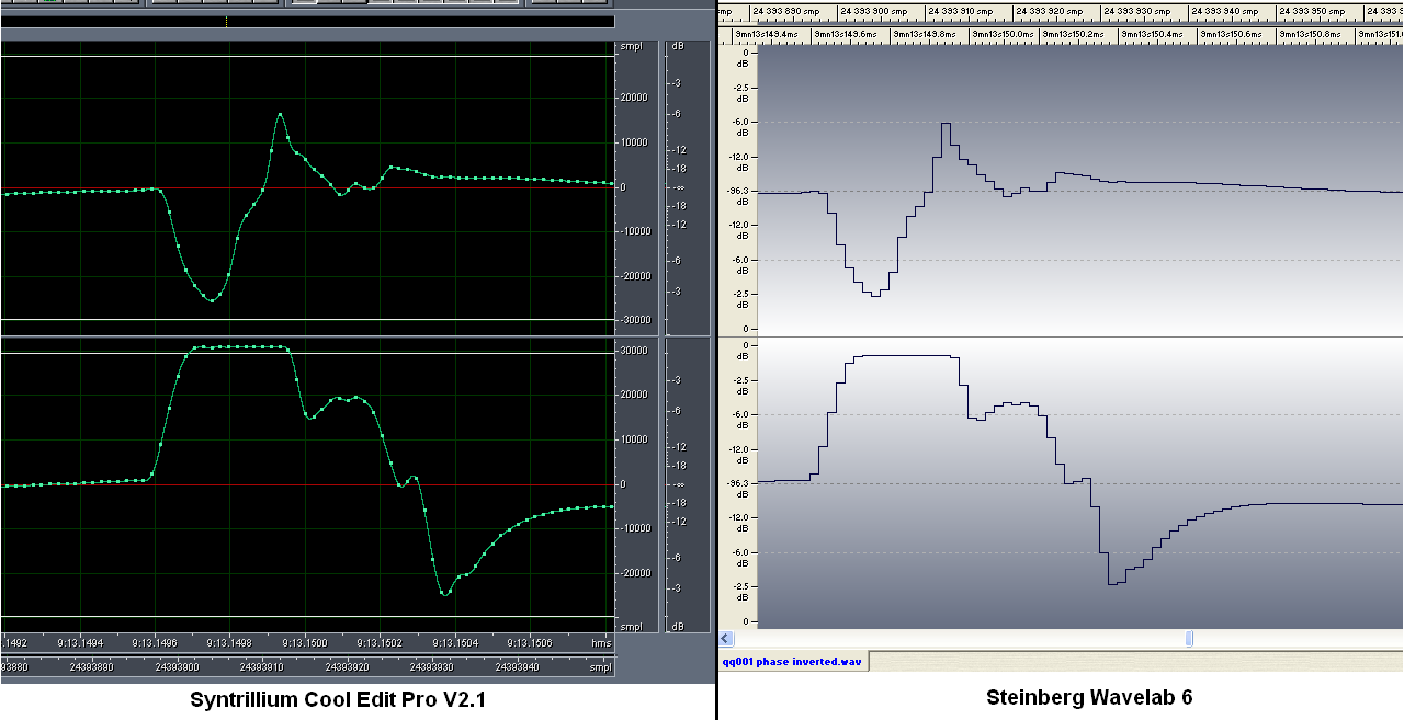

I was looking at some of my vinyl rips and I found a waveform very similar to Scott’s, see attachment 1. You will see the analog-like representation from “Cool Edit” and the actual staircase form from “Wavelab”
Recording was made at the RIAA pre output 0dB=1.286Vrms

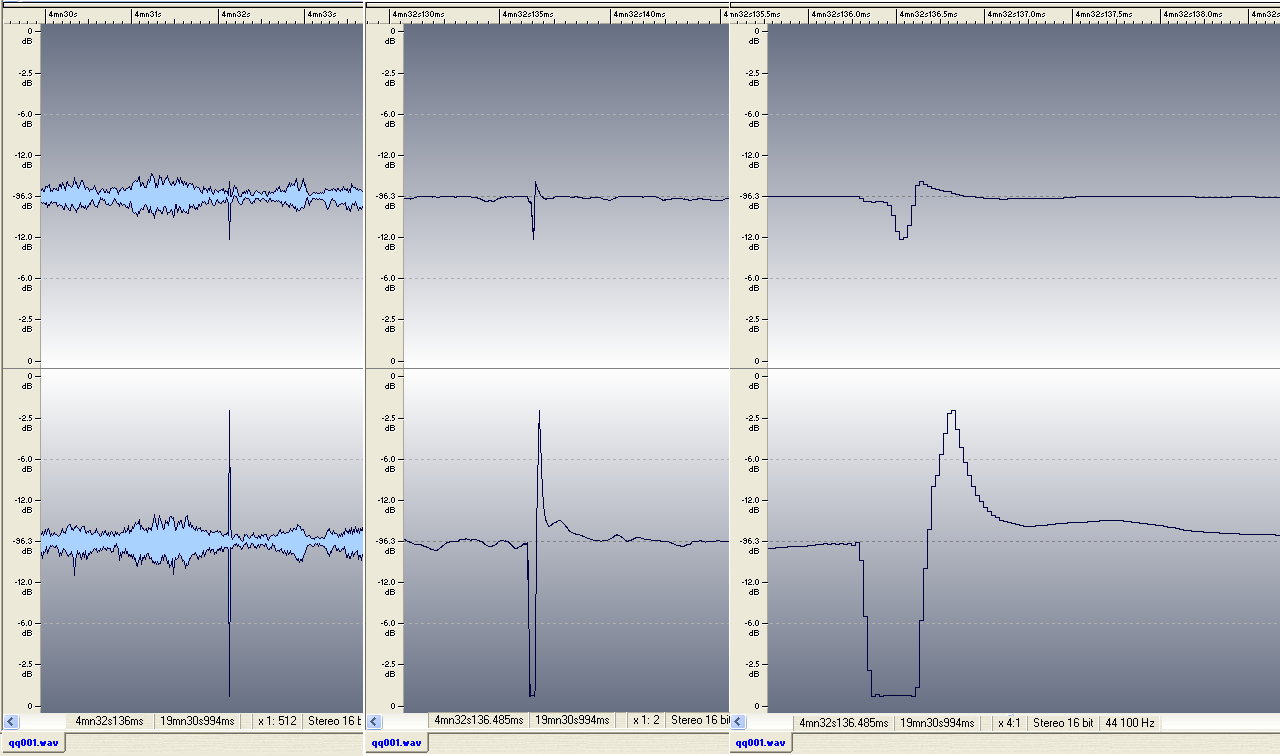

I practice there is about 30 dB of attenuation re 1,000 hertz for the scratches, the last time I looked at that almost 40 years ago.
Hi Ed
From the exponential recovery seen on attachment 1, I deduced the low pass filter time constant.
It is 170ns implying a cut-off freq of around 1kHz. Tomorrow I will try to make some flat recordings from this vinyl record for to compare the waveforms.
In the digital signal processing, the give away of the signal that is caused by dirt or a scratch is the fall time. Musical notes decay, impulse noise falls off without decay.
Impulse noise experiences decay as well, due to cartridge mechanical/magnetic LP filtering and the LP filtering from the interface and any filtering in the preamplifier.
Musical instrument notes have their own longer acoustic time delay added.
So, attack and release profile, phase relation and amplitude, all these are the give away for dirt/scratch/static discharge signals. (see attachments 2 to 7) 🙂

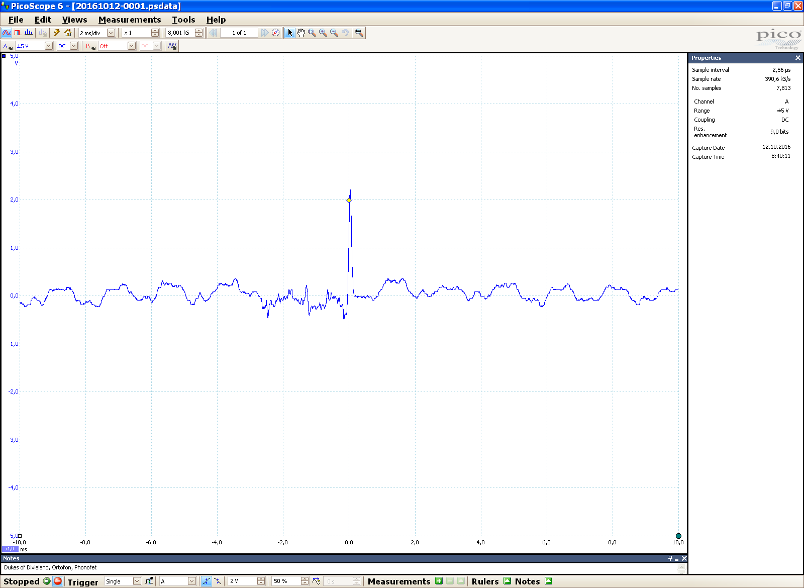

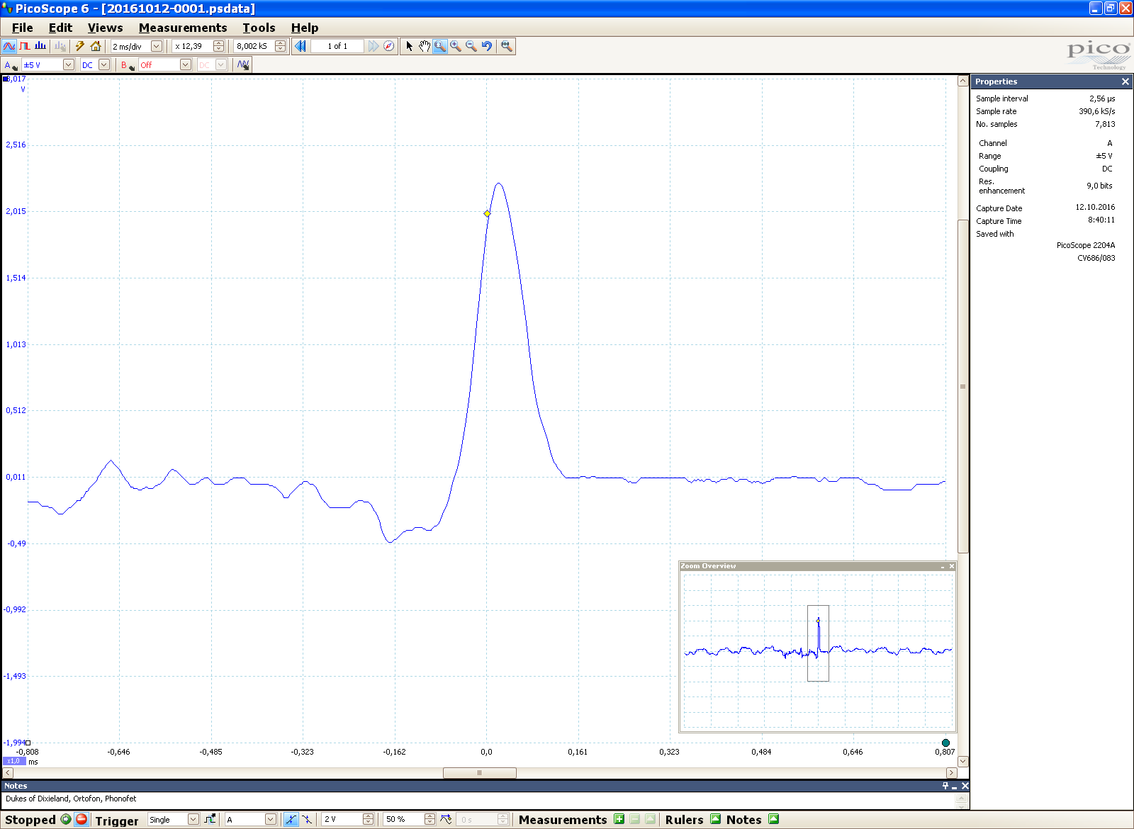

George,
I have repeated my measurements of clicks, for the reason I have much more suitable equipment for captures now. It was measured with Ortofon 2M red cartridge and with this phono preamplifier:
Discrete preamplifier for MM cartridge
I could not find any clipping, just big spikes all in amplifier linear range.
Attached are measurements, png images completely show all measurement settings, so I hope no additional explanations on sample rate etc. would be needed.
George
Of course the staircase doesn't actually exist. It's just the representation on the screen. In reality only the samples are defined, and if you DA convert, it turns into a continuous wave.
This is important to mention because newbies look at this and say, see, I can actually hear the staircase. No. There is no staircase except on the screen.
Jan

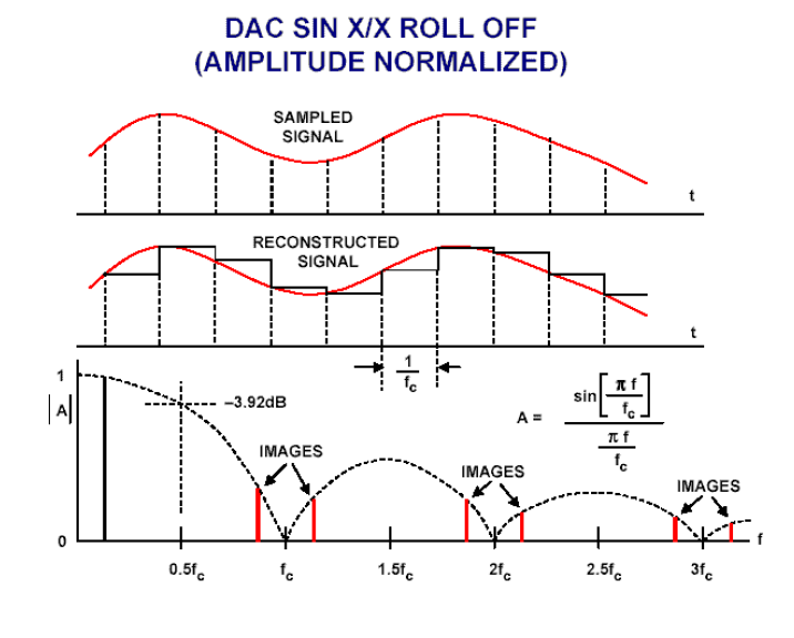

Yes Jan, in majority cases when there is a reconstruction and LP filter in the DAC. If not, like in the old days of TDA, DAC output keeps the last analog output voltage before new sample comes and you can see the staircase on scope screen. It affects spectrum and amplitude response as well.
