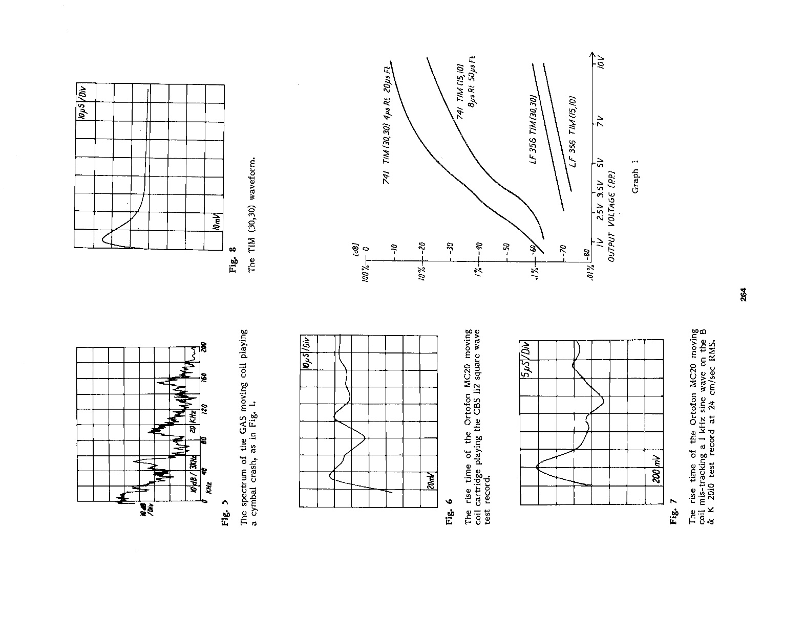

PMA, I'm sure that your measurements of the phono cartridge are OK, but this is a low end typical case, not reasonable worst case. Incidentally, the real problem, besides clicks and pops is cartridge mistracking. It is in no way as slow as what you measured: See my examples measured with analog hi speed test equipment almost 40 years ago. MY rise-time peak is 5us! (figure 7) This closely corresponds to a (TIM 30) test signal, differentiated with an inverse RIAA network or TIM(30,30) (see figure 8). Precise measurements of a phono cartridge with a 13.5KHz passive resonance and the highest tip mass that Ortofon makes is not necessarily the best representative for determinining reasonable worst case design limits.
Thank you John for your input. I have your paper with the images that you have posted now. You are right that my measurement does not cover the worst case, however, I am sure that even the signal with the rise time you had measured is a non-issue for current well designed phono preamps. It may bring more troubles to the power amp (input overload) and especially to speakers, because of the amplitude of clicks and mistracking impulses.
I agree that many modern phono stages are OK. However, I worry about the people here who don't take it very seriously.

Gpagag, cartridge mistracking can happen to virtually every phono cartridge, and some of the best sounding phono cartridges are not immune to cartridge mistracking. Look at the Ortofon MC-20 moving coil cartridge mistracking at 1KHz at the level of 24cm/sec RMS. This IS a high level, but not an impossible level, especially with direct disc recording, that is often the reference standard for vinyl reproduction. For example, figure 5 shows where another quality MC cartridge mis-tracked with a cymbal crash of a direct disc record, as did virtually EVERY MC cartridge that I tested. We have to design for this, IF we want to make a truly quality phono stage, (at any price point).
What I found in my early work from 1978, is that you HAVE to pass TIM (30,30) which is a TIM 30 waveform followed by a passive inverse RIAA that makes the really difficult signal shown in figure 8. Do it or be mid-fi. It is not impossible, but it is easily ignorable by many here, if they don't realize it to be important. .
We agree. I haven’t objected to this.
With only one remark: Trackability is not an attribute of the cartridge alone.
Trackability depends on the cartridge and the arm as a system.
What cartridge, on which arm and how well installed and adjusted.
Trackability is not a given based on component brand/model or price.
Here is my disagreement.
You consider a signal from a mistracking cartridge as a design pass-fail criterion. I find it both wrong and not useful.
Aim for faithfully reproducing a signal from a cartridge which reads that 1kHz @24cm/sec RMS, or whatever but without mistracking.
No objection to that 🙂

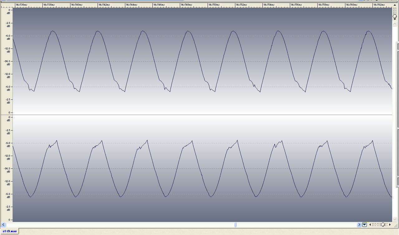

Agree, from your picture above it seems your pre-amp didn't behave badly. Just what else should it do?

Richard, to see the spectrum of a mistracking MC cartridge, just look at fig.5 of the paper I did for the IEEE, so many years ago. Note: it is 20K/div with 10 divisions. Yes, up to 200KHz is typical, I have seen some action at 500KHz with the MC-20 Ortofon cartridge.
wow. that is higher than i imagined. what does That say about SR requirements? Its enough to have the mistracking distortion products without adding even more to it by the preamp.
-RNM
This is mostly boogeyman stuff, the amplitudes are so low at high f that the slew rates are not important, just look at the time domain plots. Again why on earth would you want to accurately reproduce horribly distorted audio?
Wow! So many years, and the thread is still here! 🙂
Still did not figure out that it is better to limit a frequency band before any active components than to fight for a slew rate above the sky? ;-)
