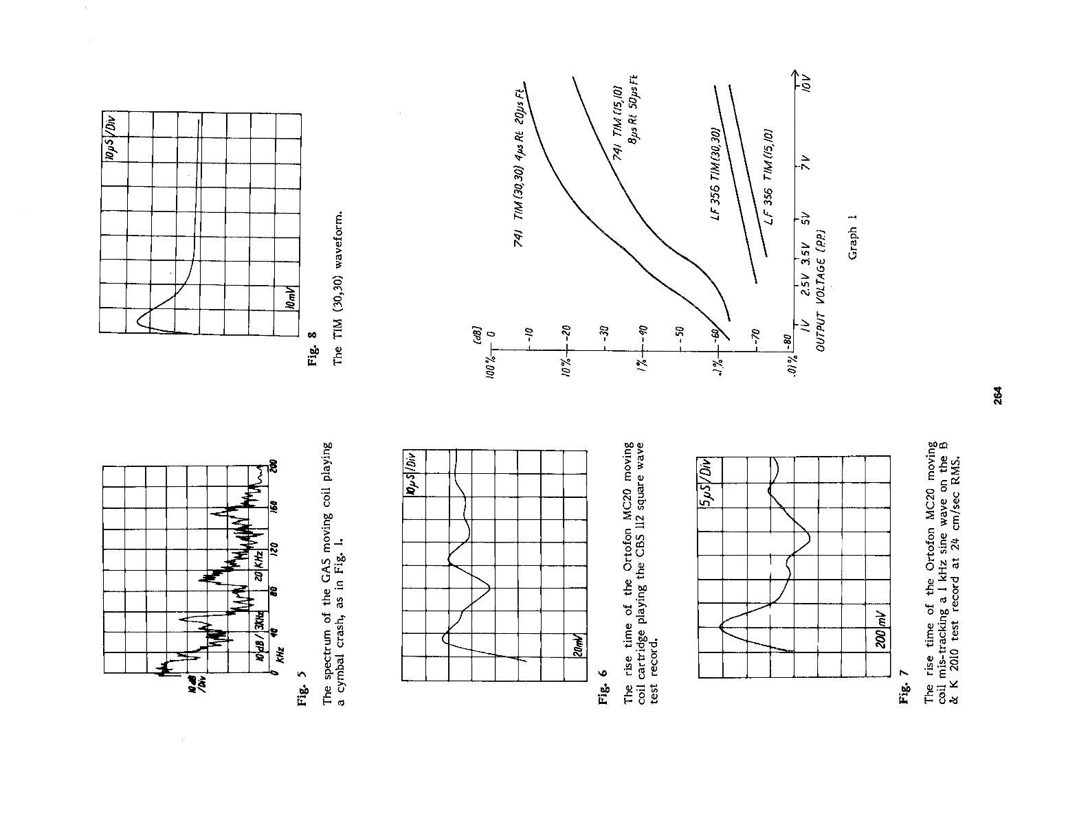

PMA, I'm sure that your measurements of the phono cartridge are OK, but this is a low end typical case, not reasonable worst case. Incidentally, the real problem, besides clicks and pops is cartridge mistracking. It is in no way as slow as what you measured: See my examples measured with analog hi speed test equipment almost 40 years ago. MY rise-time peak is 5us! (figure 7) This closely corresponds to a (TIM 30) test signal, differentiated with an inverse RIAA network or TIM(30,30) (see figure 8). Precise measurements of a phono cartridge with a 13.5KHz passive resonance and the highest tip mass that Ortofon makes is not necessarily the best representative for determinining reasonable worst case design limits.
Ticks and pops are not equalized. At 5 usec even +-15 rails gives at most 6V/usec?
