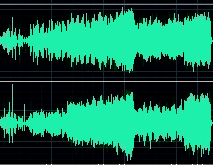

Pano as Ed would say maybe we just are not communicating. Maybe a picture would help. This is a rip from a fairly good DMM German pressing (whole side) with maybe 2 pops in the beginning of the lower (right) channel that went off scale. The rest of the surface noise, small ticks, crackle, etc. are linearly reproduced. The two pops might have gone to 2 or 3X full scale and driven the pre-amp or PA to the rails, I don't see clipping them with <10's of microseconds of recovery hurts the sound. I liken this to the one or two bad samples on a very scratched CD. These are stretched of course but by the simple size of the debris lodged in the groove.

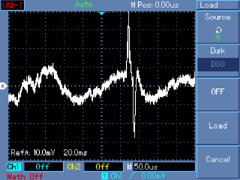

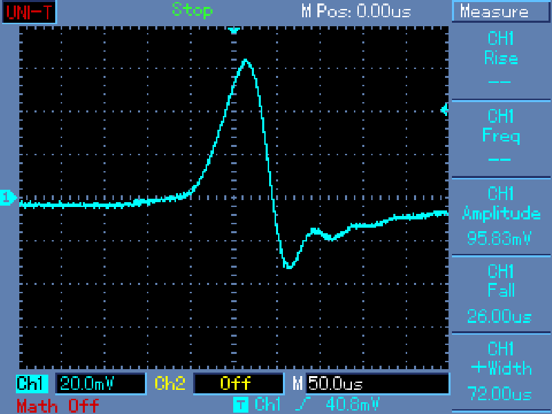

Small reminder, measurements (at least mine) made directly from cartridge output. Cartridge frequency response and resonance is the limiting factor of its output voltage speed. One cannot get infinitely short rise time at the cartridge output.

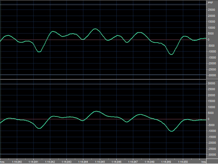

Just for fun this is the pop fixed with the free ClickFix plugin for Audition/CoolEdit. I do think it is cool, notice no thump which virtually all spectraly based tools leave.
Pavel,
I am shocked to learn you cannot move a stylus and cantilever arm instantly! 🙂 Next I'll have to learn you can't get the infinite rise in any real electrical components with inductance, resistance and capacitance!
The fastest rise time cartridges were designed for "CD-4" records. (Compatible Discrete 4 Channel). These quadraphonic recordings required response up to 45,000 hertz.
So of course there is a limit to the slew rate of a record defect. That is why the RIAA curve only gives up to about 30 dB attenuation to the HF noise. (20 db at 20,000 hertz re midband.)
