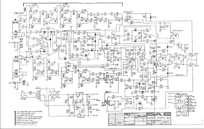

The SAE 5000 that Dejan mentioned was a line level analog processor. It was to be inserted in the chain past the RIAA preamplifier. So it wouldn’t protect the RIAA pre from any scratch induced slew limiting or overloading, although I have yet to see scratch/dirt signals slew limiting RIAA pre amplifiers.
Mis-tracking may slew limit a preamp. Deep scratches or massive dirt may overload a preamplifier.
Shallow scratches or tiny dirt produce very steep waveforms with low amplitude.
Deep scratches or more massive dirt produce less steep waveforms with high amplitude.
I was looking at a recording (made at the RIAA pre output). A deep scratch signal –4.15dB FS (0.796V) amplitude, rise time 167us. A shallow scratch signal –60dB FS (0.0013V) amplitude , rise time 27us
I think the SAE 5000 was an early example of an analog bucket brigade delay in use
6 opamps/channel for 100us delay
(OK. 10 OpAmps & 13 voltage comparators in total inside this unit)
