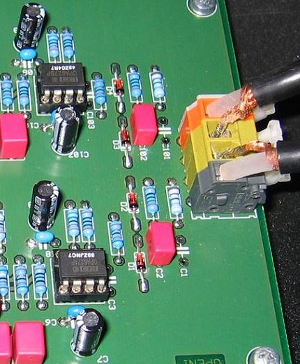

I would not be afraid of short recovery generating the click. It is about energy. Short impulses = small energy.
Does your OPENAMP1 pre riaa input diodes handle this and/or the overload tail afterward ?
Using 1N4148 diodes:
View attachment 1n4148.pdf
Perhaps a perfectly appropriate diode could be chosen ...
Do your OPENAMP1 pre riaa input diodes handle this and/or the overload tail afterward ?
Perhaps a perfectly appropriate diode could be chosen.
