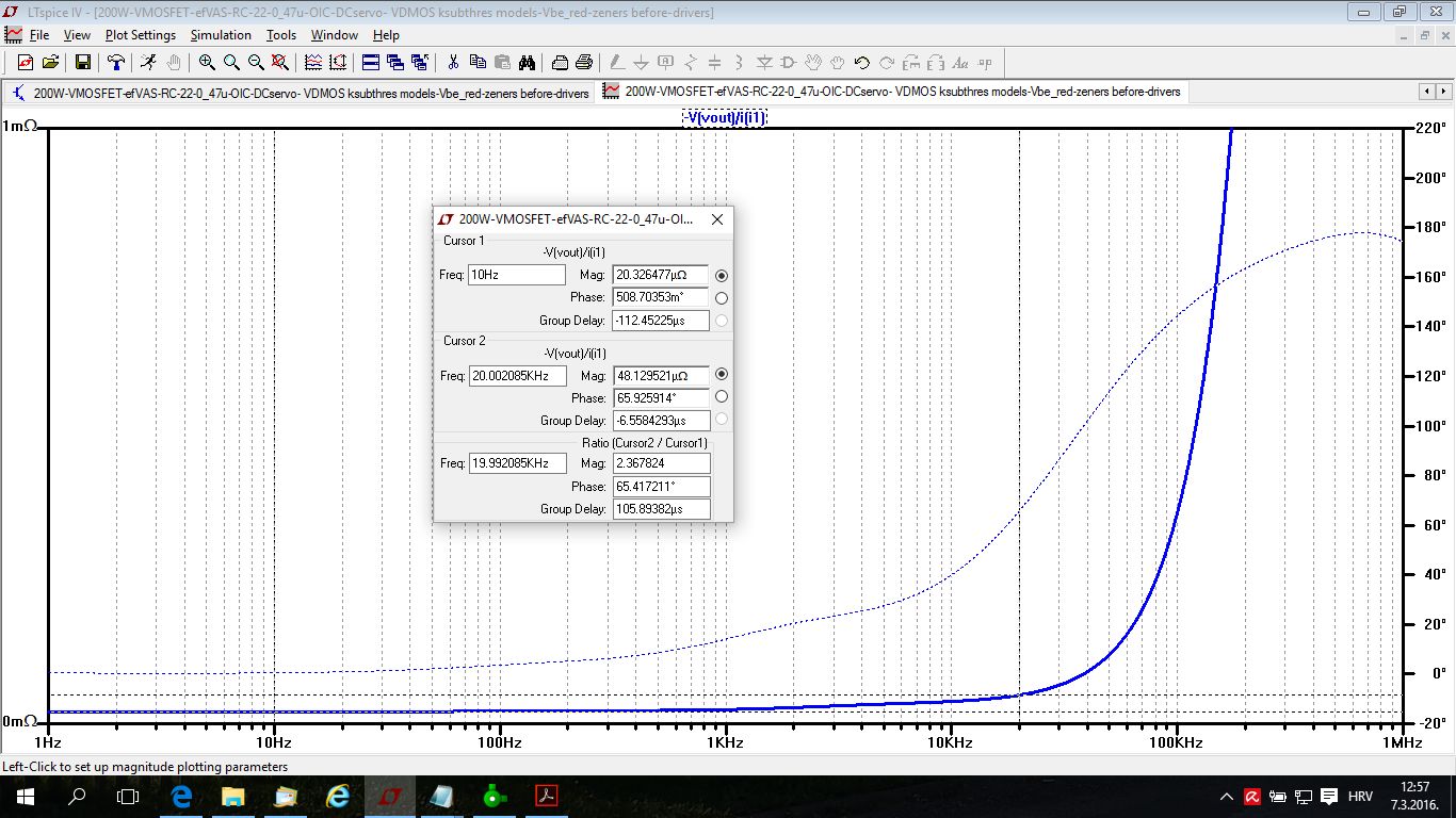

This is simulated output impedance of the 200W CFA.
It is also result of relatively high and flat Loop Gain.

Looks good. It is easier IMO to get wide constant OLG vs freq with CFA.
