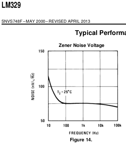

> Watch this low noise LM329 :-(
Indeed .....
I wonder how a TL431 would do at 6.8V in comparison.
BTW what is the test current ?
(13.5V - 6.8V) / 1KOhm
I got them from digi-key, but it looks more like a bandgap,
not a subsurface Zener. The 1/f corner should be at 100 Hz.
regards, Gerhard
