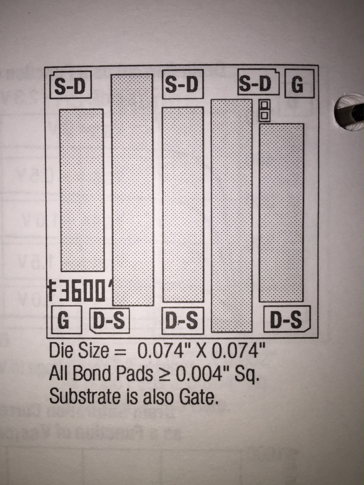

Prob. a single, o/w there would be a symmetrical arrangement of stripes for D-S --- presuming that things are not interdigitated. Scott W. do you concur?
I don't know where I got that notion. I may have been thinking about the THAT Corp. bipolar arrays, which run out of package pins to bring out all of the transistor connections.
Yes that looks like a multi-bond option on a single, the gates are shorted anyway if they are the substrate. Remember the standard dual pinout is mirrored, so these could possibly be plonked down in either rotation and bond up.
Could at least get four amps on that die.
