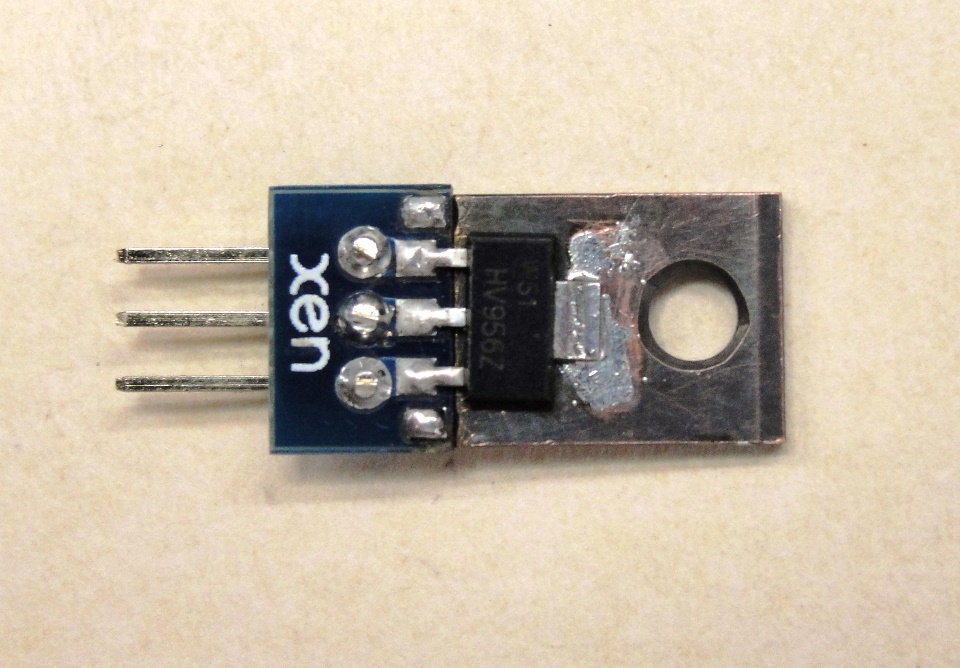

An example of cost-no-issue, for hobby of course.
I wanted to use a high voltage BJT from NXP with excellent specs, but only as SOT223.
Rthjc is quite OK, and I wanted to dissipate more heat than would otherwise be possible with the SMD package.
So I figured out a solution to convert it to TO220.
The difficulty is not in the electrical connection, but mechanical integrity.
After all, the hole assembly has to support the weight of any heat sink one might wish to put on.
Don't ask how much it cost. The backing plate was CNC milled copper.
The 0.8mm PCB was not expensive in comparison.
