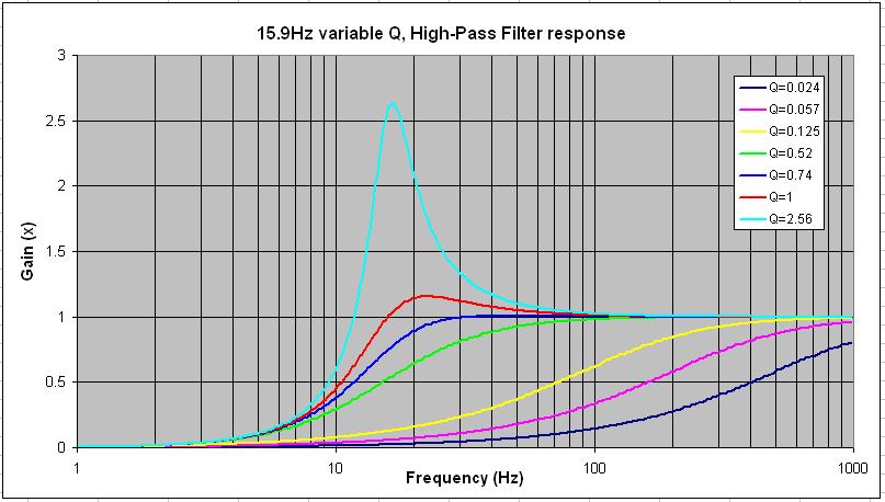

The test signal is a low frequency sweep (it's really a freq response measurement driven by a sine sweep) on the Adjust+ test record.
The test signal sampled at 44.1k/24 but I will redo it at 96k/24 when I get some time.
Thank you Jan.
I thought that it was an FFT based test and I asked for the frequency resolution (FFT size).
You don’t have to do a resampling. It will not change anything.
If the arm would be too heavily damped, wouldn't I see still some resonance of the cartridge?
No. See the attached example from a 15.9Hz filter.
Below a Q= 0.5, you can not be certain where is the resonance frequency of the filter.
There is a separate test for the arm alone, which normally resonates at several 100 Hz. See example of the same arm.
These are the various sub mass systems resonating. Very useful test.

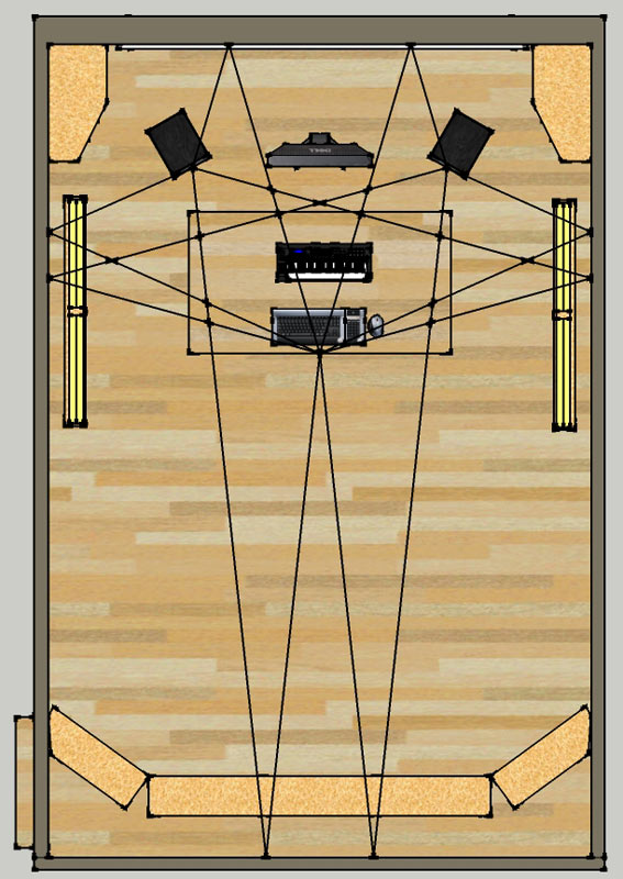

the concept of LEDE is pretty much dead in the pro world as it was originally defined. Control is now the better definition of the design criteria. Much of the information that was learned by designing LEDE rooms is included in todays mindset, but it is expanded to be more informed beyond that.
Thomas Northward has interesting ideas and has designed some interesting rooms, I have had the opportunity to hear two of them and he has designed good working rooms with the physical limitations given. One was in Brooklyn so space is expensive and it is small, but sounded good, a hard job to pull off.
Generally one of the things most designers are looking for today is symmetry in a room, especially in the area where the speakers emanate from. Then, any anomalies or fixes are heard/applied equally to both channels for stereo. More desirable for good spatial reproduction and phase delay symmetry.
Then, which room are you trying to emulate? The recording studio or the Mastering Room, usually very different environments. Many of today's mastering rooms are more like very highly defined listening rooms. Uniform dispersion of reflected sound, good dampening of low end, etc.
Generally one of the things most designers are looking for today is symmetry in a room, especially in the area where the speakers emanate from. ....... More desirable for good spatial reproduction and phase delay symmetry.
Alan
I have been in plenty of studios and few have a lock on perfection. Including the hard to get invited to... Lucus Films studio (name dropping to tweek Waly).
Reduction of early reflections and Near-field are two of the key words in playback. Of course symetry is a requirment... always has been.

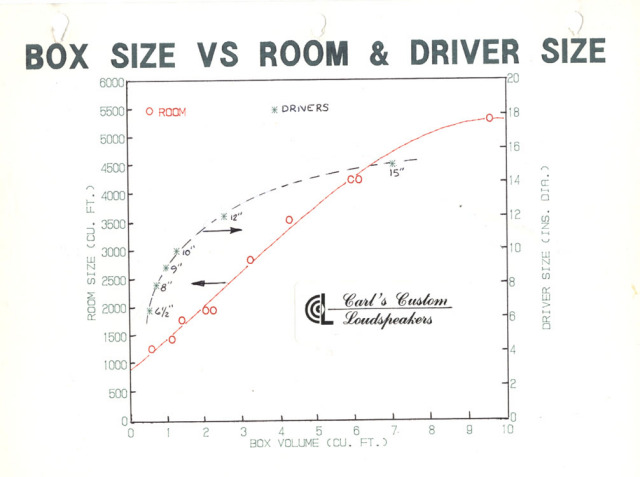

For such a large volume space, I need bass speakers of adequate size et al --- if your listening vol falls within these parameters, this might be useful rough guide.

Dimitri,I was just reading up on you rumble HP filter. Most of my measurements show a 0.55Hz speed modulation from the record eccentricity and/or the spindle being too small diameter. I thought that this would cause an FM modulation on the signal rather than an AM modulation. So I wonder whether a HP would help with this?
Jan
The resonance is always where phase is 90 deg, even when the system is heavily damped with no clear peak this remains true.Below a Q= 0.5, you can not be certain where is the resonance frequency of the filter.
Ironically, |group delay| at any frequency decreases with more damping, despite phase and frequency response artefacts progressively worsening within the audio band. Just another demonstration of the uselessness and misapplication of group delay as a figure of merit in audio.............
Lucky, that is an interesting thought about group delay. An additional argument to use a different metric.
Your remark about resonance, isn't that only true for a 2nd order system? For example, a bass reflex enclosure - 4th order - has 180 degrees phase shift at resonance.
