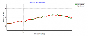

So if the mech cartridge/arm resonance is not there, or at a too high frequency, what does that say about the mech properties? Does that mean that the cart is too heavy and/or the arm too damped?
See attached; one is a 'good' (I think) setup, the other less so 🙂

Looks OK to me in terms of damping and roll-off. The resonance or corner f might be a bit low, and the penalty then is that attenuation at frequencies c 4-6Hz isn't very large. So sources like pinch warp might be more prevalent than desirable, but more generally as to the other benefits of a stable and well damped setup, that looks good to me, Jan. I might not expect it necessary or audible to have a seperate electronic filter.
Yeah that's what I thought. Now how should I fix that other one?

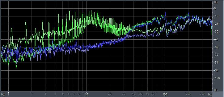

Tonearm does not have simple resonance. This is typical of low frequency response of record:
This data is from: Listening test - do you prefer CD or vinyl version
Blueish traces are CD version, which used same master as vinyl version. Eccentricity of center hole of record is a dominant player, but every little transient in the record groove also excites tonearm resonances.
Tonearm damping is typically only damped by cantilever suspension. Other damping point is tonearm pivot, which a few turntables such as Denon DP35/45 with servo control of tracking force and anti-skating.
DP35F was last turntable I owned. It could track warped records that would send most tonearms airborne. Badly off center records also played without woofer flopping about.

Those spectra you posted aren't representative IME and I'm not sure at all what they are meant to show...............

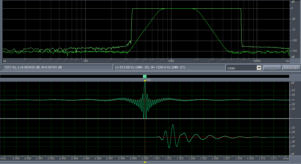

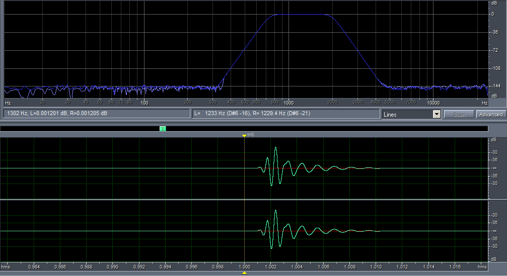

No worries, yes,yes, no to the 3 questions. Say the linear phase filter is real time, and at t=0 there is a unit impulse. The output of the filter in time after t=0 is a symmetrical waveform, beginning with a pre-ring, then a broadened peak, then a post-ring.
The peak occurs at a time after t=0, known as 'latency', depending on the implementation of the filter. So, relative to the audible location of the filtered peak, the pre-ring appears to occur before it in time.
Yes under these conditions convolving Dirac returns filter function. Dirac is full bandwidth stimulus. When bandwidth of stimulus is within bandwidth of linear phase system, only latency is present:
Using Cool Edit a silent two channel track at sample rate 48kHz is generated, of 96k zero value samples, then sample values for sample 48k in each track are set to normalized value of 1; this would be sample value of 32768 for 16bit rendering or 8388608 for 24bit rendering. The waveforms have all energy in single sample; spectrum is flat 0Hz-24kHz. Band pass filtering is applied to each track. Filters for upper displayed track are FIR filters applied with Cool Edit’s FFT filtering tool. FFT is set up with Blackman-Harris windowing; a 16384 point 350Hz high pass filter and a 4096 point 6500Hz low pass filter are applied. IIR filters are applied to lower displayed track using Cool Edit’s Butterworth 10th order filters (BW10); BW10 high pass with 750Hz cuttoff and BW10 low pass with 2000Hz cutoff are each applied twice, giving resultant filter with Linkwitz-Riley type slopes:
In the above sample 48000 at 1 second is marked as t=0 where all the energy started out. For FIR filtering energy is symmetrically distributed on both sides of t=0.
For IIR filtering the impulse starts at t=0, but the energy is peaking about 2ms later. This is group delay, pure and simple. If IIR waveform is looked at closely, it is seen that
In reality, no IIR is infinite, decaying into noise floor. The band pass IIR filter generated here decays to all zero values after 1496 samples. The IIR is copied to clipboard and convolved with entire 96000 samples of the FIR filter:
No pre-ringing is seen. The FIR filter passes the IIR filter unaltered with exception of added math noise.

I think your second measurement shows a system with a Q of less than 0.5 (too much damping).
The difference btn the two channels in this measurement suggests there are Q differences in the lateral direction.
What is the arm and what is the test signal?
Another question. What is the frequency resolution of your measuring system?
The difference btn the two channels in this measurement suggests there are Q differences in the lateral direction. What is the arm and what is the test signal?
George
The test signal is a low frequency sweep (it's really a freq response measurement driven by a sine sweep) on the Adjust+ test record.
The test signal sampled at 44.1k/24 but I will redo it at 96k/24 when I get some time.
If the arm would be too heavily damped, wouldn't I see still some resonance of the cartridge? There is a separate test for the arm alone, which normally resonates at several 100 Hz. See example of the same arm.
Not sure what you are trying to show here. An IIR at double precision floating point (-300dB noise floor) behaves quite differently than the same filter on a 16bit DSP. By definition an IIR filter is minimum phase and can not exhibit pre-ringing and opposed to conventional thought FIR filters can be either linear or minimum phase.
There would be no f response peak, in fact a sort of roll-off as frequency decreases, eventually becoming a -12dB/octave slope.
Trouble is that increasing mechanical damping increases forces on the stylus, requiring increased VTF to conserve trackability.........it's an equilibrium.
I think a Q of 2 or thereabouts is not a bad aim in practice.
Using Cool Edit a silent two channel track at sample rate 48kHz is generated, of 96k zero value samples, then sample values for sample 48k in each track are set to normalized value of 1; this would be sample value of 32768 for 16bit rendering or 8388608 for 24bit rendering. The waveforms have all energy in single sample; spectrum is flat 0Hz-24kHz. Band pass filtering is applied to each track. Filters for upper displayed track are FIR filters applied with Cool Edit’s FFT filtering tool. FFT is set up with Blackman-Harris windowing; a 16384 point 350Hz high pass filter and a 4096 point 6500Hz low pass filter are applied. IIR filters are applied to lower displayed track using Cool Edit’s Butterworth 10th order filters (BW10); BW10 high pass with 750Hz cuttoff and BW10 low pass with 2000Hz cutoff are each applied twice, giving resultant filter with Linkwitz-Riley type slopes:.
Barleywater, I timed out after 10 mins of trying hard to work out what you have done here, and what the point is.
If you don't accept a mathematical certainty, backed by a clear audible demo with a common sense explanation, there's just no hope..........
Mathematical certainty is zero phase-shifts between harmonics. Pre-ripples have no relation with the signal contents, just with the steepness of the filter used.
