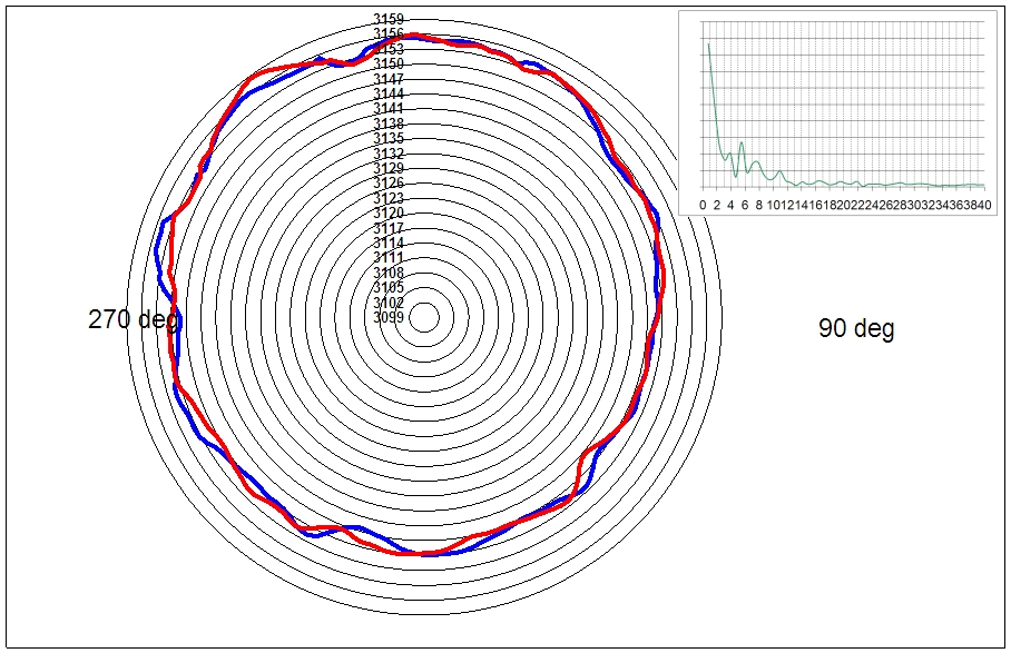

A few years back, I came across a great method for evaluating FM modulation (pitch modulation) due to low frequency mechanics. Using a 3kHz test tone, 'instantaneous' frequency is plotted against time, but in a circle such that once around the circle is one revolution of the platter.
A picture is worth a thousand words, so I attach a plot from software I wrote for my own use. This clearly shows the major effect of eccentricity on pitch stability. But it is also excellent at showing other sources of pitch stability, including headshell wobble due to cart/arm resonance.
Once round the circle is one platter revolution, radius is measured frequency, each ring represents 0.1% frequency variation. Red and blue traces are two consecutive platter revolutions.

Heyser spirals are 3D, with time as the z-axis. My plots are 2D with time represented by rotation around the circle, ie angle, and once around the platter is once around the plot. There is only one variable, which is the radius of the circle, in this case 'instantaneous frequency', the output of a software FM demodulator driven by a 3kHz recorded test tone (3150Hz usually).
The data is simply in the form (time, frequency), so I think doesn't lend itself to Heyser plotting which needs time and 2 variables........
\edit: I see what you might mean, have the z-axis as time on a slow sweep so that a 3D record of the pitch stability forms? Interesting !

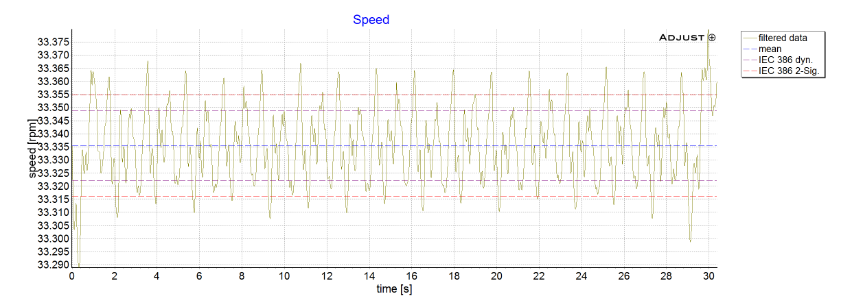

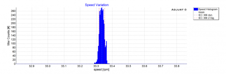

Yes that's a nice way to represent the data. For long-term drift you probably would have too much overlapping circles to make that of interest, but it's nice for a short-term impression.
The Adjust+ software represents it as the attached. This is filtered with 0.55 Hz.

For the type of FM modulation that Luckythedog just showed can someone give me an idea of how much eccentricity we are talking about here? I never thought much about how far off a center hole could be until all this discussion. Is this thousandths of an inch or hundredths or what? I imagine nobody would ever try and correct this, what would you go by the lead-in groove if you could measure that. Would this fm modulation be equivalent to speed variation on a reel to reel recorder or different because we are talking about a three dimension mechanical system in a turntable.

Yes, tiny offset is all it takes, If center hole is off, or doesn't fit snug to the platter spindle then eccentricity effects occur.

For +/- 0.1% pitch variation, an off-centre dimension of about 150um (0.15mm) would suffice. That is +/- 1 ring on my plot, near the threshold of lf pitch variation audibility for most people perhaps.
Yes, it's a tiny dimension that is frequently exceeded. Much overlooked and yet another elephant in the room.........

In my case it is about 1 mm pk-pk. Which is about 40 thou for the metric-challenged ;-).
