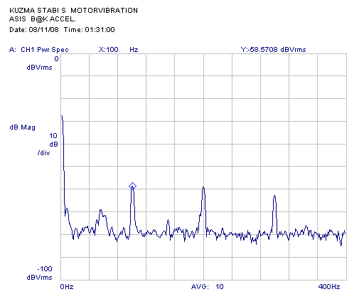

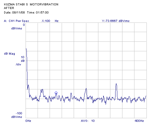

Now that we are on record players again. Most AC motors of belt-driven players are not optimal. The standard Airpax motor uses a capacitor to generate the 90 degr phase shifted voltage for the quadrature coil. However, if that cap is not exactly the right value, the phase shift is not exactly 90 degr and the motor vibrates more than necessary.
If you measure the sidebands due to the vibrations and finetune the cap value, the vibrations decrease.See attached plots. In this particular case, the cap was 0.22uF (or 22nF, don't remember exactly) and we had to add about 5% to get the vibration minimum.

It would be so easy to generate precise quadrature drive.
On each of the two turntables I have on loan from Don North, the drive signal is crystal-controlled, which is well and good. But for the two speeds of 33.3 and 45 rpm, Heybrook doesn't bother to switch the phase-shift capacitor! In addition the off-line power amp (non-isolated) is on constantly, with the output coupling capacitor failing (each was DOA when I received it), the crystals are switched by a rotary switch with long lines going to the crystals and associated oscillator---so there are periodically dry-contact problems. Oh, and a bunch of other defects. But one it is spinning (sometimes requiring some manual help as the starting torque is marginal) it plays LPs quite well. At least the platter is fairly high-mass.
