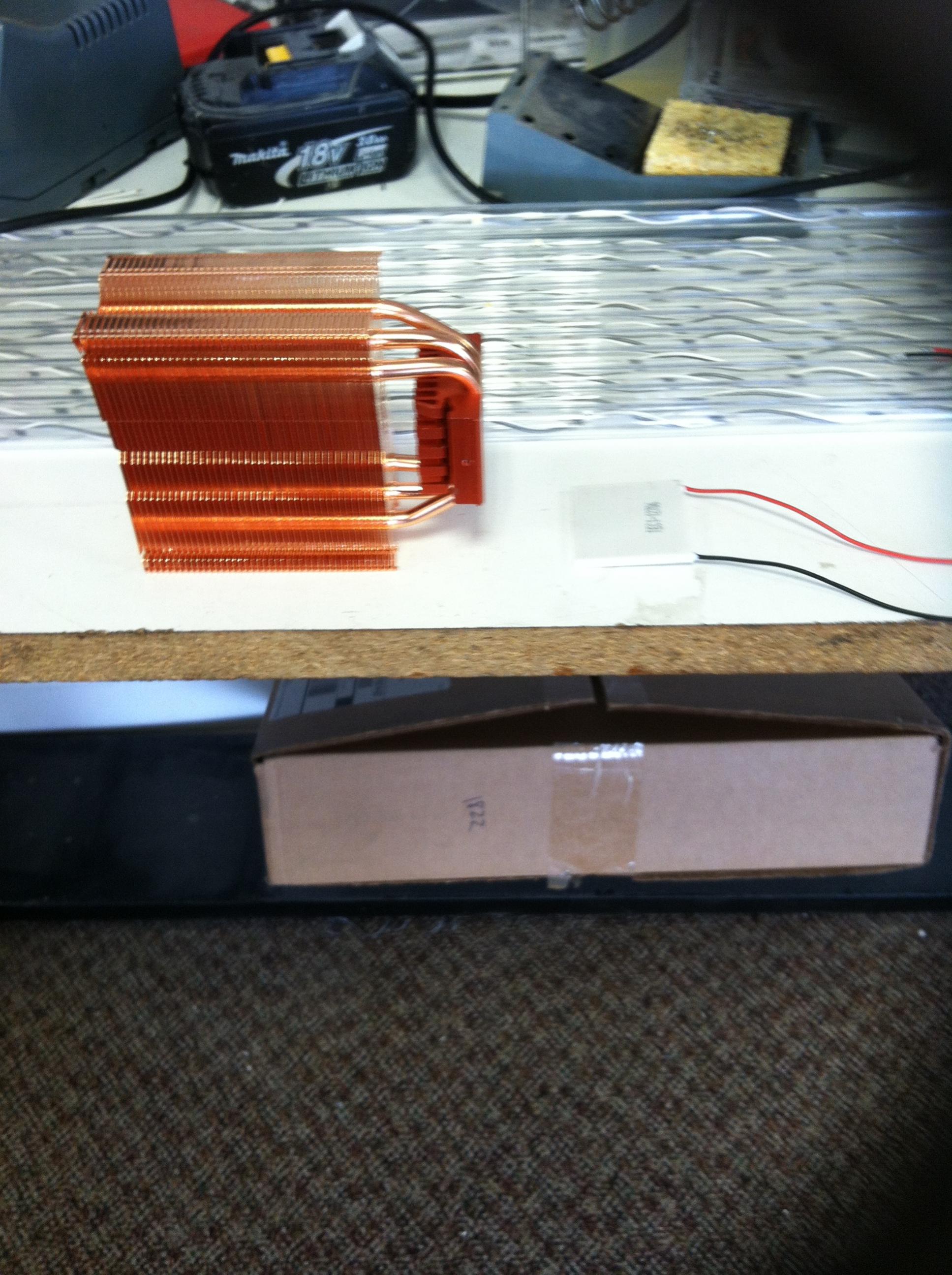

Attached is a picture of the heatsinks being used. One per 12706 device. The fan attaches directly to the fins. It was designed to cool a pentium so the 20 watts each one sees doesn't appear to be an issue. At 200 watts it is designed to keep the contact surface be under 47C.
Now the use of a linear power supply is actually a bit much. All I really need is a center tapped transformer and pair of low Vf rectifiers. I use the devices well below ratings at 6 volts. They seem quite happy there.
But by all means do let me know where I am foolish. (Not counting spending time here.)

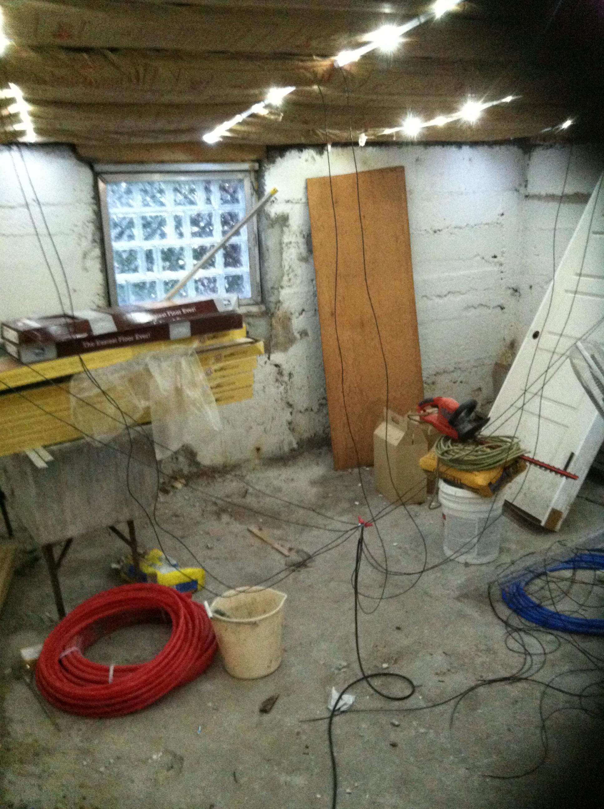

Also attached is my basement lighting under construction.

Ed, electric wiring conform US safety code? Or is it just floating earth?
24 volts or lower doesn't require much safety concerns under US Code.
