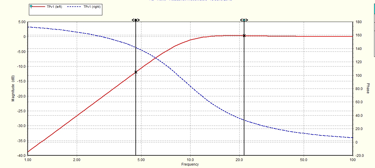

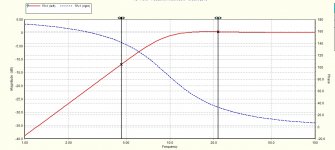

On the other hand, with no filter but just damping the mechanical arm/cart resonance, this is the frequency/phase response just from the mechanical system. You can see the natural 2nd order roll-off, which will always have fewer artefacts and audible effects than an extra electronic filter. An extra filter should be unnecessary if the resonance is controlled well mechanically IME.

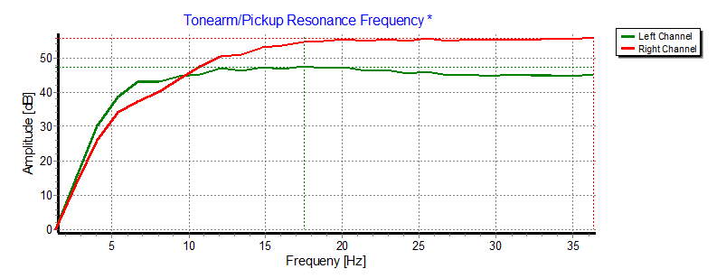

So if the mech cartridge/arm resonance is not there, or at a too high frequency, what does that say about the mech properties? Does that mean that the cart is too heavy and/or the arm too damped?
See attached; one is a 'good' (I think) setup, the other less so 🙂
