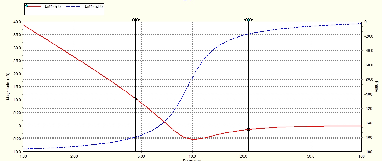

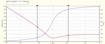

Yes........BUT you then need a filter with the following freq and (minimum) phase response (see attached plot).Esperado said:Yes it is. As you confirmed. Measure the LF ringing of your arm resonance. Set an analog active notch filter with the same resonance frequency and Q. Flat response curve, 0 group delay there.
And the problem a decade below the resonant frequency is obvious, +40dB gain at c 1Hz......just don't slam the door !
(Reposted, including the attachment this time )
