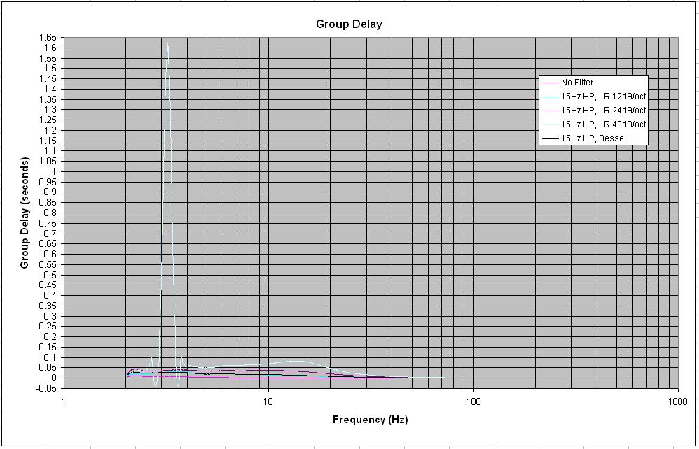

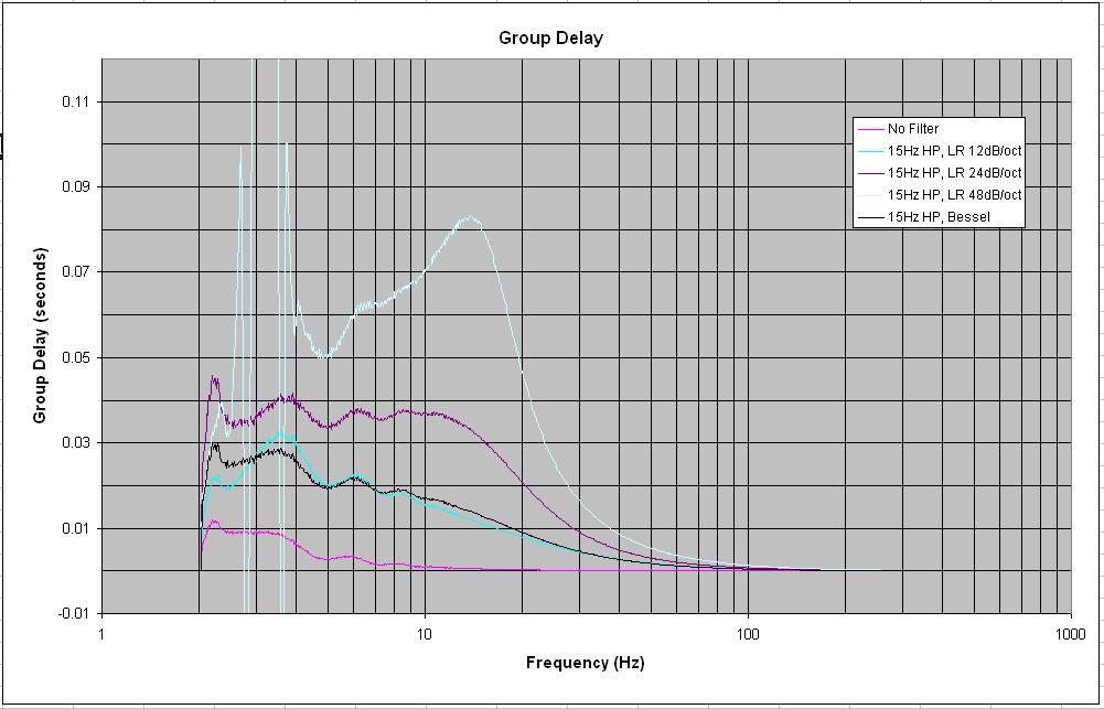

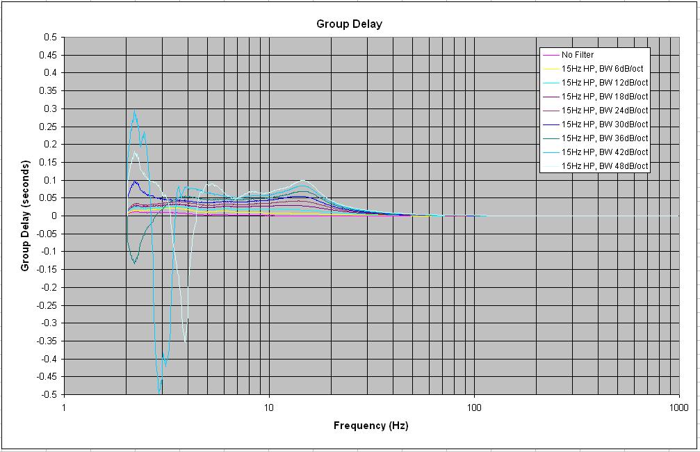

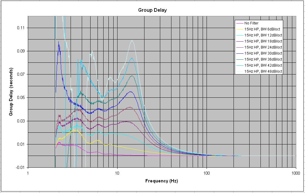

Now I will try to extract the GD from the phase data.
I managed to extract Group Delay data from the Phase data.
I hope that I am not far off with the time units. Please cross check what I show you (*)
