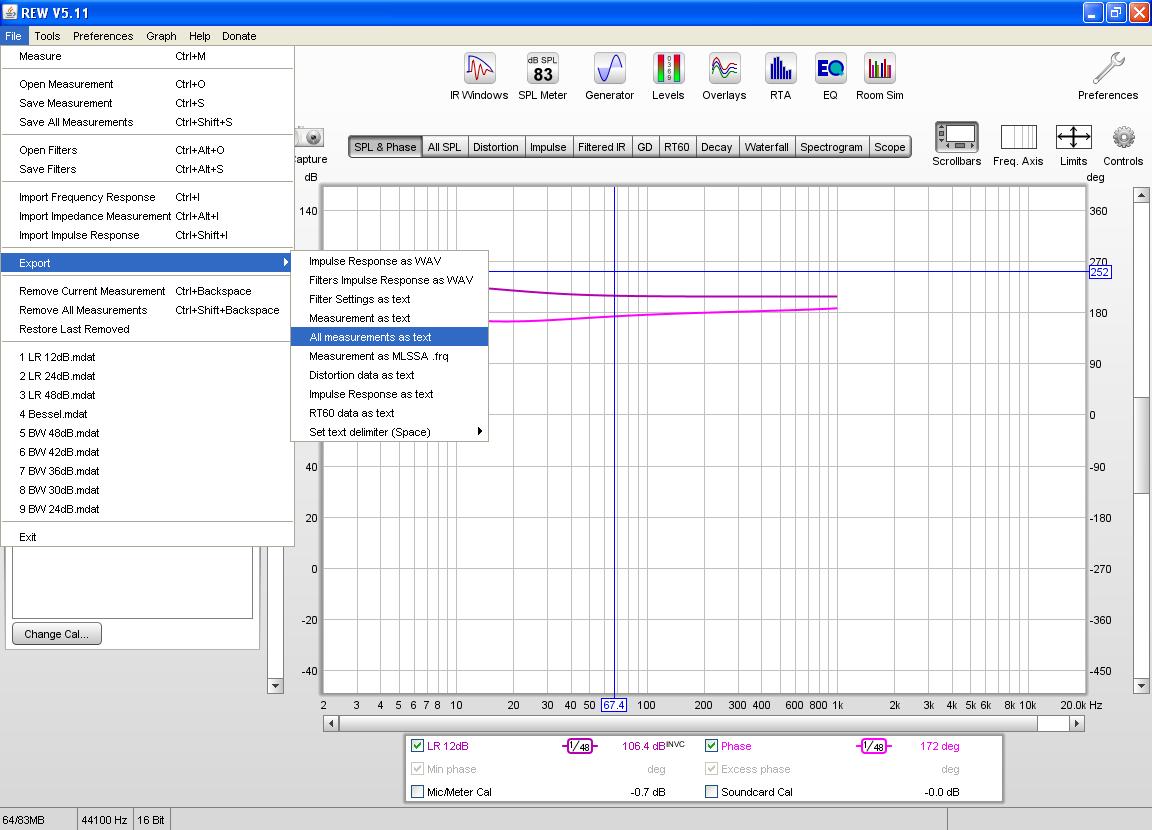

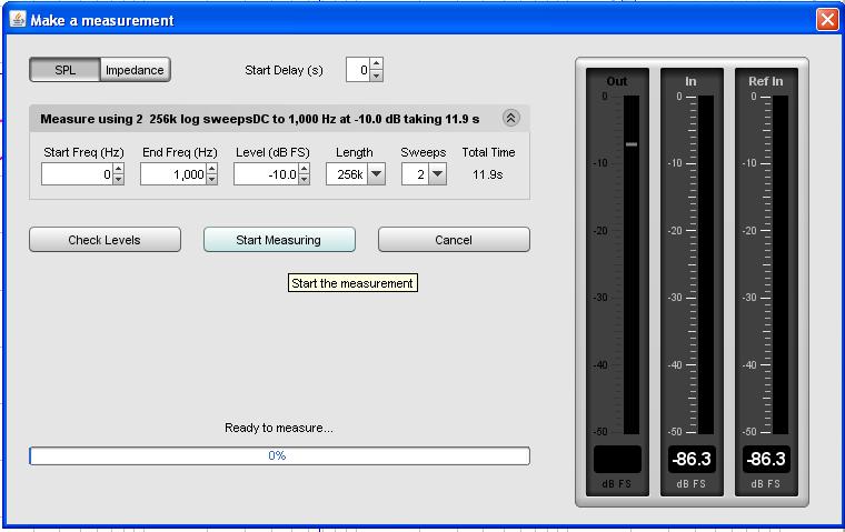

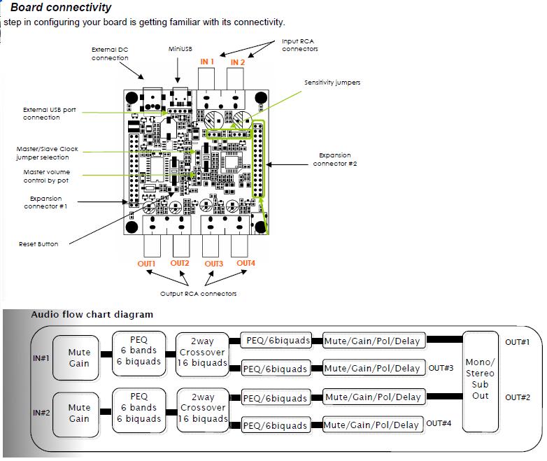

You are welcome. I did the measurements for myself (to see with my eyes how much twisted is the phase response with the settings I am using in my MiniDSP).
For the measurements, I used only a pc, a soundcard and the 2x4MiniDSP (the plug in is the 2.1 advanced)
Details:
Sound card was connected in the standard way (Card’s L_Out to Card’s L_In and to DUT_In. DUT_Out to Card’s R_In)
DUT_In was the Analog_IN2 of MiniDSP
DUT_Out was the Analog_OUT2 of MiniDSP
Test signal was 12dB below FS of MiniDSP input level.
No attenuation at the input/output.
Digital volume fully CW.
No delay and no equalisation.
Only the selected 15Hz LP filter in Crossover section was intervening between Input and Output.
The sinusoidal signal sweep was generated through REW V 5.11
[Measure]>[SPL] (see att. 2)
The sweeps are recorded automatically by REW.
There were generated one record for each selected filter, one record for no filter and one record for card’s loopback response.
I exported the data of all measurements in .txt form (see att.3)
There is one .txt file generated for each measurement. It contains three columns: freq., SPL, Phase and they are space delimited. With the above settings, there are 858 data triplets (rows). (*)
These I imported to a spreadsheet (Excel).
The main reason for using the spreadsheet is that I wasn’t completely satisfied with the calibration results of the sound card below 20Hz. So for to completely null the effect of card’s response on the filters response, I subtracted each measurement’s data from the card’s loopback data within Excel.
As a bonus from using the spreadsheet, I numerically performed phase inversion and phase unwrapping, which I neglected to do before exporting the data.
Now I will try to extract the GD from the phase data.
If for any obscure reason you want the data you saw on the diagrams, I can make them available.
