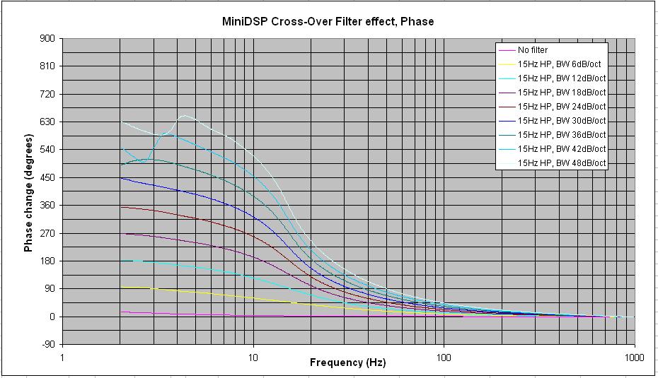

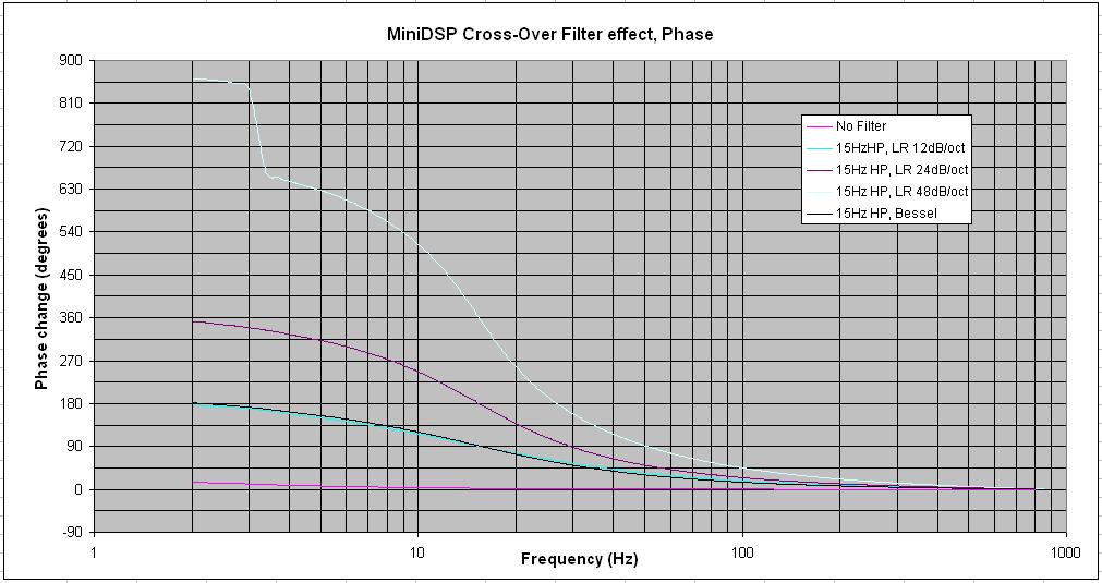

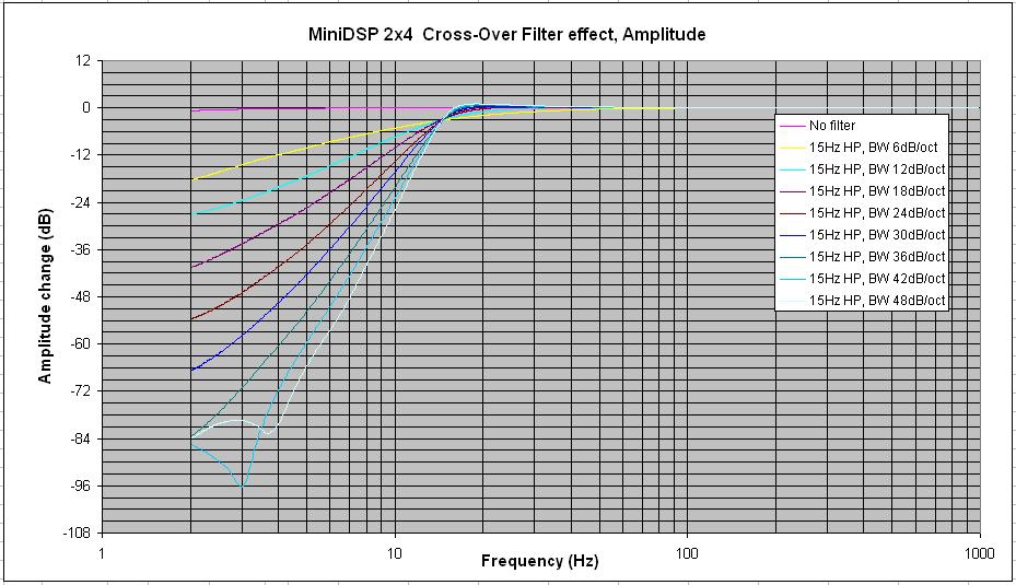

George, I have not started looking at it yet but how well does miniDSP handle the large difference in low frequency IIR coefficients?
Scott
This is the output of the MiniDSP 2x4 with a 15Hz High-Pass implemented with all the available filter types of the cross-over section (BW=Butterworth, LR=Linkwitz-Riley, Bessel)
I hope that I understood your question.
George
George
Yes that's exactly what I was looking for, ultimate attenuation 85 or so db. Probably fine, though with FP it becomes >150dB.
How did you generate/record the sweeps?
BTW - Thanks for going through the trouble I'm temporarily very hardware handicapped.
