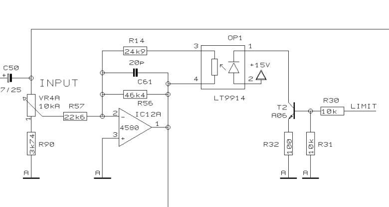

Note that the Behringer can manage about 9dB of gain reduction. But that may be enough for many applications.Behringer B2031 limiter circuit.
The limit signal is derived from output stages peak values.
Dan.
In the old days at Harman, circa 1990, the limiters in an automotive amp for Ford used optocouplers. They sounded pretty decent, with the inherent dynamics of the photoconductor and a little additional attack-release signal generation for the LED. Unfortunately, optos have a very complicated characteristic that depends on history, temperature, batch, etc. and the quality assurance folks were frustrated in their attempts to make the latest goals of tightly distributed behavior.
Eventually, the optos were eliminated and replaced with OTAs in the feedback path of an op amp. Didn't sound as good according to most listeners, but the QA folks were relieved.
Dan.
I believe McIntosh uses similar concept. cant ever get to clipping their PA.
But when I did it on a proposed PA, the listeners came back with a thumbs down... said it compressed the sound too much. So they didnt want that feature.....
granted the main listener (Prez) likes to play things loud! Got to please the decision makers.
