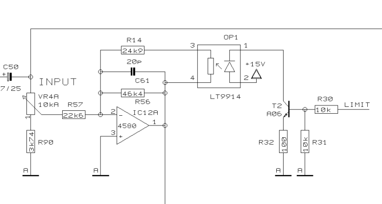

You can have a look on this 1980 patent too
Distortion free power limiting and clipping prevention circuit
George
Behringer B2031 limiter circuit.
The limit signal is derived from output stages peak values.
Dan.

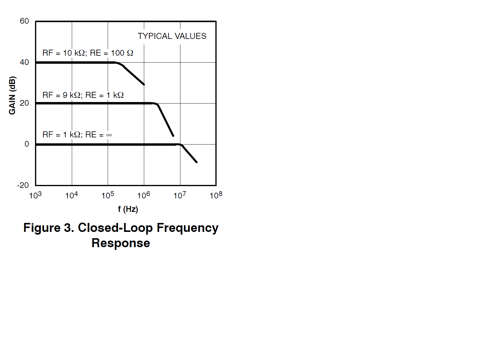

OK, see attached.
Your insertion of 30 extra channels means a loss of loop gain of 30 x which happens to be close to 30dB also.
The lowly 20 cents each in quantities CFA NE5532, used in consoles by the millions probably, clearly shows the effect of falling bandwidth with gain, of course.
Actually, going from unity gain to 30 dB noise gain (with 30 inserts) lowers the closed loop bandwidth from 10Mhz to about 250kHz. It's a tribute to your and your wive's ears that you can clearly hear this difference! 😉
