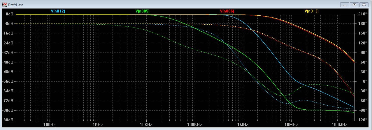

...each time i was○able to replace original OPAs by CFAs, there, the improvement was obvious, and sound back to life again (when lot of tracks active in a mixing desk );-)
that makes sense, to me.

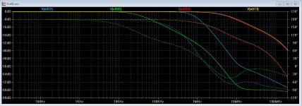

It is because, you know one of the advantages of current feedback amplifiers: their bandwidths don't vary with gain, contrary to VFAs, where it decrease as their gain increase.
In blue: VFA 1 channel in
in green: VFA 32 channels in
in red and yellow: CFA, 1 & 32 Channels in
That is what noticed my wife from the kitchen which is built in the middle of all the recording studios, as everybody knows.
[/I]
But why is that in practical amps a disadvantage? You design your amp with a specific gain and bandwidth, and that's that, right?
I can imagine that it is of importance in say switchable gain instrumentation amps, but in audio amps?
I know that there can be gain/bandwidth modulation in less well designed amps but that's minimal, if it is there at all.
We were talking of mixing desks bus preamps. They work in inverting mode. Each time you plug-in a new track in the mix, the gain of the OPA increase automatically.
I noticed that, when you listen to a single track, if you plugged many other muted tracks, on most of the mixing desks (VFA), its sound turned dull, compared to the same all alone.
According to my wife from the kitchen, CFAs cured the issue, to the great delight of our friend Waly. ;-)
