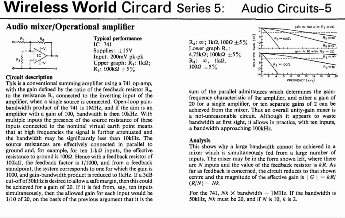

Actually, going from unity gain to 30 dB noise gain (with 30 inserts) lowers the closed loop bandwidth from 10Mhz to about 250kHz. It's a tribute to your and your wive's ears that you can clearly hear this difference! 😉

The statement was about 'dull sound'. As in drooping freq response. Which, in an intuitive way, can look entirely reasonable. Until you look at the facts.
I do not believe that a decrease in closed loop bandwidth from 10 MHz to 250 kHz is audible as 'dull sound'.
Jan

Too, about theory, what about the phases at 20KHz with 250KHz of CF ?
What about it? Does that cause your 'dull sound'? Facts?

In most summing amp designs in real world consoles I am familiar with (quite a few) there is no change in bandwidth as more or less channels are used. If a channel is muted or disconnected the summing resistor is taken to ground to keep the buss's impedance the same, so level, or any other quality, never shifts. That would be "a very bad thing". Muting is a standard part of the workflow.
Boards with voltage summing are especially careful about this and keep things constant (think old Neve's, pre inverting summing node summing adoption) as noise is very hard to keep acceptable in that design type.

Of course the indisputable effect of hanging a bunch more resistive inputs on the summing node is the increase in noise, unless the feedback resistor is reduced along the way. For the nominal 5nV/sq rt Hz 5532, with 30 inputs with R's the same as the feedback R, we have a noise gain of times 31 and in a 22kHz bandwidth an output noise of at least 23uV rms, and this neglects the resistors' thermal noise. If Rf is 1k, the thermal noise will be mostly from the paralleled input resistors and if they are 1k each, we wind up with another 3.4uV rms, so relatively small compared to the op amp voltage noise (the op amp current noise effect will be still smaller). If we swing to 20V peak at the output (running at abs max rails, risky) or 14.1V rms, the signal-to-noise ratio at best will be about 116dB, referenced to 1V rms out about 93dB. A 5532 could just manage the output current. Not too bad, and likely the noise in the sources will dominate anyway.

It seems pretty straightforward engineering to design for flat freq response even with 30 inserts in any technology. It's not that such things elude the most basic freq response measurements.
Behaviour is predictable, thus straightforward. But why shoot the messenger?
Esperado should only have mentioned from the start that his expressed experience was from around 1970, the same years that the attachment was printed, yes 741s 🙂
George
>Edit. For a unity gain mixer, the problem does not really exist
