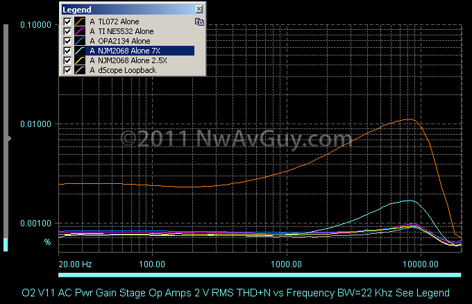

>Edit. For a unity gain mixer, the problem does not really exist
The popular replacement TL07x was often used also .......
![O2 V11 AC Pwr Gain Stage Op Amps 2 V RMS THD+N vs Frequency BW=22 Khz See Legend_thumb[1].png O2 V11 AC Pwr Gain Stage Op Amps 2 V RMS THD+N vs Frequency BW=22 Khz See Legend_thumb[1].png](https://www.diyaudio.com/community/data/attachments/439/439747-36812ee5a7e07ac0192770716c4b6381.jpg?hash=NoEu5afges)
What happens to it at 10KHz with 30 HF tones and/or higher OP level? Could it then reach audibility threshold? Seems very possible.
In my experience with listening and correlating sound with distortions, when distortion makes the sound have less clarity in the treble, it is not unlike describing a freq response roll-off. It is As If it was rolled off. But, its actually, added distortion artifacts --- maybe creating some additional masking, as well.
THx-RNMarsh

Slew rate yes, common-mode distortion and series noise not so good.TLOxx ridiculous better replacement.
Better in general Faster Slew Rate, Higher bandwidth, less harmonic distortion.

Of course damn near anything beats the 741 for audio, except perhaps the really sluggish LM124/LM358.Better in general Faster Slew Rate, Higher bandwidth, less harmonic distortion.
Oddly, TI still has preserved the utter nonsense that the RC4558, certainly no prize either, is essentially a dual 741. I just checked the revised datasheet, updated fairly recently but originally from 1976.
Note that the distortion stated for the TL072 is for an input impedance of <1k. Although it is possible to alleviate the common-mode distortion mostly due to the input devices' gate-to-substrate voltage-dependent capacitance somewhat, by balancing impedances seen by each input terminal, it's only effective to a point. Jung and others have written about substrate bootstrapping (the substrate is the negative power supply input) which is a good deal more effective.
They are cheap at least. For more money, dielectrically isolated parts are a lot better.

well, that is what I did to determine my own delta detection threshold number -- used music. .05% thd+n.
That was added thd in the form of OPS cross-over distortion via bias manipulation.
The TL07x under the conditions talking here about might exceed my detection threshold. Seems to have exceeded Esperado's threshold.
It is also quit likely the replacement CFA had much lower distortion at high freq as that is easy to do with CFA. Not saying changing to a better VFA would not have also been heard as better. Just saying.
THx-RNMarsh
