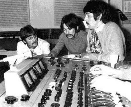

I am very often surprised by the difference between reality and what's in the people imagination about pro gears and studio practices.
Lets take an example. When the Beatles issued Sgt. Pepper's, we all imagined they used the last modern equipment at this time in their competition with the Beach Boys "Pet Sounds" production.
But, despite they were the best sellers of EMI, they were considered as dangerous thugs by the respectable leaders of this old classic company. The Legend says that when they were in the Abbey Road studio, most of the valuable and pricey equipment were locked away to be well protected from them. They were not allowed to use even the last 16 track tape recorder, and were obliged to use an old 4 track with a lot of premix and tape copies !!! In... Mono !
The reason why they decided to go on the roof of the studio to protest during the recording of the "Abbey Road" album.
Well, i had the bad luck to be asked by a friend to mix a demo on the Beatles mixing desk witch finished his life in a little studio of EMI France.
It was a little tube desk, very primitive with just a bass and treble simple corrector, and strange buttons for the levels.
While i protested about the obsolescence of this desk, saying it was impossible to work on such an antiquity, the local technical manager answered: "Oh, man this is the mixing desk on witch the Beatles realized Sgt Pepper."
What could-i answer ?
Now, when we listen to digital stereo remasterisation of Sgt Pepper, and find-it weird, should-we accuse digital ?

Don't spread misinformation, Esperado.They were not allowed to use even the last 16 track tape recorder, and were obliged to use an old 4 track with a lot of premix and tape copies !!! In... Mono !
1. There were no 16 track recorders at Abbey Road studios in 1969.
2. "Abbey Road" was recorded on professional eight-track reel to reel tape machines rather than the four-track machines that were used for earlier Beatles albums such as "Sgt Pepper", and was the first Beatles album not to be issued in mono.
Abbey Road - Wikipedia, the free encyclopedia
Yes, sure. Everyone who happens to own some EMI console claims that he owns original Beatles desk. Every Studer C-37 owner also says the same. 😀Well, i had the bad luck to be asked by a friend to mix a demo on the Beatles mixing desk witch finished his life in a little studio of EMI France.
I doubt people of EMI lied about their own history.Yes, sure. Everyone who happens to own some EMI console claims that he owns original Beatles desk.
About Abbey Road record, after a phone call to somebody who knows the history from inside, you are right, they had access to the 8 track machine and recorded this Album on it, like was done the previous "Beatles" Album.
Let-it be, i apologize for the confusion.
