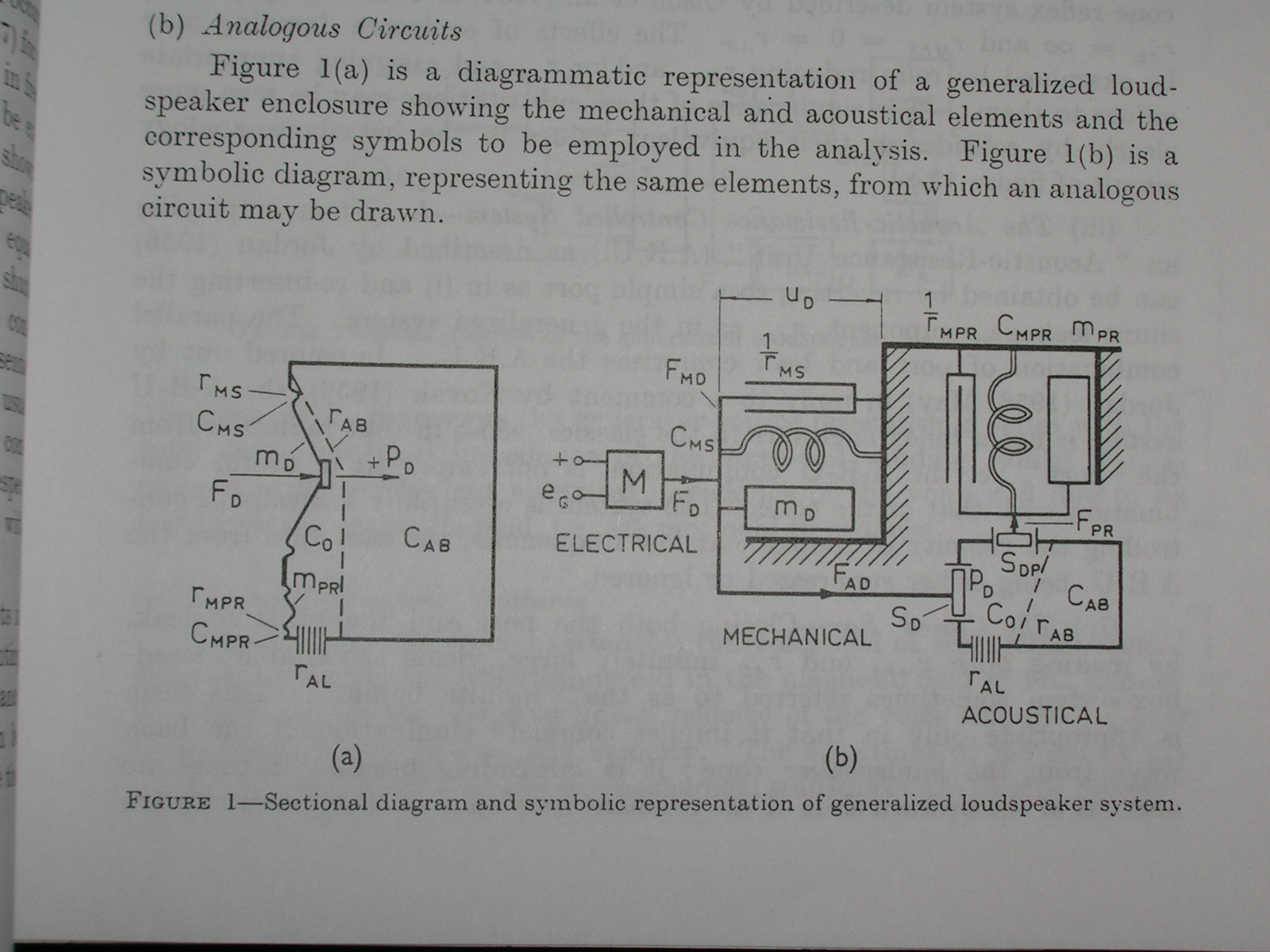

The most thorough technical explanation of damping through placing acoustic resistance at the rear or at the front of the speaker that I have access to, is here.
http://www.ejjordan.co.uk/PDFs/A-Cabinet-of-Reduced-Size-with-Better-Low-Frequency-Performance.pdf
Then, there is Attachment 1.
It is is a picture from page 9 of the book “Theory and Design of Loudspeaker Enclosures” by J.E. Benson.
There you see a dashed line representing an acoustic impedance rab which forms a space behind the driver marked as a compliance Co. The rab act in series with Co and both in parallel to the elements of the speaker. Also the rab provides a controlled decoupling between the compliances of the small air volume behind the speaker (Co) from the larger volume CAB of the cabin (or the room volume in case of an open baffle speaker)
It is important to minimize the mass component of the air through the resistive elements, so as these elements work as pure acoustic resistance and not as acoustic resistance in series with acoustic inductance. In more 'advanced' terms, increasing air mass inertia inside the acoustic resistance sheet, will turn the compression of the air at the rear of the driver from isothermal to adiabatic.

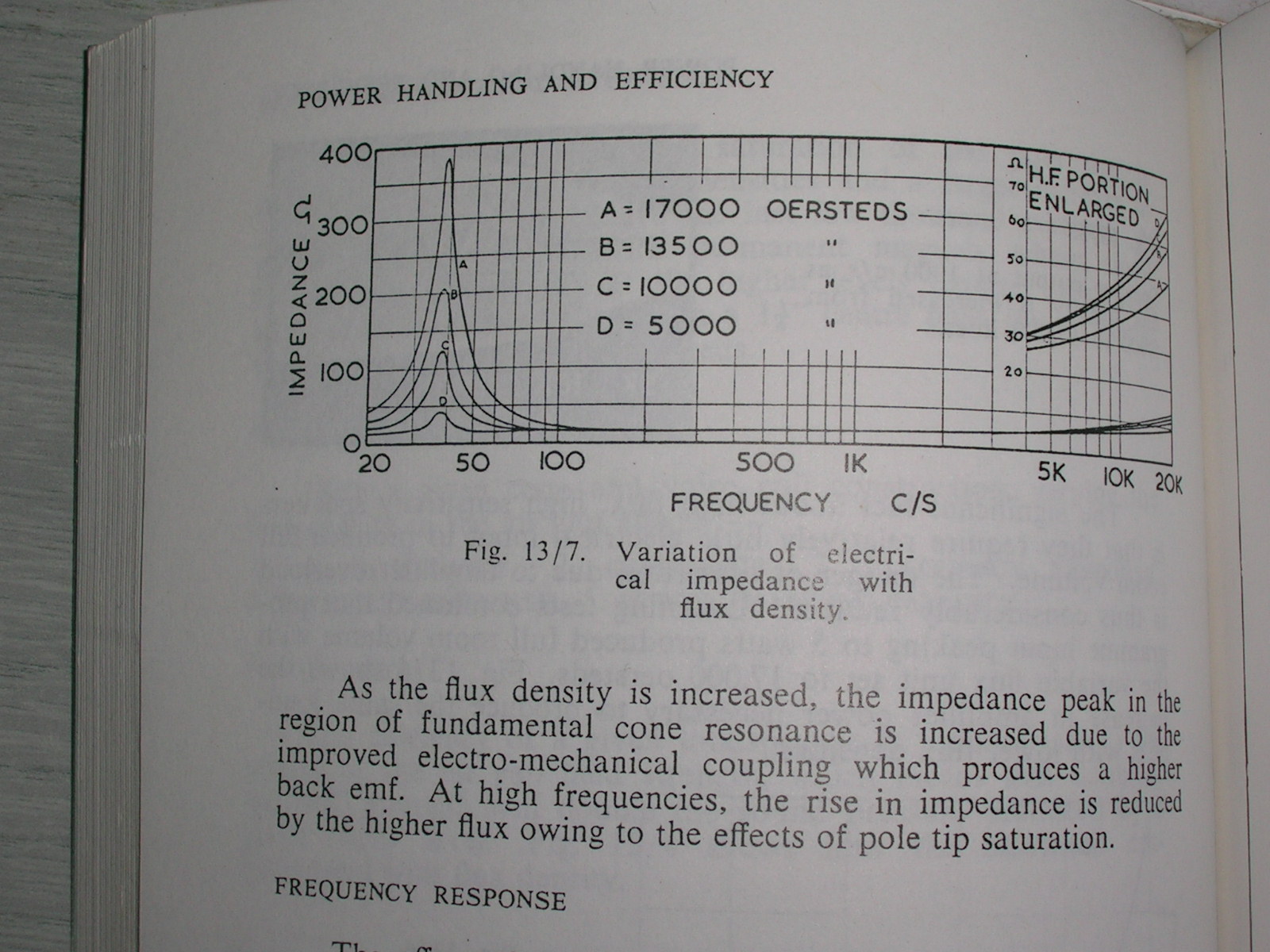

Attachment 2 shows a different way to damp the main resonance through adjusting the magnetic flux across the coil gap. It is a photo from the book “Loudspeakers” by G.A. Briggs (4th Edition 1958)
George
