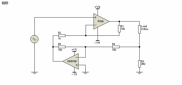

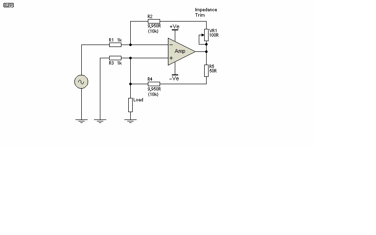

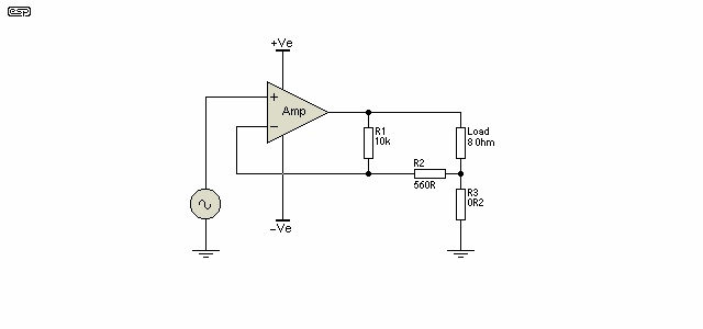

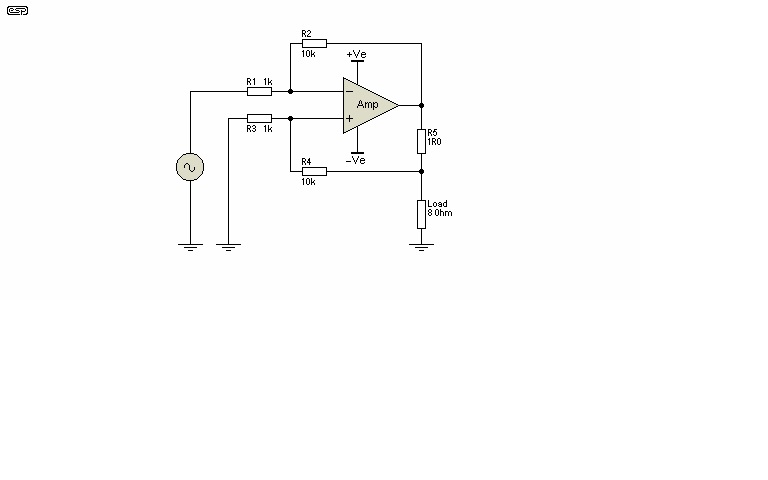

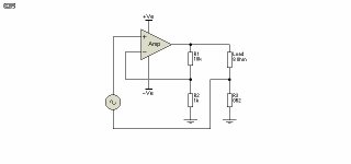

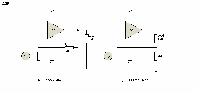

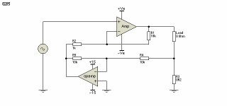

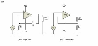

Mr. Elliot has some good stuff on current amps (variable impedance amp):
from:
Variable Amplifier Impedance
from:
