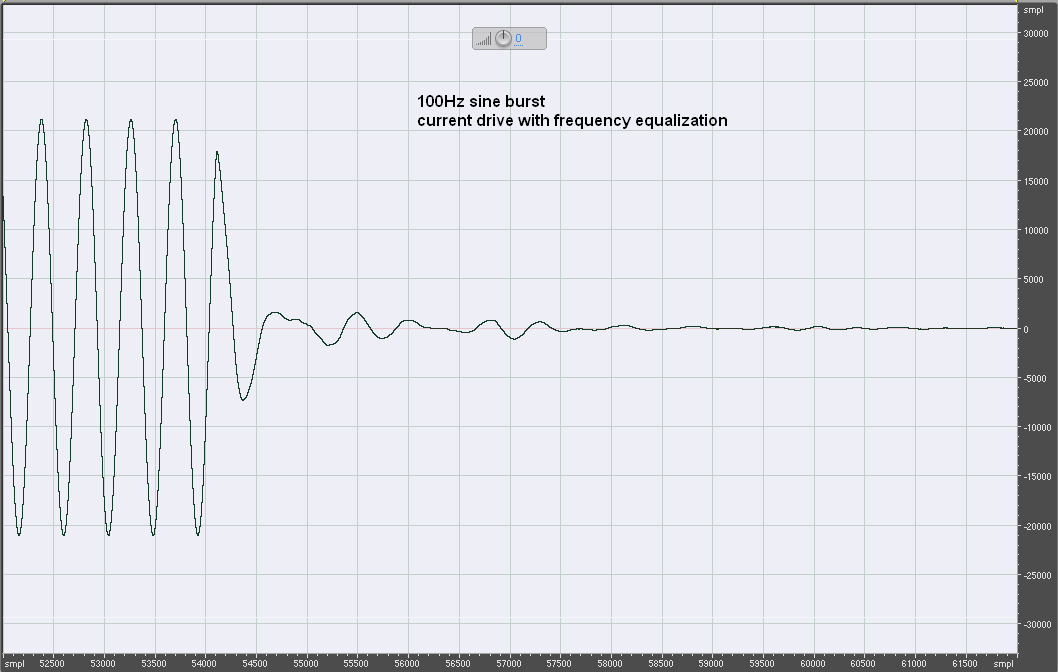

I have just made a set of new tests. Voltage drive x current drive with pre-equalization of input voltage according to speaker impedance. Square response is same in both cases. The "short and membrane tick" stigma would apply only for uncontrolled, i.e. flat voltage at the input of the V/I converter. Then the square response shape would reflect changes in frequency response due to speaker impedance curve.
Attached is sine burst turn off with both voltage and current drive.

Why would current drive interact worse with room resonances than voltage drive? Especially if the speaker is mechanically damped rather than trying to EQ out a high-Q resonance. Whether it is damped with EMF braking or mechanically I don't see the difference where room interaction is concerned.
Yes, there is no reason why would current drive interact worse with room resonances. BTW, I am plying with room EQ as well and I can confirm there is nothing wrong with current drive.
I assume that the reason why some guys are suspicious is that the current approach goes behind routine intuition that is usually applied, rather than real results. Also some knowledge base above usual diy approach is needed, like understanding of convolution, transfer functions and relation between time and frequency domains. I understand that some guys are confused.
Normally speakers are not mechanically damped, instead resonances are used to extend the frequency response, so it extends lower, with flow-damping you sacrifice (or you need to secure low frequency output by other means ) some lower range bandwidth.
With voltage drive the speaker will be kind of self adjusting as where the resonance work the amplifier current pull is lower.
With current drive you totally lack this self-adjusting property.
So that leaves us, for current drive only with the option of damping the cone motion with other means than springs. Either by EQ or some kind of mechanical damping (that does not result in impedance bumps). But what you do on the inside of the speaker is just one side of the equation, the room interaction on the other side of membrane is also a part of the equation.
That side is btw where we are and where we listen and a resonance there will also be visible as a rise on the impedance curve and with voltage drive, the result will be less current pull and electro-mechanic force on the cone and thus will the speaker to a large degree be self aligning, Not so with current drive. you'll have room boom fantastic. OR DSP
