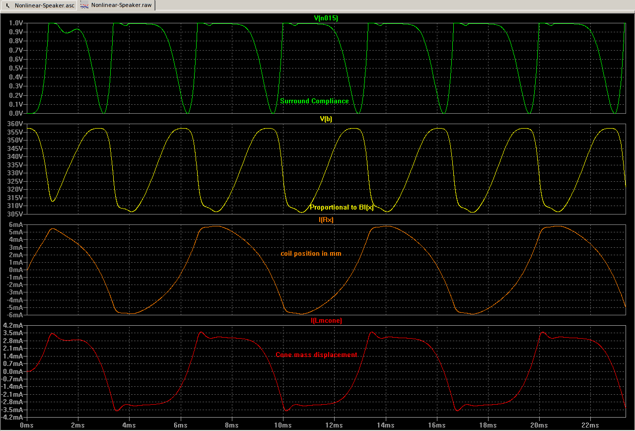

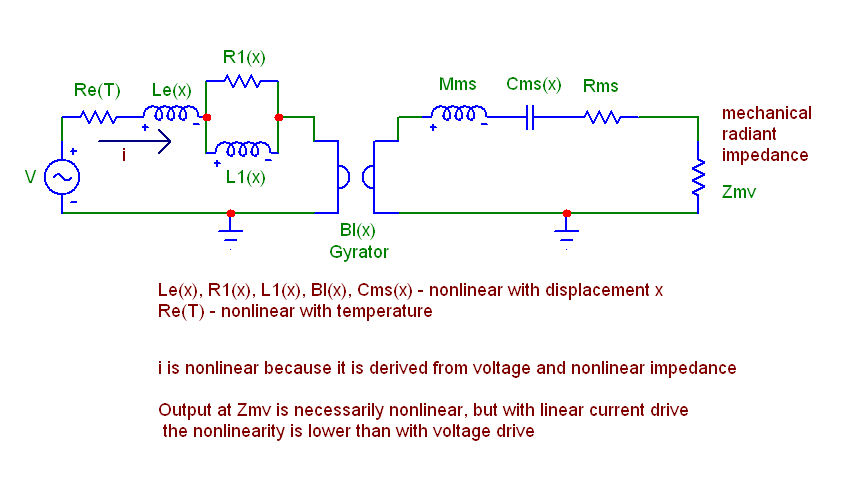

Here's some waves from my model. It has nonlinear Bl(x) and nonlinear surround modeling. It's being driven way past xmax.
I made a model in the simulator for nonlinear suspension. It was tricky but if I have an accurate K() function for the nonlinear suspension I could plug it in.
See attachment for only one of the suspension nonlinearities that have to be modeled.
Curious about other distortion mechanisms I can try to model.

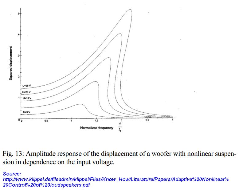

Steven, IMO the distortion would be reduced at any frequency with linear current drive. Image rather than words.

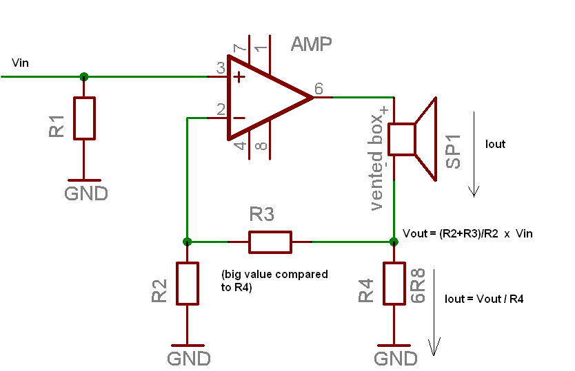

Does it have to be one or the other..??
What if a CFA is made with the speaker load in parallel to the feedback resistor, and the feedback GND-resistor in series with the load GND-resistor, then you get a little expansion where load impedance is higher. This way you can retain some of the corrective action, but not throw the universal usage away.

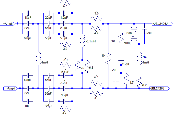

The first thing i do since decades, now, is to add a serial RLC network to any speaker i plan to use in order to compensate its impedance curve at resonnance, in // with a more traditional RC Zobel (can be more complex with Eddie Currents for tweeters ). The goal is to get a flat impedance curve equal to the DC resistance.
Under, an example of my passive filter for my medium/treeble horn (2426J JBL driver). (forget the high pass filter, the response curve correction and attenuator parts)
The listening improvement with a voltage source traditional amplifier (a CFA, of course ;-) is obvious and worth the price of the components.

It is impossible to use the current drive without frequency equalization.
Pavel, you know that it is possible and conditionally beneficial.
With an uncompensated (or mildly compensated) loudspeaker unit and CFA drive, the impedance increase at resonance and the gradual tilt upwards at higher freq due to driver inductance, will translate in increased acoustical output. This, may be utilized when working on a system basis (amplifier for a certain speaker) and not on a component basis (amplifier for any speaker).
