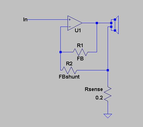

Seeing how it appears that adding the speaker to the feedback loop works and I imagine it would work for either a VFA or CFA type amplifier circuit is it as simple as it appears to implement as it appears or are there going to be other things that need to be done to make this a working system?
Please take into account it is a current drive. The amplifier gives
Iout = Vout/R4
Vout = (R2 + R3)/R2 x Vin
Please check the attached image.
You need to equalize frequency response, which reflects Zspeaker. Direct use is impossible.
Take a DSP, pre-equalize Vin, and you are there.

Pavel,
Can I assume that you would first build the circuit and then measure the FR and then using that information implement the dsp correction or would you know the changes to the FR if the impedance curve of the speaker was already known in advance? How is this any different than having to correct the FR of an ordinary speaker in practice generally today?

Thank you Pavel. I assumed that an active network would be used before the amplifier by you drawing. Now would there be a problem if there was a tank LCR circuit at the speaker terminals flattening the impedance curve, would that make this circuit unusable? It seems that increasing the impedance seen by the amp was part of the intention to create the current drive rather than a voltage drive.
Richard,
I tried it and it works, in the bass area. The simple V/I amplifier based on old improved Sinclair Z30 (long live old sir Clive), as per attached drawing. Shown as as well distortions with voltage and current drive. It is not only limited to resonance peak, but it works in the area of frequencies below some 100Hz.

Keep in mind this is old ground, back emf based systems were used for control way before in loudspeakers and even at that with Tube amplifiers in the 40’s and 50’s before we adopted the “voltage source” as standard.
If you’re serious about this pursuit, I would offer first that simply raising the amplifiers Voltage swing via an added resistor can reduce it’s distortion so one must draw conclusions cautiously.
Also, fwiw, above the low frequency end, the Voltage across the moving part or gyrator is small and falls by half each octave one goes up in frequency. What that means is for all practical purposes, it already IS driven by a current source (I = input V / Rdc + moving impedance/back emf). As the back emf falls the effect of it falls.
What I was trying to explain earlier is that the back emf is a very usable velocity sensor but the problem is, unlike a drone coil wound along side, the driven coil’s terminal voltage is both the back emf AND the voltage cause by the current across Rdc.
If one senses the output current AND then ADDS some of that back in as POSITIVE feedback, then (at null) one is adding an extra voltage to the driver, proportional to the current so that one achieves a Velocity mode of operation.
This is FAR more than a high damping factor, this is like multiplying the size of the magnet (not in power sensitivity but in response shape).
Consider that your amplifier is separated from the part that moves that converts power into motion and sound by a simple resistor.
That is the resistance of the wire in your voice coil. When you tap on a woofer outside the cabinet you hear in “boing” or ringing, the free air resonant frequency damped by the mechanical losses which comprise the Qm.
Short the terminals out and now tap the cone and its VERY different, “dead”, damped by electromagnetic damping or Qe. That “shorted “damping is actually the back emf caused by motion across the resistance of the wire.
Put a resistor equal to the Rdc in series and you see it is a little less dead but still very damped.
When you short the speaker with an alligator clip or penny, you have essentially an infinitely high damping factor, when you add a resistor equal to the Rdc, you have a DF of 1.
I did a much more thorough job explain this stuff in the 5th edition of “Handbook for Sound Engineers” if interested.
When you have a negative impedance source, and you tap the cone, you now observe it is even more stiff and if you push, it fights back and tries to retain the original position.
THIS is when you have real motional feedback and how one can reduce the distortion at the lowest frequencies where distortion is both most audible and most loudly produced by loudspeakers.

While many old Tube amps had this negative impedance ability, I am not sure many thought about distortion because going to full Velocity requires you to eq your low end back up. Velocity is a +6dB per octave rising slope which gives one very tight bass or very anemic low end, depending one ones taste. What gives a small direct radiator flat response (where K<<1) is an acceleration response and the cure is obvious. This is why the Crown delta Omega didn't fly.
Note this circuit, not what’s used but what the current feed back does, it is positive current feedback which produces a negative output impedance.
Motional feed back amplifier - Electronic Circuits and Diagram-Electronics Projects and Design
I found it necessary to use an rc low pass filter on the input of the power amp to allow more –fb at lower frequencies (that old Bode criteria).
What you will find as you make the impedance more negative is that adding a tiny L in series with your small current sense resistor, making it more closely emulate your driver’s Rdc+Le series elements will help. Ultimately you reach a point where it begins to squeal or squeals on audio peaks and you have now gone a bit past what you can fix this way.
The biggest drawback is that what might have been flat bass response is now distinctly rolled off, -6dB per octave but you can fix that and distortion will be lower.
The next fly in the ointment is that once Rdc starts changing, your added control starts falling apart. With woofer modern voice coils that can exceed 300C, power compression makes modern drivers not quite indestructible but now one must remember that the onset of power compression is seen between 1/10 and 1/6 of a drivers rated power so think big.

PMA's method with the 6.8R resistor should work with almost any power amp, I think. with other methods there may be stability issues.
If R4 is inductive, it will probably improve EQ because the voice coil is inductive as well. Regardless of current drive or voltage drive, we want the voltage across the speaker to be flat with frequency. So the inductance of R4 is probably not such a bad thing.
I believe in active crossover + pre-equalization before Vin as almost perfect method. We need some more headroom for extended voltage swing, compared to standard amplifier. But we are able to get up to 10x lower distortion even with a simple amplifier. I understand this will not be appreciated by conservative school of designers.
PMA, all new approaches are appreciated. However, we have to make our amps useful for a variety of loudspeakers and speaker types. Your method is practical only for a specific loudspeaker and not even a complete speaker system that is designed around voltage drive to get best frequency response.
