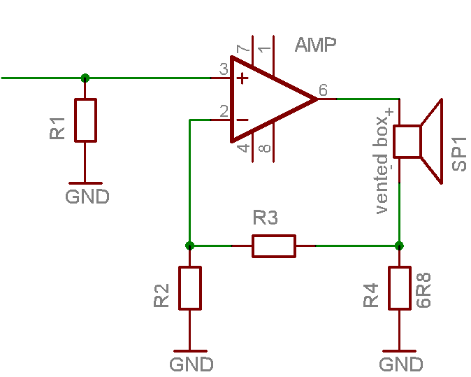

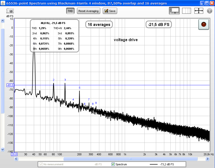

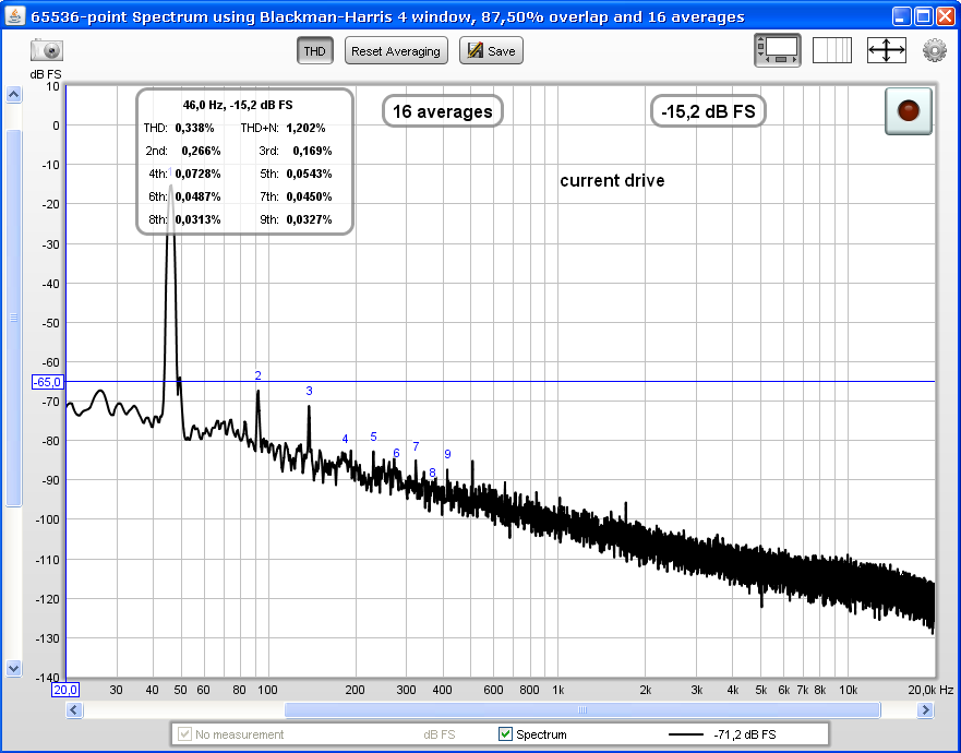

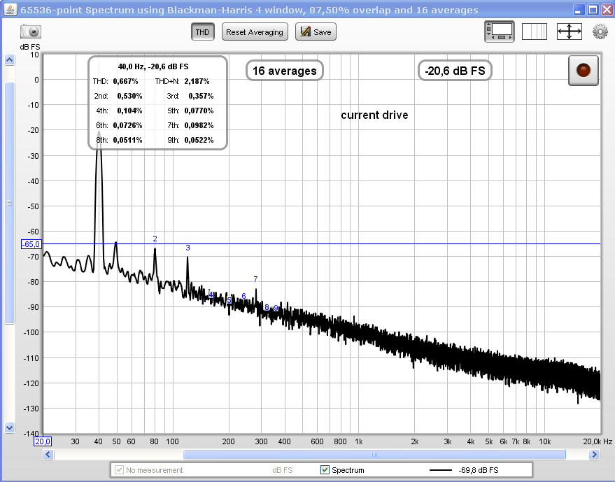

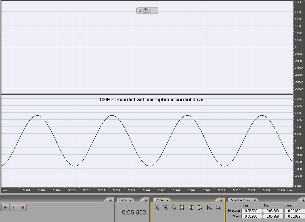

Richard,
I tried it and it works, in the bass area. The simple V/I amplifier based on old improved Sinclair Z30 (long live old sir Clive), as per attached drawing. Shown as as well distortions with voltage and current drive. It is not only limited to resonance peak, but it works in the area of frequencies below some 100Hz.
Pavel
I'm sitting here a few feet from the equipment, so I took my desktop Jordan
J92's (nice speakers by the way) in sealed boxes and hooked one up driven
by a voltage source at 1 watt (2.8V) at 50 Hz and snapped the distortion
waveform (about 3%) and its FFT.
Then I put 32 ohms in series with the speaker and set it at the same acoustic
level, and measured it again. I think from the accompanying photos you
will see there is some alteration, but not improvement in the THD.
What are audible differences?
Photoshop overlays of your FFT results:
Condition with resistor clearly adds more distortion products.
Discontinuity at zero crossing is also more pronounced:
Andrew
