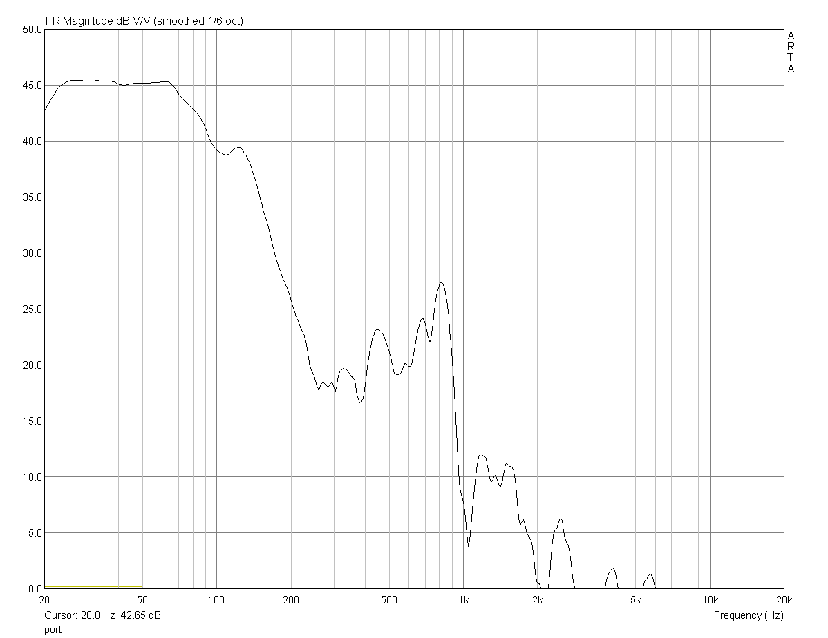

Thanks, that is consistent with what I would expect. Do you think that the
SPL level has a contribution from the port?
At this range of frequencies, high probability that yes.

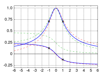

The kind of resonance must also have an influence. The bass reflex resonance
looks like a parallel circuit since it makes the impedance rise; otoh the mass / spring
resonance of a chassis must look like a series circuit as we are used from a quartz
crystal equivalent network. It would be damped by the radiation resistance and, much more
by the Ohmic resistance of the voice coil which is usually 30% of the nominal impedance.
Series & parallel resonances would behave very differently in case of voltage/current
excitation.
The 30% ohmic part also makes the concept of damping factor just marketing babble
as someone noted a few pages earlier, and fully correctly. With a 0.0001 Ohm amplifier
impedance you can control exactly NOTHING in a chassis that has 2 parasitic Ohms
in series.
