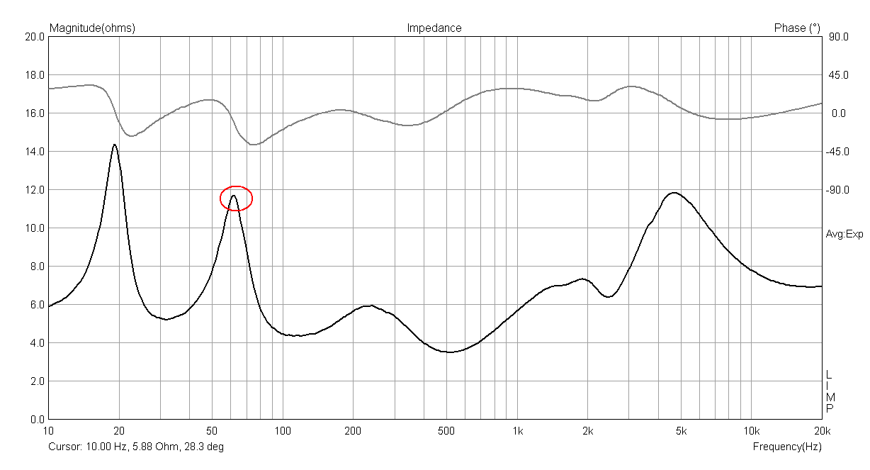

Based on impedance plot, looks like ported enclosure. I would guess that IM for mix of spectral components in 20-500Hz range is messy.
Do you mean damp, or attenuate the tweeeter ?.The value of each is app 1 ohm parallel with 10 ohm film. the tweeters DC resistance is 8 ohm, so the resistors damp the response a little.

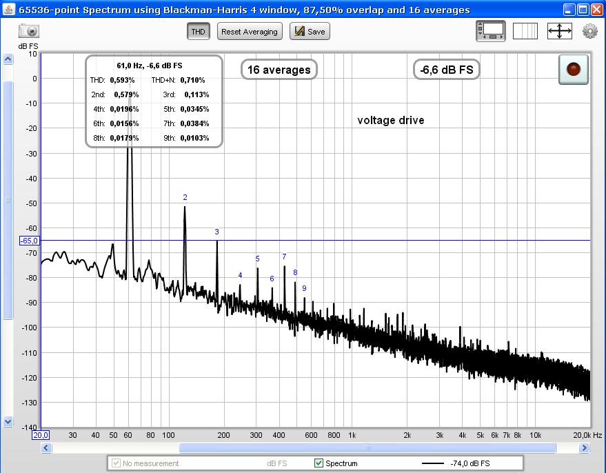

This looks like the circuits designed to create a higher output impedance.
If Rf is very large, it will mostly be a current source.
Let's try a thought experiment. Assume that a positive applied to the
speaker (+) results in the cone pushing out.
The back emf of the cone moving outward is electrically positive, which is
why the impedance is increased in motion.
If I simply pull the cone outward, then a positive back emf appears at the +
speaker terminal. Think of it as distortion, since the amplifier is not asking
the speaker to perform this motion.
If the + input of the amplifier is held to ground, then this appears as a minus
across the 0.2 ohms, and if this is fed to the - input of the amplifier then it
would appear as a positive at the output of the amplifier. This does nothing
to counter the force pulling the the cone out, rather the opposite.
Are you sure you wouldn't rather invert the polarity of the feedback from
the speaker?
Amazing.
I created, prototyped and measured and published the results.
It works very well. It will significantly lower the driver output distortion - esp in the low frequencies.
THx-RNMarsh
