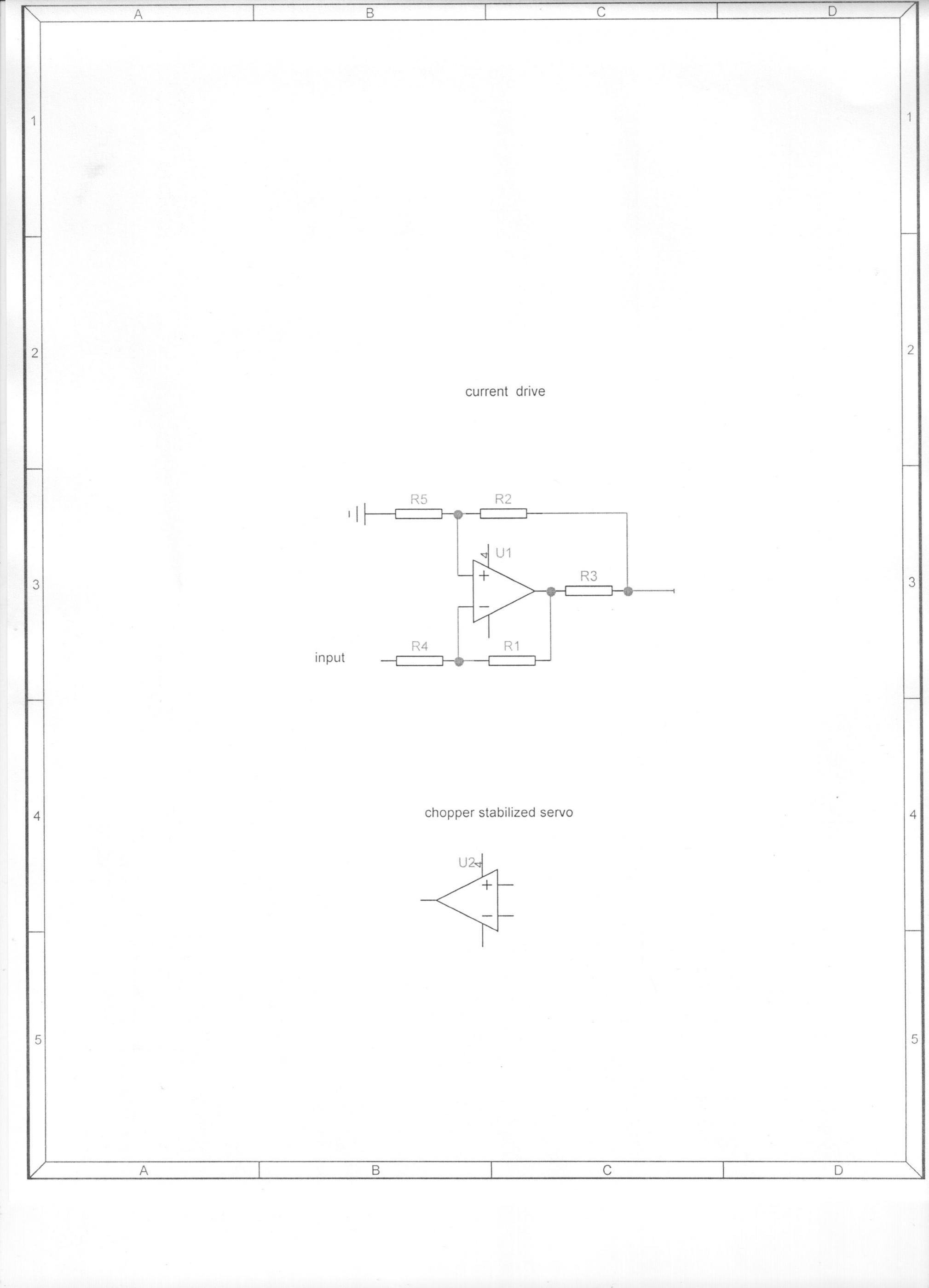

This is all you need to do to significantly reduce driver output distortion; Any high nfb (VFB) power amp can be modified easily for this configuration and tested with your own speaker of choice (I published this decades ago):
An Rs of .2-.5 works well.

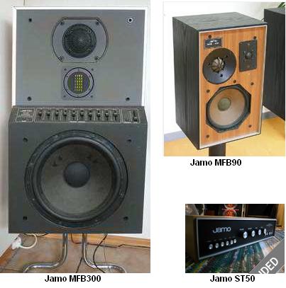

How many here have heard the Philips Motional Feedback speaker models in real life? As either Philips or Grundig?
I have experience with the Philips MFB bass drivers installed into Jamo MFB90 and MFB300 active loudspeakers.
I have only good words to say in terms of good sound.
Where I was working at the time for three years, these two sets of speakers made the difference as we had zero calls for malfunctioning or burn.
Considering the installations (apart from selected home users) were at music halls, conference rooms, clubs and discotheques, this was quite a fist and a proof of proper functioning of the MFB concept.

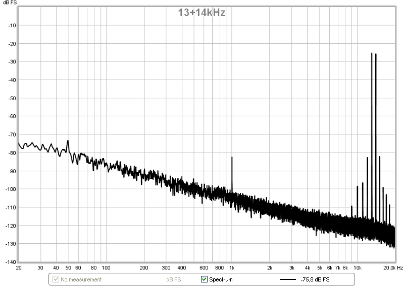

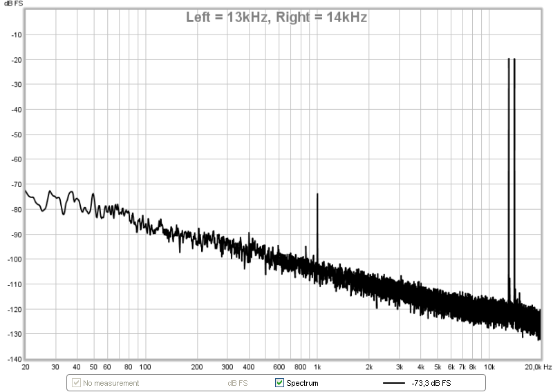

Try it at lower SPL (increase microphone distance).. What about microphone distortion?
I did, almost no difference. As a microphone check, I have already shown a measurement of 13+14kHz CCIF IMD.
2 methods of signal generation:
1) Left speaker = 13kHz, Right speaker 14kHz. In the microphone measurement, you see only 2nd harmonic (difference tone). No skirts around 13 and 14kHz, no odd harmonics.
2) 13+14kHz signal only from left speaker. Immediately you can see skirts - odd harmonics up to 9th, product of the speaker.

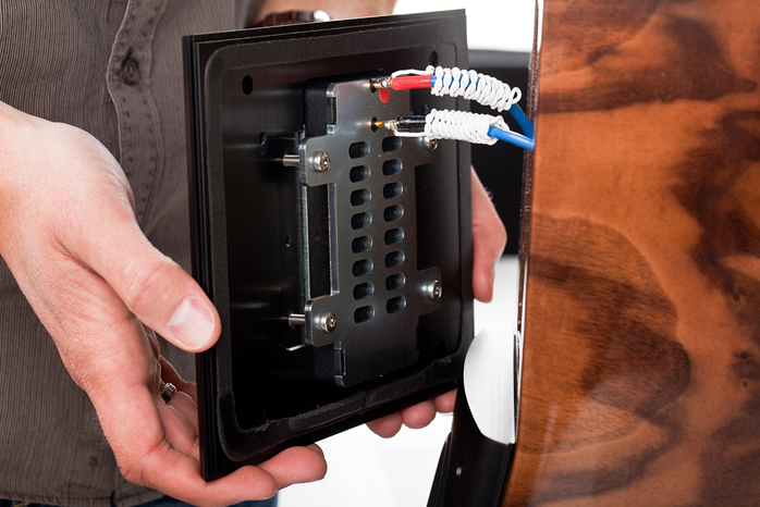

The white stuff is a single wire folded and twisted. This decreases the inductance of the length of wire, and also make it's field couple less out external fields. I suspect it is being used as a resistor, small value inductor, or both. I can't see what the other end is hooked up to.

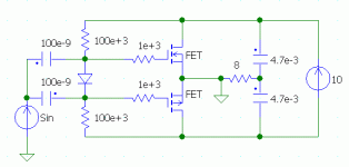

This looks like the circuits designed to create a higher output impedance.
If Rf is very large, it will mostly be a current source.
