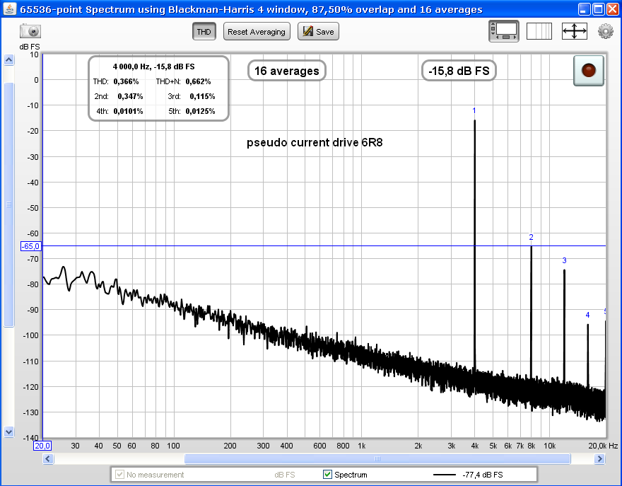

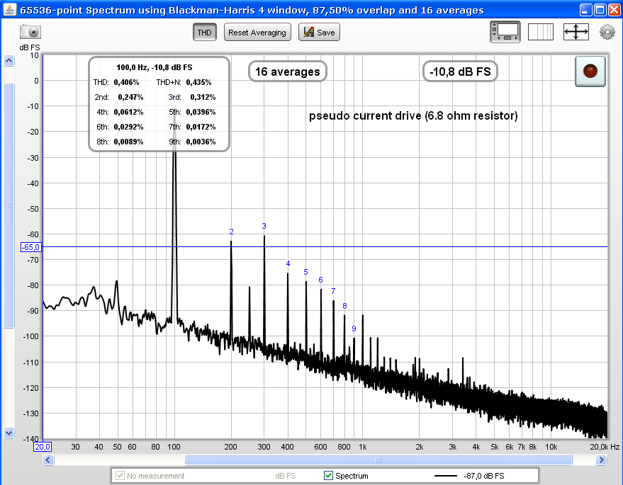

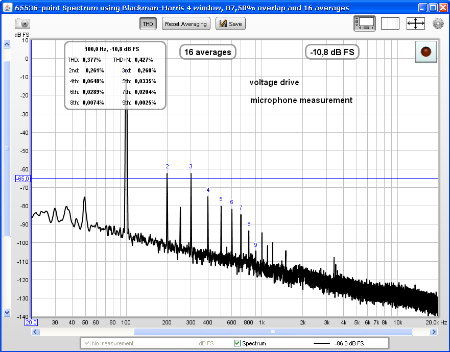

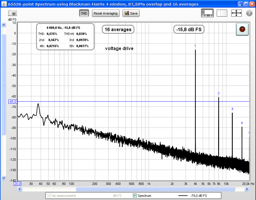

It is a good question, it is not. I can measure frequency response change and we shall see.
I forgot to show voltage distortion at amplifier output, attached now. It is 0.005% compared to 0.1% of current distortion.

It was not a measurement with a microphone, but a comparison of distortion of speaker current with distortion of amplifier output voltage.

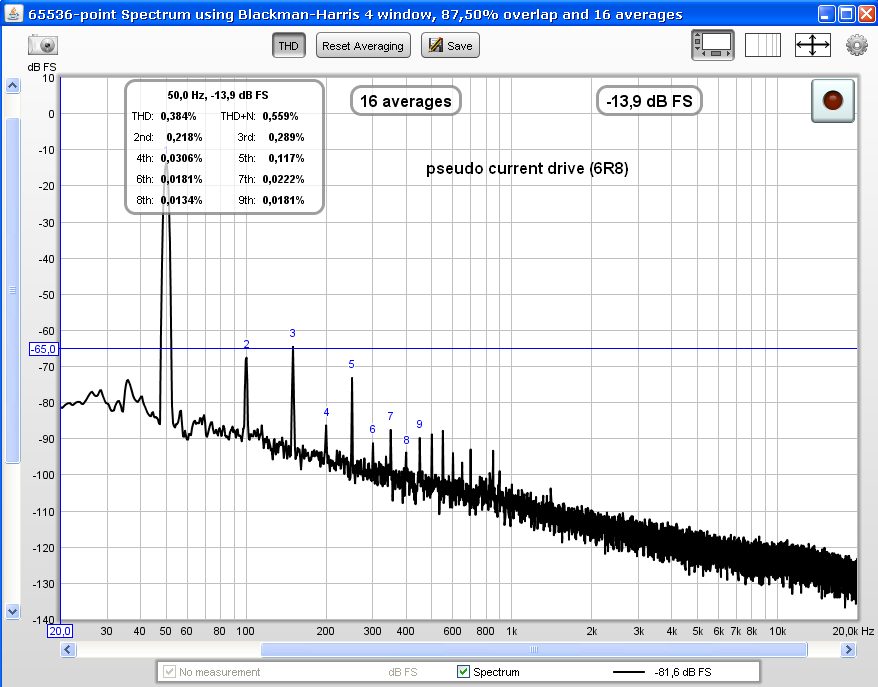

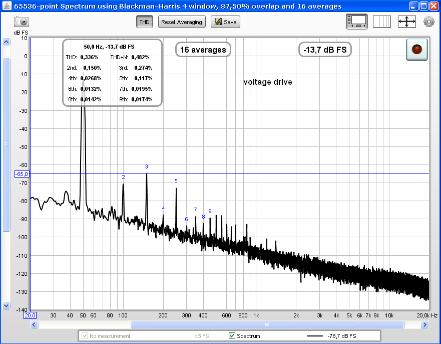

Yes, I am sure.Are you sure it wasn't your amp having to swing twice the volts ?
Nice demo 🙂
Thank you Pavel. I have been very busy working with new people doing product designs and haven't spent much time on my speakers. I will see what I can do to get some of this out there. I could send the speakers by regular post and it just takes a bit longer to get there. I would need to assemble and break in a pair for proper testing.
Exactly, at acoustical side it looks quite opposite..The same speaker, voltage driven and through series resistor, to the same SPL
I will repeat your experiment tomorrow, just curious what I get with microphone.
I have had this, so far, with microphone, at 200Hz. About twice more distortion at 100Hz. Only voltage drive measured so far with microphone. Too much noise.

I have been too curious. I have made measurements at 3 frequencies, 50Hz, 100Hz and 4kHz. Voltage drive and drive with 6R8 series resistor. I am sorry I cannot confirm your result. At 50 and 100Hz, the distortion was almost same with voltage drive and resistor. At 4kHz, resistor drive was better.
This is all you need to do to significantly reduce driver output distortion; Any high nfb (VFB) power amp can be modified easily for this configuration and tested with your own speaker of choice (I published this decades ago):
An Rs of .2-.5 works well.
