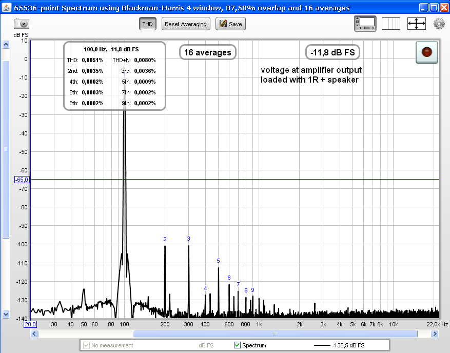

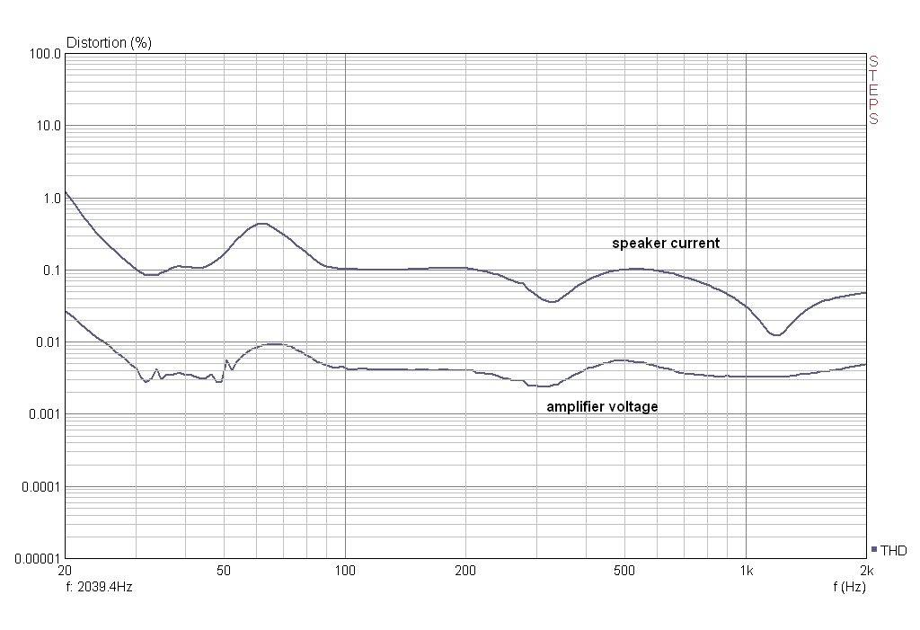

I understand that the so called "back emf" was a very big issue in the era of tube amplifiers, as demonstrated in articles from the fifties of the past century that George has linked here.
Now it is not. Distortion of speaker current is in orders higher than that of amplifier voltage. And non-flat distortion at amplifier output voltage reflects the fact that my amp has 0.25 ohm output impedance and no global feedback.
Interesting is also a frequency dependence of individual speaker current harmonics.

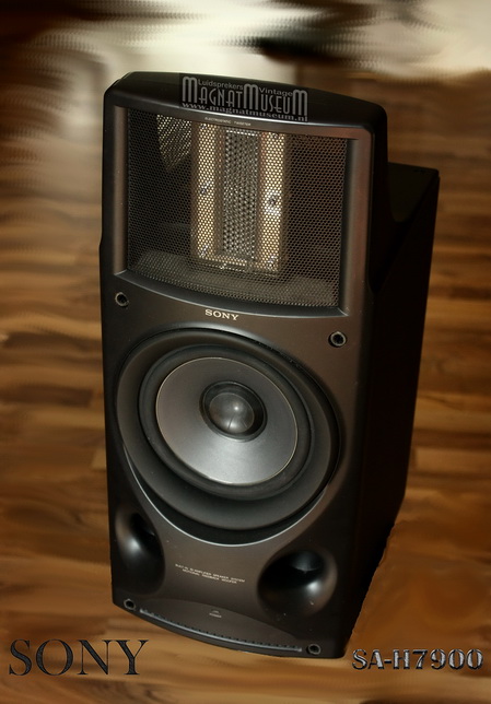

I have a pair of these Sony SA-H7900
MFB woofer via secondary voice coil and ES tweeter.
The bass is unusually extended for an 8'', and sounding clean, clear and 'solid', without the usual resonance signature of a ported box.
With some tweaking they would make really good B system boxes, and being active all that is needed to drive them is an iPod.

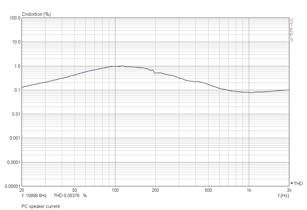

And we're looking at ... ? 🙂

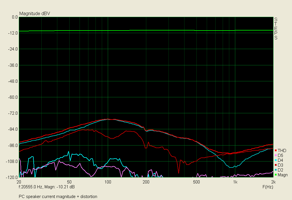

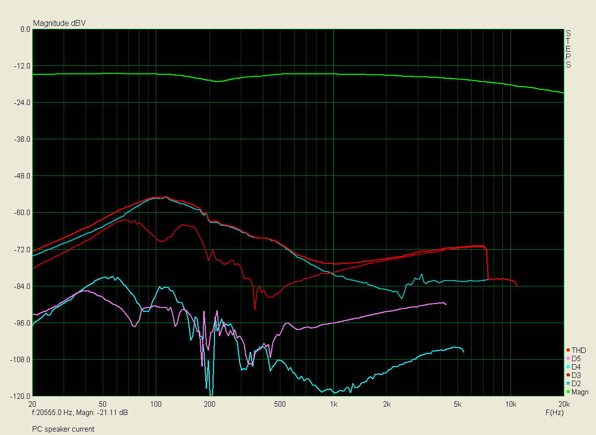

Unless I'm missing something totally obvious, that looks pretty good - I read it as better than 60dB down distortion everywhere, which is the ball park figure for speakers, as a species ...
My bad Frank, sorry, wrong plot. It was a voltage plot with wrong label. Correct plots attached. However, it is not bad, regarding current distortion, measured at 1.4Vrms, which is a lot for this small one. But the sound is distorted horribly - plastic box resonances etc. You would not believe, that PC speaker is a tough load, especially for small amplifiers - it has Re = 3.6 ohm only. Pretty low impedance for some pocket audio. But no sudden dips and peaks.

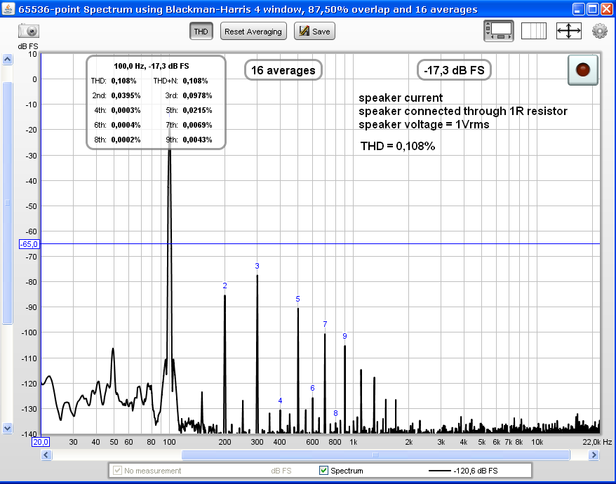

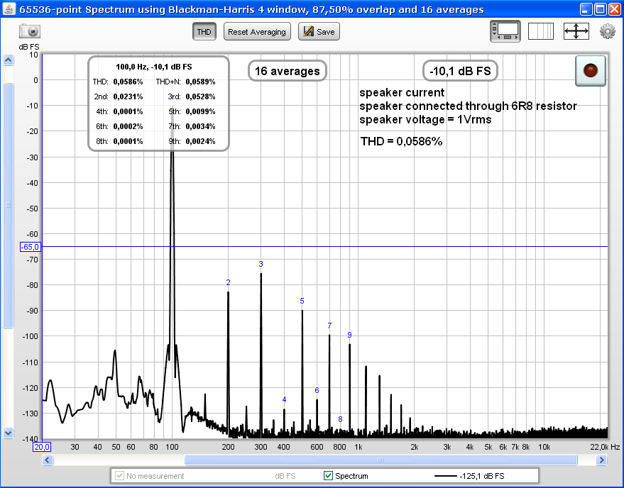

speaker distortion is lower with current drive
This measurement shows that speaker current distortion decreased to almost one half when the speaker was driven from 6.8 ohm series resistor, compared to 1 ohm series resistor. In both cases, voltage at speaker terminals (behind the resistor) was 1Vrms. This is a proof that current drive generates less distortion in speaker current than voltage drive. So, a "wire with gain" is not the best solution re resulting distortion at acoustical side.
