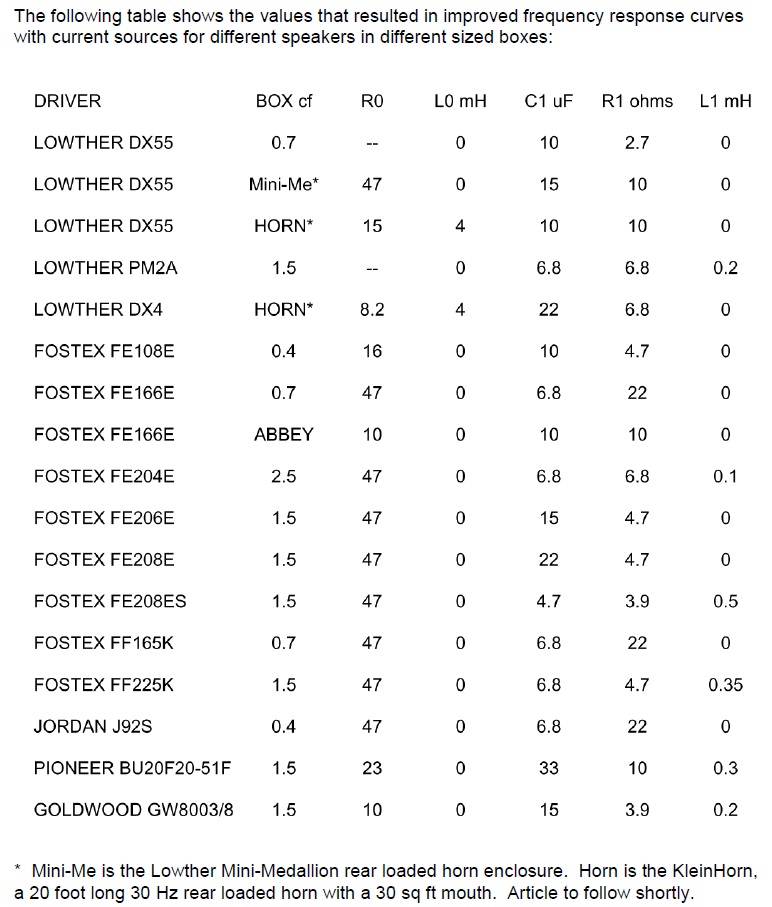

Actually I remember Thorsten recommending a low Qms woofer because once you go current drive it "nullifies" Qes and all that's left is the mechanical damping of the woofer.
Someone mention ported/sealed vs restrictive flow, and again I recall T saying that because drivers are designed for voltage drive I probably won't be able to find a woofer with really low Qms and I could use restrictive flow to increase the mechanical resistance and lower the Qms. He suggested many drill holes in the back of the cab with some "restriction" applied: cloth, fiberglass, etc ... The process was to add more restriction until it is critically damped (1.0 - 0.7 - 0.6).
Finally, again I recall T advising that I could use the freq resp aberrations of current drive to extend woofer response. Most big pro woofers have an fs=40 ish Hz.
If you add a bit of 'electrical' resistance in parallel, you can control the peaking (fr 'shaping') a la Nelson: ...
This was originally Mills/Hawksford's point. Nelson first made me aware of their work. The current drive thing keeps getting rediscovered, then disappears- to John's point, it would be best used with drivers designed for it rather than trying to force the square peg of voltage drive speakers into the round hole of current drive.

Oldies and goodies
Circa 1930 Voigt and Lowther were doing this.
Thornsten was also mentioning Eckmiller http://www.diyaudio.com/forums/lounge/200865-sound-quality-vs-measurements-482.html#post3002630
Addition of acoustic resistance and restricted back volume for speaker acoustical damping (Ted Jordan 1956):
http://www.ejjordan.co.uk/PDFs/A-Cabinet-of-Reduced-Size-with-Better-Low-Frequency-Performance.pdf
