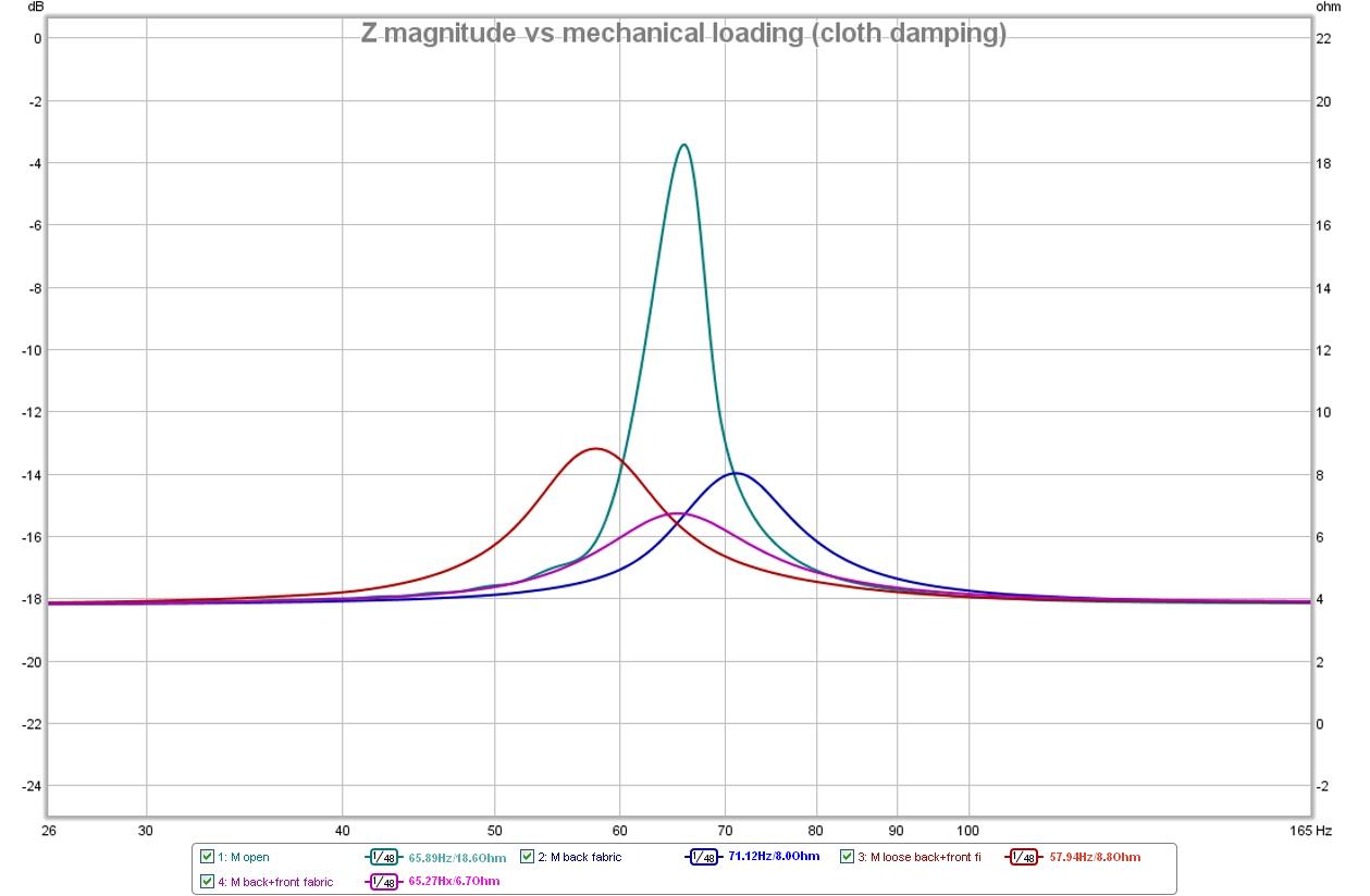

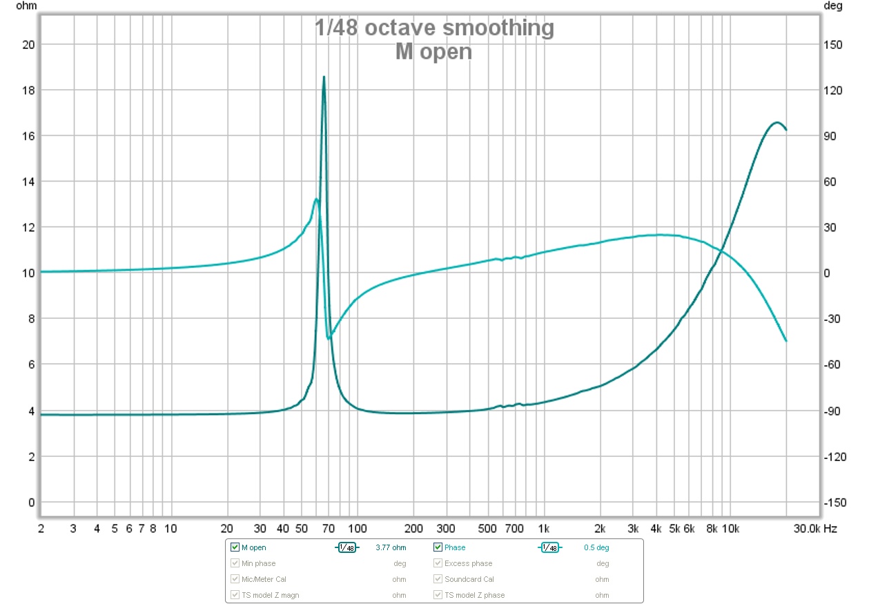

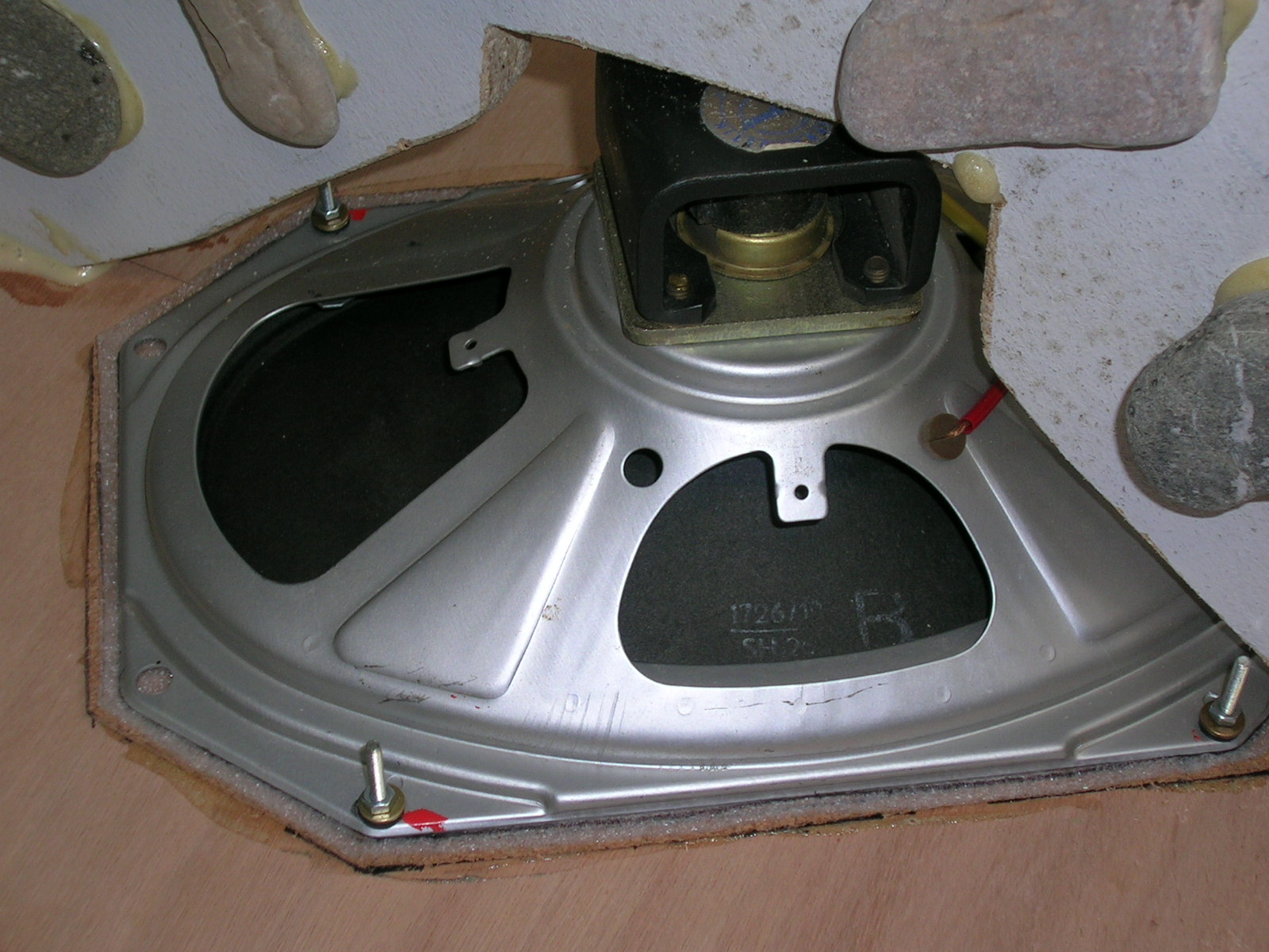

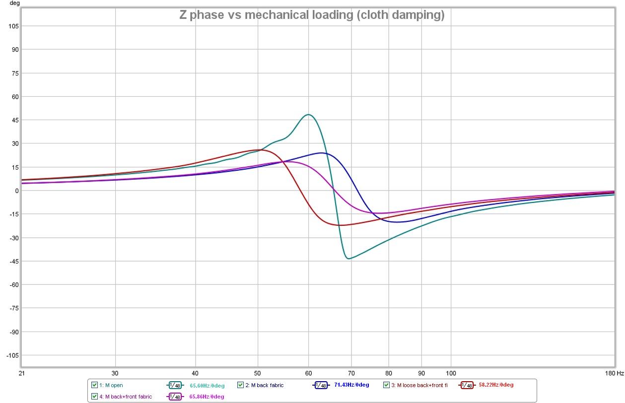

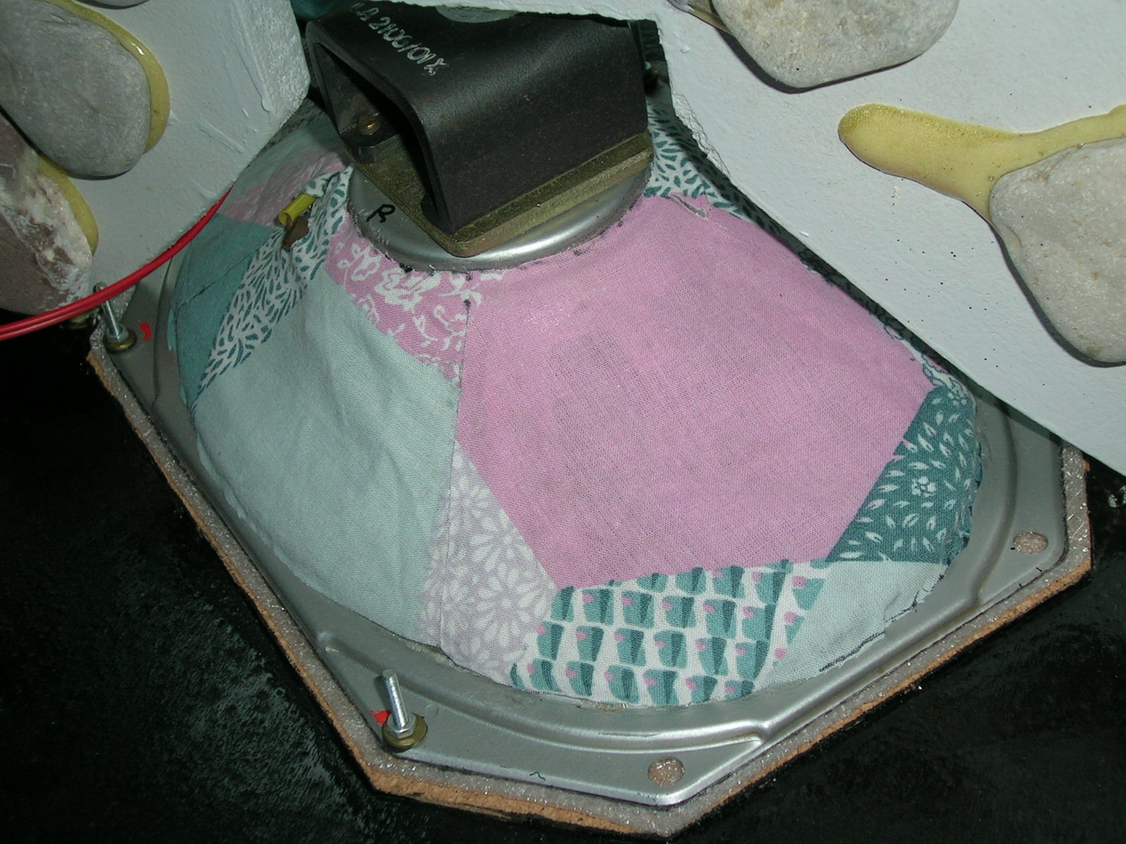

Driver’s main resonance can be tamed quite effectively –at least with some drivers- by the simple old ‘trick’ (*) of covering the basket with a cloth
Today, I understand, with the help of others, that isolating the OPS from the internal gain stages is a part of this same issue
Richard
Can you provide a link to the thread that this is discussed?
George
(*) It has been analyzed by R. Small

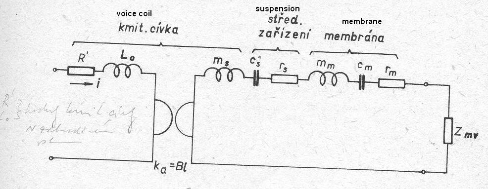

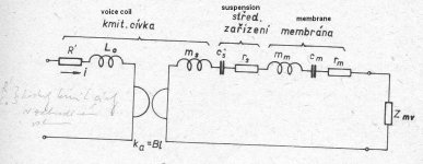

Funny to see amplifier guys talk about speakers.. 🙂
I am an "amplifier guy" graduated in electro-acoustics 🙂. So, the fact that speaker lumped element model (with almost all elements non-linear) is driven by current is no news.

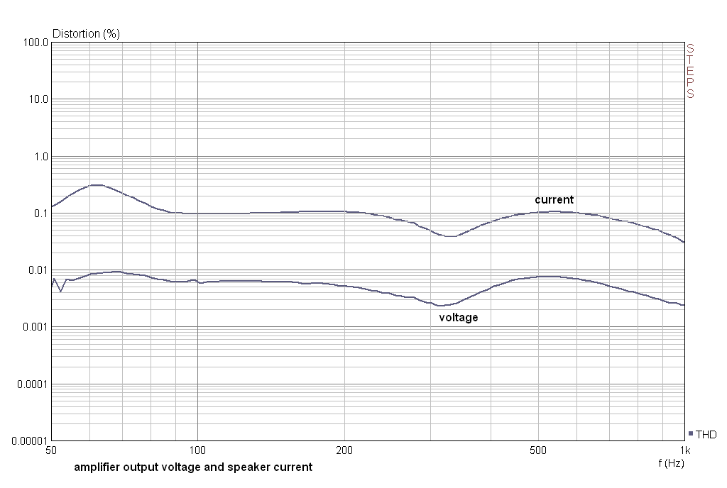

Re 1 ohm "isolation" - it makes almost no difference. One more measurement, amplifier output voltage and speaker current. This time, for output voltage measurement, speaker was connected directly to amplifier terminals, without 1 ohm resistor. Speaker current was measured through 1 oh resistor again. We can see again that current distortion is about 20x higher than voltage distortion = result of nonlinear speaker impedance.

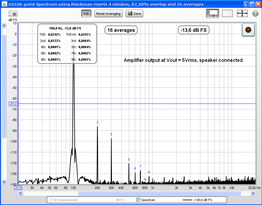

Probably my last measurement on this topic. Now at 5Vrms amplifier output voltage. Both spectral measurements were equalized to almost same level of fundamental harmonic component, within 0.1dB. Direct comparison is possible now.
First number is for voltage distortion, second for current distortion.
THD 0.024% 0.188% (7.8 x more)
2nd 0.023% 0.163% (7 x more)
3rd 0.006% 0.09% (15 x more)
7th 0.0002% 0.0037% (18.5x more)
