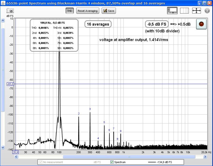

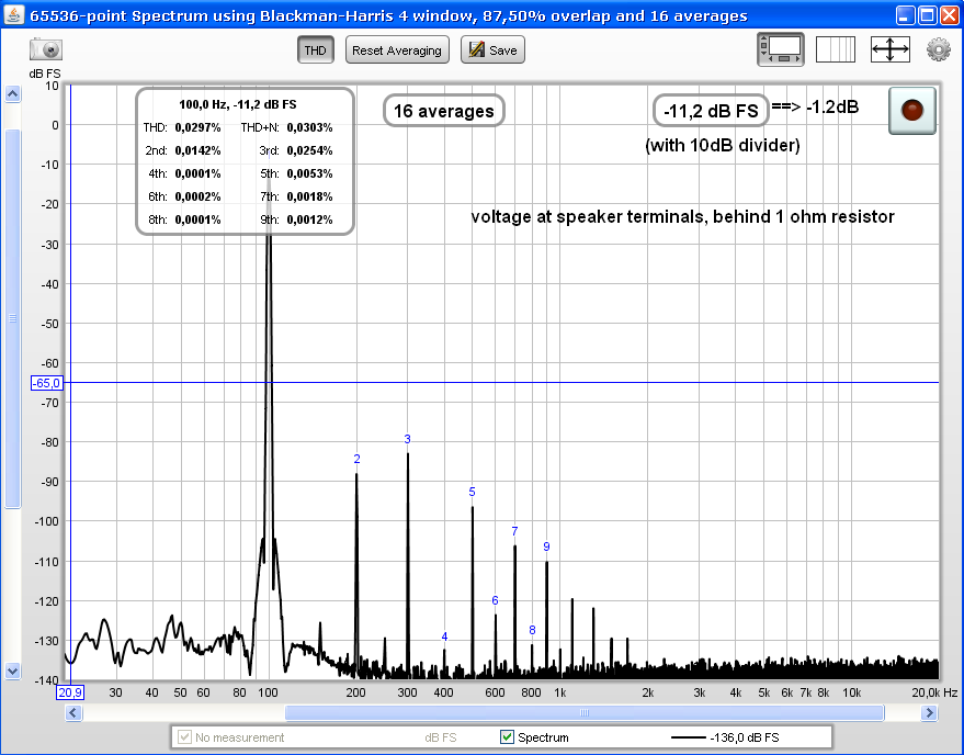

I have one more set of measurements with the same method. Now it is at 100Hz and a speaker with 2 parallel 8" woofers. The difference in distortion of voltage at amplifier output compared to speaker current distortion is even bigger than in the test at the 1kHz midrange frequency.
One can see that woofers are creating high order distortion mostly at odd harmonics, up to 17th.

Note: It was a clue that the distortion with speaker cable was low at amp and high at driver... end of cable.
This is not necessarily so, there is potential to get very confused here. You can't measure only voltage at one end and current at the other. You could just as well have the same non-linear current with an ideal voltage amplifier connected directly to the speaker the cable doing in effect nothing.

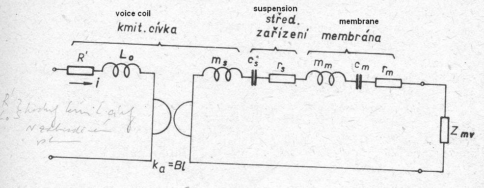

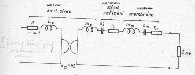

Just to show, for those who are not aware, why current defines speaker distortion, pls see the attachment.

The amplifier output voltage reflects "back EMF" as well. Speaker current is distorted because almost all elements of the speaker lumped diagram are non-linear. Voice coil Le is nonlinear, stiffness is nonlinear, cone has break-ups, B is nonlinear with voice coil position, almost everything you point at is nonlinear. Perfectly linear voltage divided by nonlinear impedance will produce nothing but nonlinear current, there is no option. The only cure would be a current drive with frequency response equalization. The last is not easy near to driver resonance.

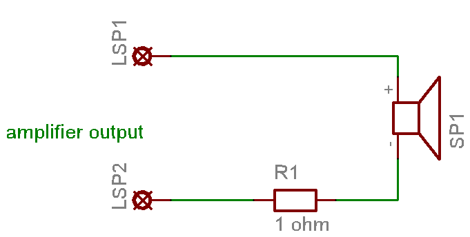

If amplifier output voltage had the same nonlinearity as speaker impedance, then speaker current would be undistorted. Crazy 🙂. But unrealistic.
Just to get this straight: speaker driver, feed its terminals perfect voltage drive at 1kHz, say; measure acoustic output spectrum, and RMS current; now, switch to perfect current drive, at that RMS value, and measure acoustic output - what would we see?
I hoped it was clear 🙂. Speaker is defined by current (B*L*i). Undistorted amplifier output voltage does not help. You need to feed the speaker with undistorted current. When driven with undistorted voltage, speaker will distort the current through its nonlinear impedance. Is it so much to ask knowledge of Ohm law? If yes, the debate is useless.
Current output is not the same as voltage output. Normal power amplifier has voltage output, close to zero output impedance and thus there is no way to prevent speaker current distortion.

Hmmmmm. When you put 1 Ohm in series the measured distortion increased. Non-linear speaker Z.
As far as I am concerned.... this is similar to a cable placed in series... though less complex.
It isnt theory -- it is measurement that I refer to. Low distortion at the amp terminals and higher at the speaker terminals with zip cord in between terminals.
