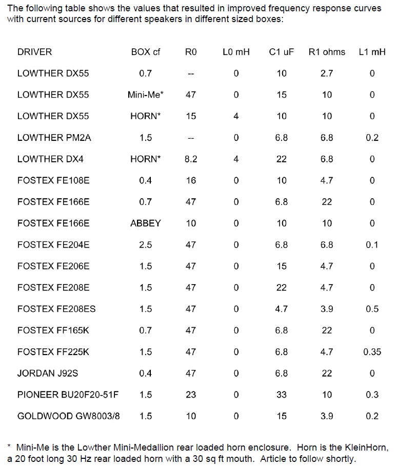

JN, we both agree on this. Non-linear with respect both to amplitude and frequency. Non-linear with more than one parameter.
So, how do parallel RC and RLC networks influence ?.
My ears tell me reduction in perceived distortion.
IME, these networks need to be incorporated directly at the driver connections or they don't work properly.
If applied remotely they can in some respects worsen the perceived distortions.

Hmmmm, I have fine compensated drivers (woofers and tweeters) to dead flat impedance out to 40kHz+.That's fine. A partial cure for bass bump or impedance equalization.
The subjective results were very agreeable.
