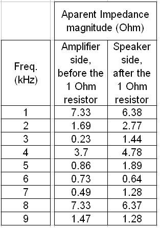

Amplifier voltage is -9.4dB + 10dB = +0.6dB
Speaker voltage is -10.6dB + 10dB = -0.6dB
Speaker current (voltage at 1 ohm) is -16.7dB + nothing
This means that for voltage spectrums the 0dB is 1.3196V and for current spectrum 0dB is 0.4173A
The estimation of the impedance using the harmonic peaks from these FFTs wasn’t that fruitful!
I would say that, since voltage and current pick-up weren't done simultaneously, phase relation was random, so R=V/I doesn’t really hold.
Thanks again for your work.
George
