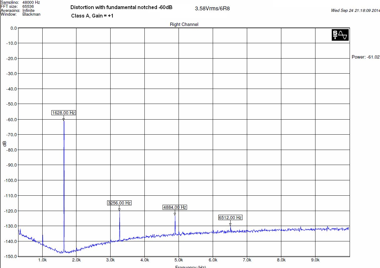

Frank, I have been doing similar tests for several years. Few years ago I started with class AB amplifiers with reasonably low distortion, but no phantastic numbers. Speaker distortion results were close to indistinguishable with 2 different AB amplifiers.
This last set was done with pure class A amplifier. It is tested with R, dummy load and speaker. I can measure distortion of this amplifier only with a notch filter method, the result is attached. When I try direct method, the amplifier distortion is lower than that of the measuring chain.
Sorry I am not going to provide you with tens plots, it is useless. Theories from a land of phantasy would always appear even if thousands of measurements were posted.
nonsense.
And this setup is an extremely low distortion preamp + class A unity gain stage with no global feedback.

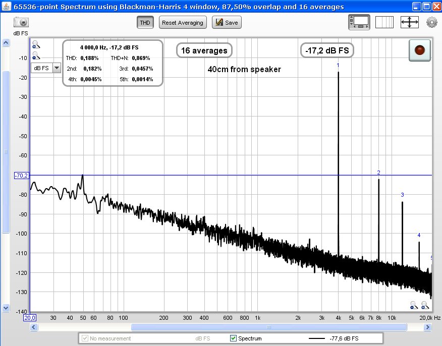

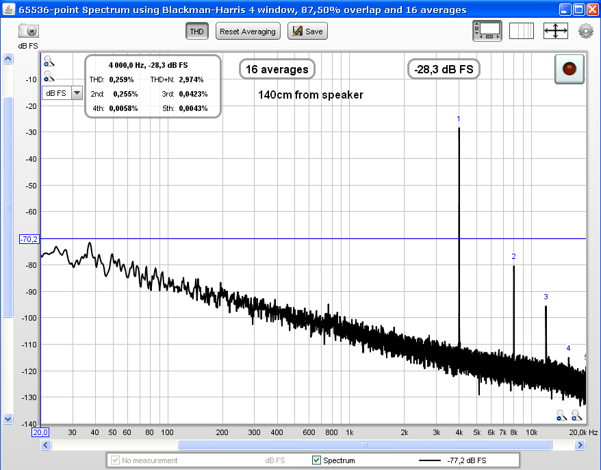

These 2 measurements are made at tweeter axis, same amplifier output voltage. Microphone position is 40cm and 140cm from tweeter. One can see 11dB difference in SPL. If the microphone added SPL related distortion, we would see higher distortion numbers for 40cm distance (higher SPL). Opposite is true, 40cm distortion numbers are lower (pls see top left corner of both plots), maybe more reflecftions in 150cm distance, or midrange contribution.
Klippel - I have seen down to 5th in some of his measurements.

It is very pleasing that you went to these efforts - I appreciate your exercise of varying the mic distance from the driver, to confirm that it was not subject to SPL related distortion.

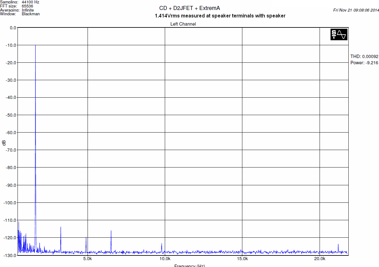

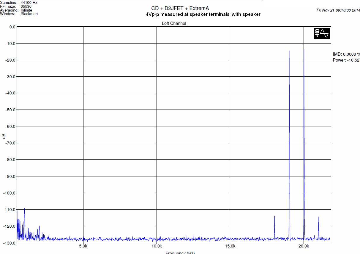

Frank, I have found my measurements at speaker terminals with speaker connected ...
Please take into account that there is an influence of the soundcard used to the result. Even with this influence, we can see that the distortion at speaker terminals with speaker connected is negligible (at least with amplifiers that I use) and absolutely negligible to what we see with acoustical measurement.
I agree with you that we are not much closer to explanation of sound differences, but at least I wanted to stop blaming all on amplifier crossover distortion etc. IMO harmonic distortion is NOT an explanation.
